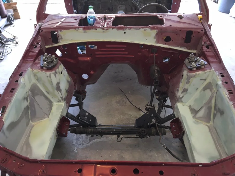

Oh Gawd.....I knew this day would come......I just can't believe it's here!.....this is real, isn't it? I finished with the bondo work on the engine bay!:rlaugh::jester::banana::banana::banana::banana::banana::jester::rlaugh:
Here's before and after pics. I'll post a picture after I primer it, hopefully tomorrow evening. I would do it tonight, but I left my masking machine at work and I DON'T have any relatives with butt loads of wrapping paper! @Boosted92LX
Notice how my emoji's balance out so well up there:lol:. Ok, pics:

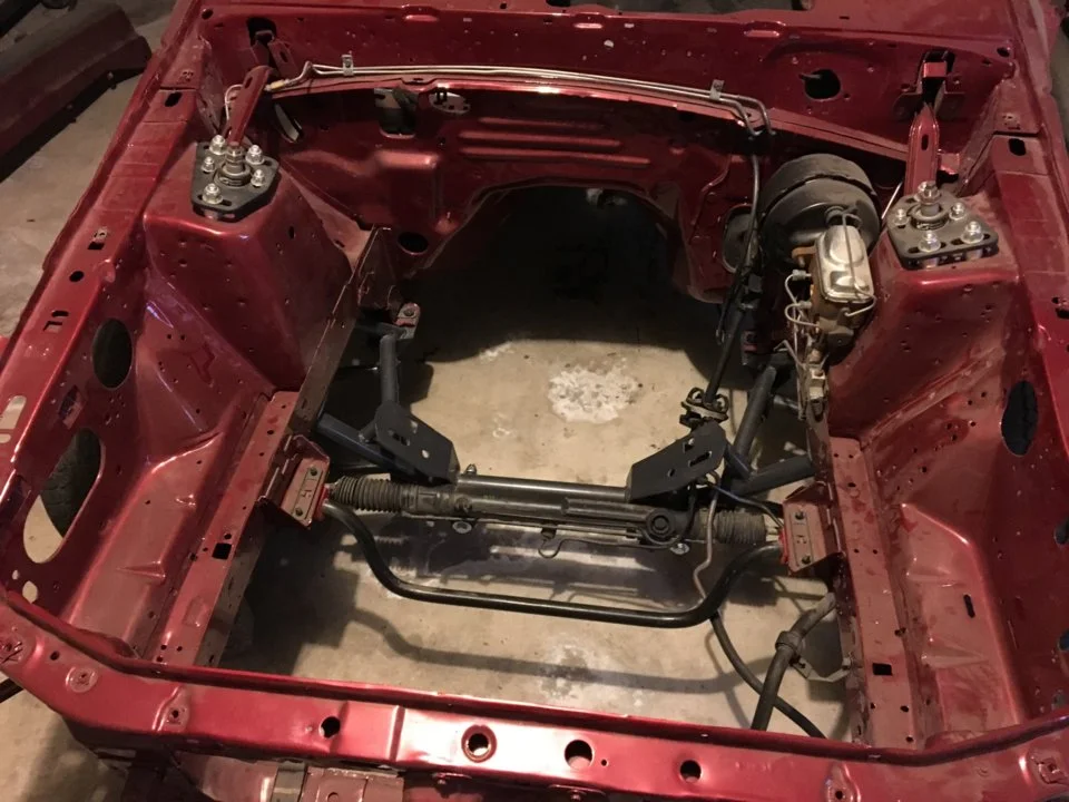

Before panels and bondo, I hate those ten thousand holes!:
After panels and bondo and ALL that work, maybe those little freakin' holes would've been ok:
Yes, I'm glad I did it. Few things I would've avoided or done differently in the process though. I do like the Scott Rod Fab panels too.

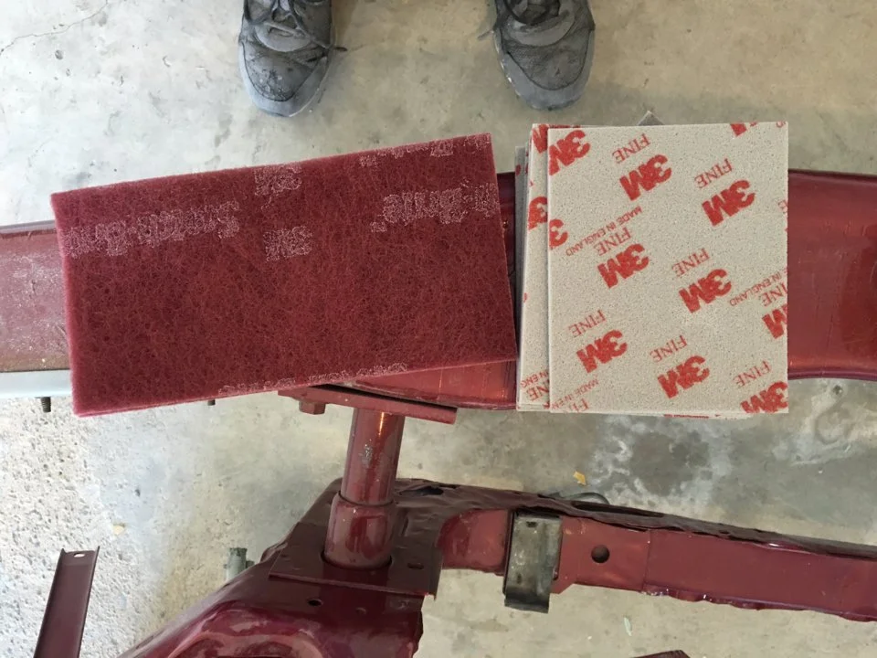

I used the grey 3M fine pads in the next picture for the edge sanding and getting into crevices. They are roughly 180-240 grit, super for primer adhesion. The red scotchbrites photo bombed the sanding foam pads, didn't use them at all... they're jealous and I don't think they are really good enough for proper adhesion of primer.
