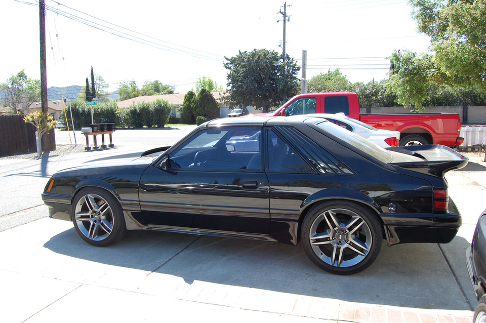

Only picture I could find of somebody trying 19" wheels off a Coyote 5.0 that they put on their Fox.
Reactions: Davedacarpainter
Admin Dude
Jan 4, 1985
43,161
21,335
Box behind Walmart
Apr 22, 2016
#1,355
  • Apr 22, 2016
  • #1,355
Still not my favorite but doesn't look bad. I guess I like a little more fat on the bottom.

A5literMan said:
But I do like the 18/19 stagger. Looks good to me. I think a 17/18 would look better though(or just 18's)
The guy that owned that car said that he had lots of rubbing up front and would prefer a smaller wheel up front too. I like performance and ride comfort so having some meat on rims is a must which would be nearly impossible with a 19" rim unless you jack up your car 4x4 style
Reactions: A5literMan and Davedacarpainter
That's a four eye. I think I like the size of the wheels more than the ground effects kit on it.
I guess it will depend on wheel selection a bit as well.
