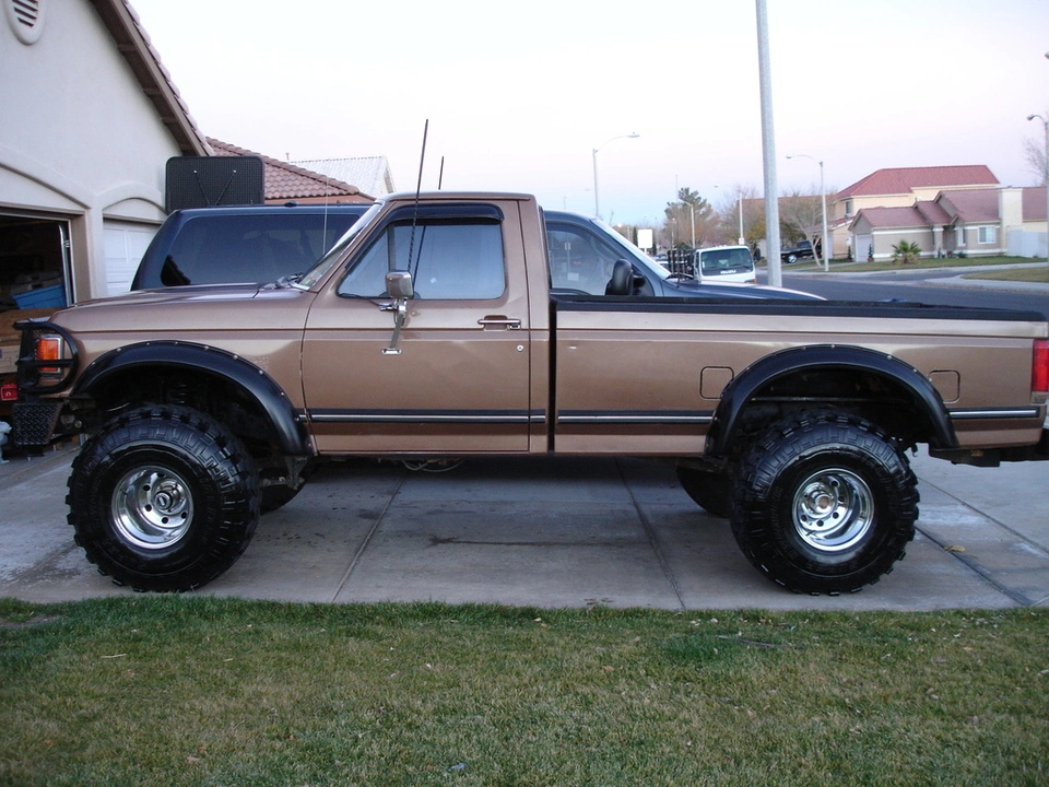

heres how i financed my build, i sold my other baby....

thanks, it was either sell the stang and build the stroker for my truck and put 1 ton axles in it or sell the truck and build the stroker for the stang. needless to say the stang won, i was always to afraid to really wheel much with the truck because i didnt ever want to mess it up, so i passed it on to someone else. too many toys and not enough money
