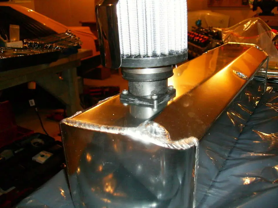

Here are the VC's after I put in the comp cams breather neck. I thin the part # was like VH1 or something. It had bolts that went through the top into a bottom piece inside the VC so I used that to make a baffle. It was pointless not having a baffle.
