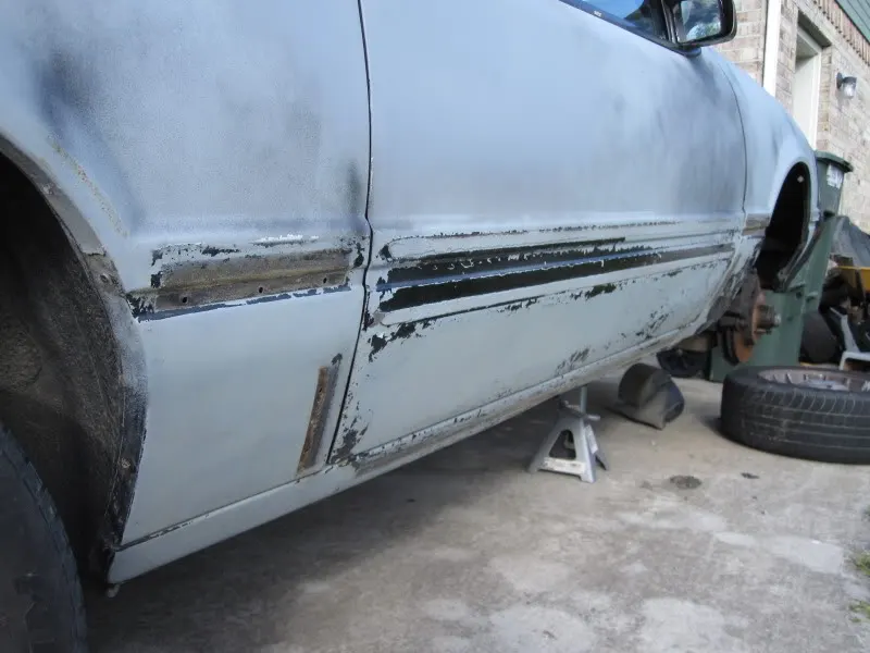

Finally got to work removing the GT brackets...Anyone have a recomendation on how to fill the holes??? I figured just weld them

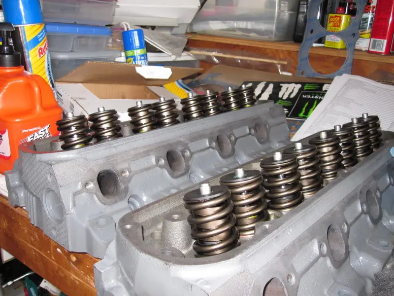

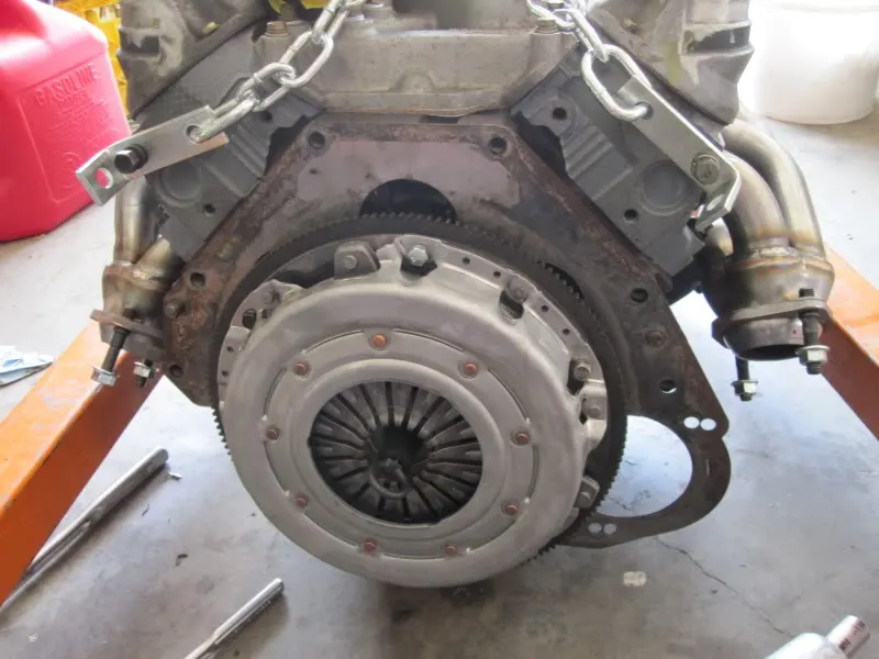

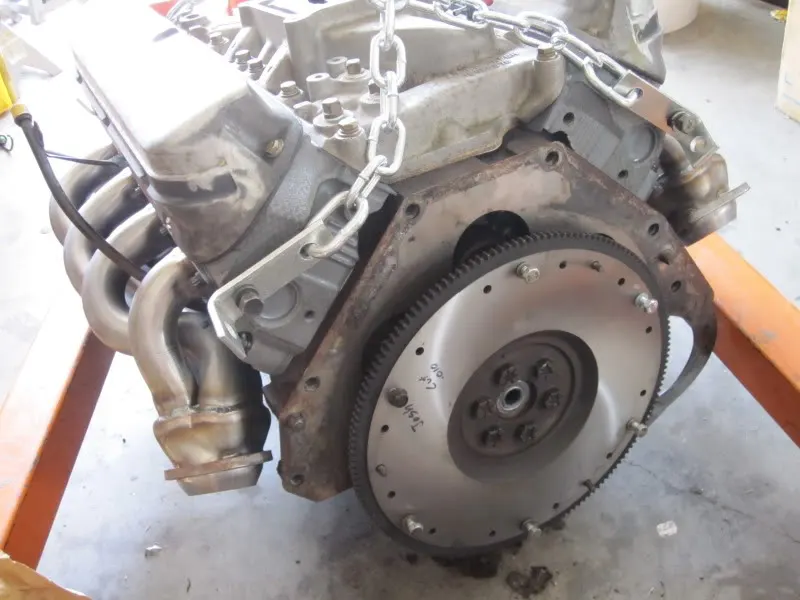

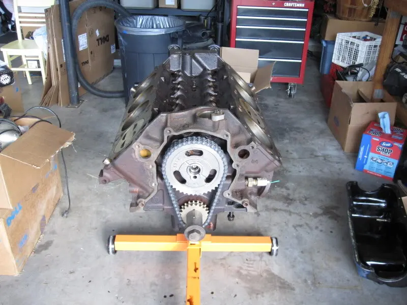

Also got started on putting the engine together, that came to a stand still real quick when I noticed Im missing the cam dowel pin and one of the head alignment dowels.
I did get the valve springs on though...

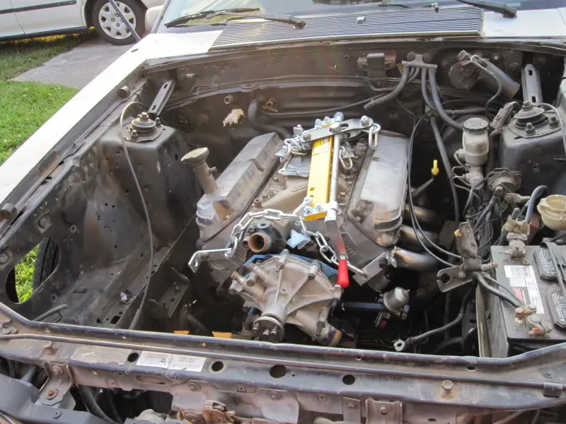

Well I forgot to document alot of the progress, but here's where I'm at now

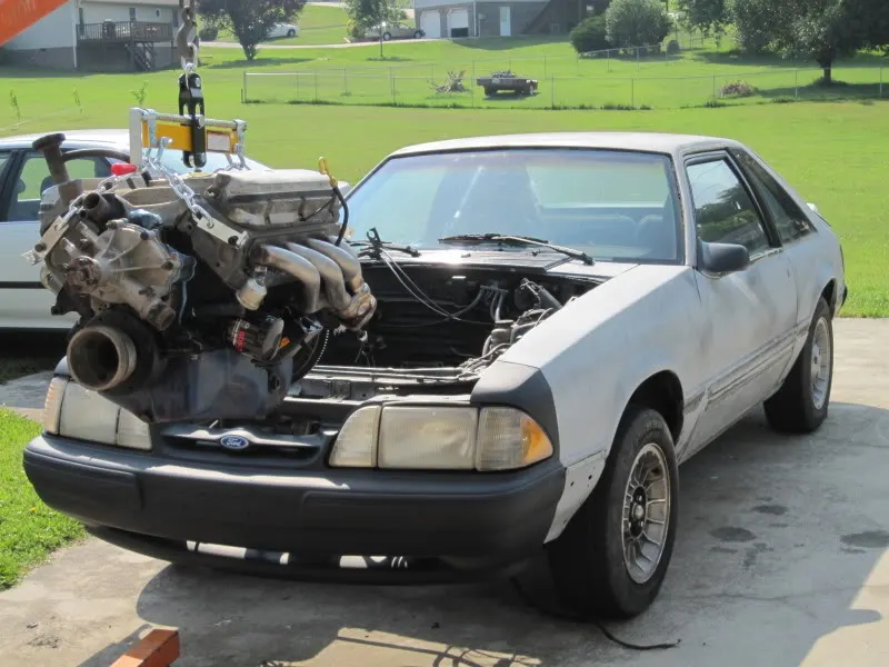

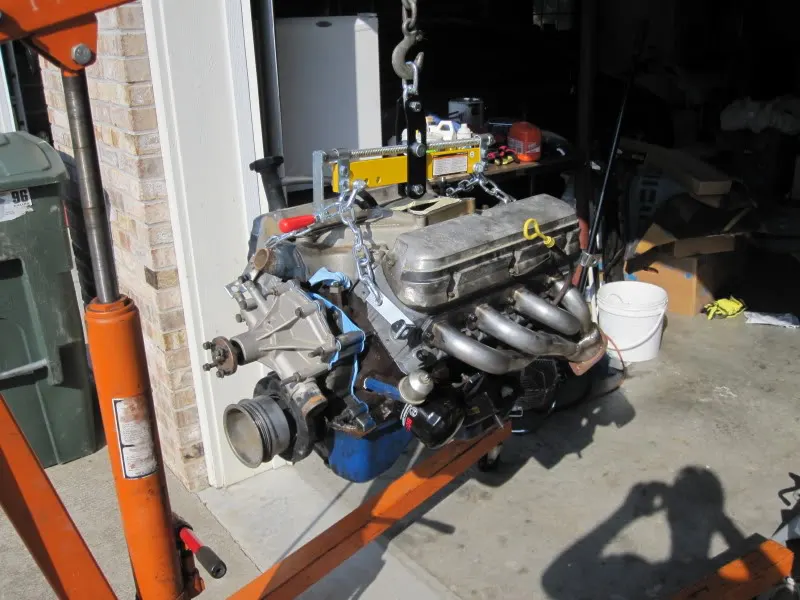

Pretty much all assembled

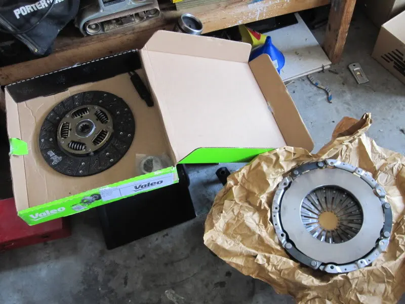

King Cobra clutch

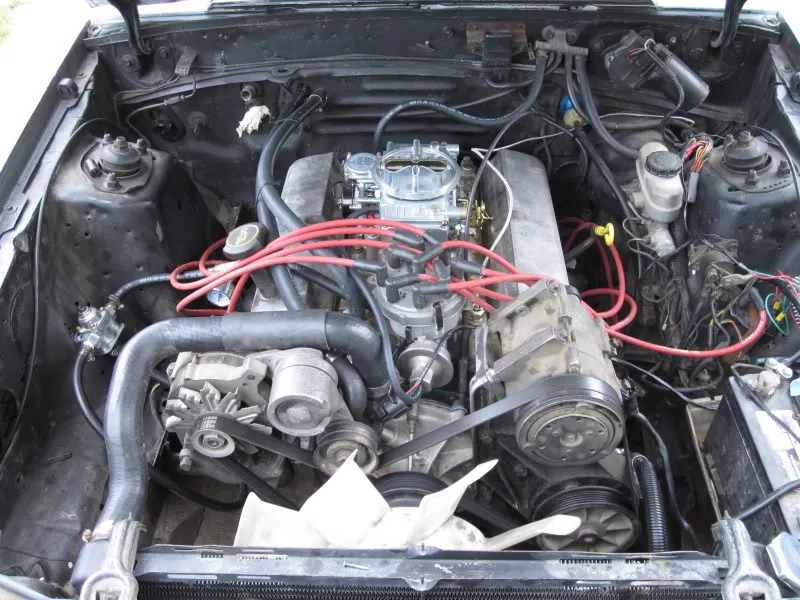

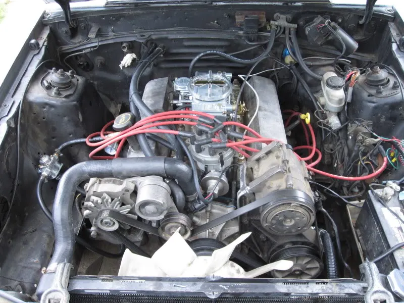

And I know Im going to catch hell for switching to carb, but I have my reasons, and its temporary for right now. It will be back to EFI one day when funds allow me to.
Looks great and nice work in the engine assembly. Did you do anything else to the motor or just strip it down to the block/rotating assembly and then put everything back together?
Very cool build and thanks for sharing... can't wait to see her run. :nice:
KHibbs
KHibbs...I stripped everything off of the old shortblock that I needed and resued on a new to me shortblock that was untouched

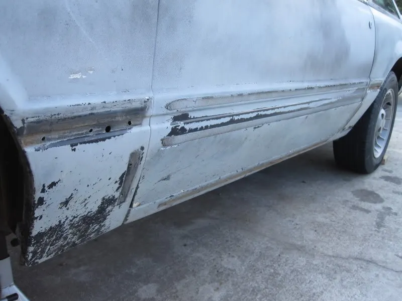

fivespeedsteed...Rustoleum flat black is in the "To Do" list I just havent found the time

... One FYI for ya. If you are going to give her a spray bomb primer job, use some type of automotive etching primer... (think duplicolor or equivalent). If you use rustoleum and later on, you or someone else wants to paint the car, all the rustoleum will have to be stripped.

Lookin good man, seems like you got a better deal the more you do to it. I've got no problem with carbs, it'll be nice when you can get the thing out on the road. The spray bomb paint job is hit or miss, but you aren't out much money if you don't like the way it comes out and one solid color always looks better than mismatched. This is stuff you already know of course and just like you my to-do list never ended so it's not like there's a rush. Keep up the good work :nice:
Well Its finally all together and running. I about sold it a couple times but I decided to finish it and I'm glad I did.

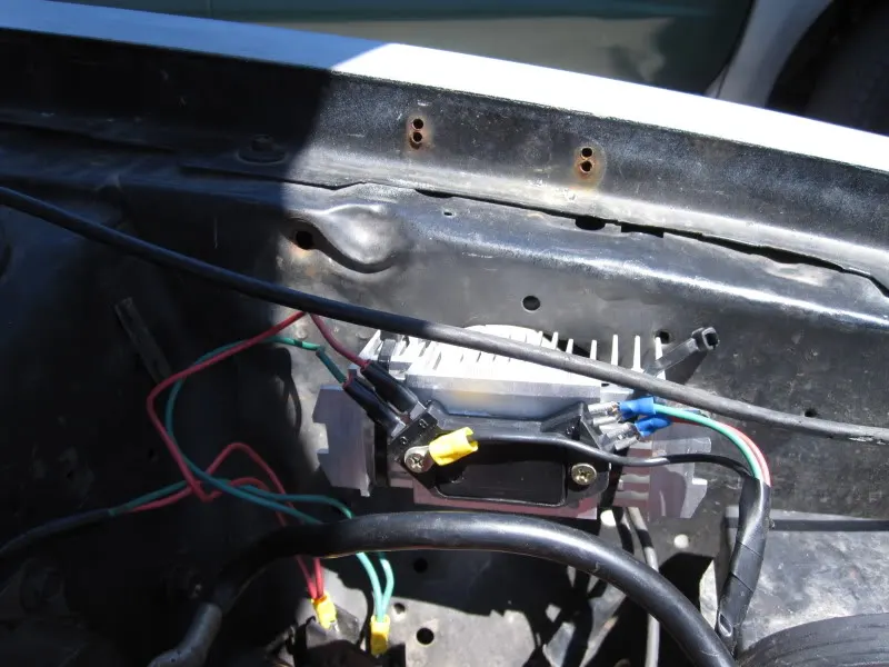

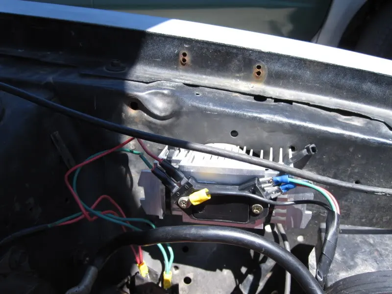

I rigged a GM HEI module to power my Duraspark II distributor, and it works great

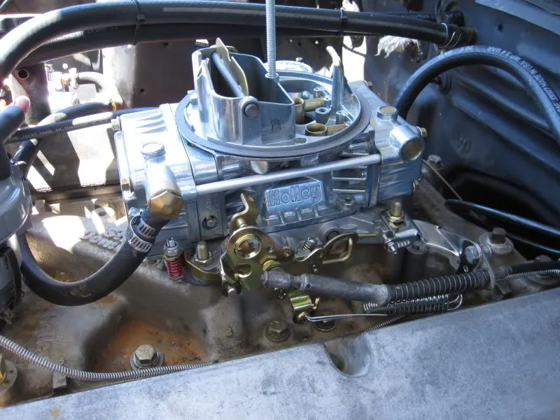

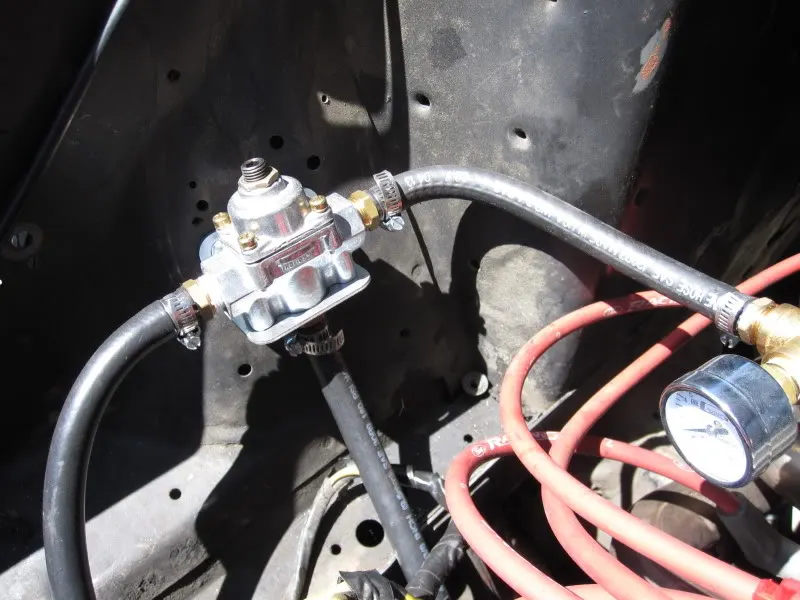

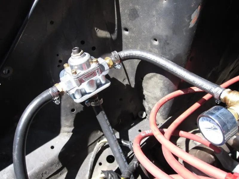

I used a Holley return fuel pressure regulator with the stock fuel pump, and it also works great

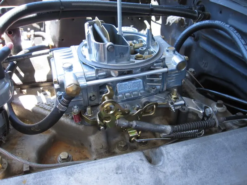

Im using a holley 4160 600 CFM and a lokar throttle cable bracket with the stock throttle cable...Im not a huge fan of using the stock cable, but its just temporary for right now
