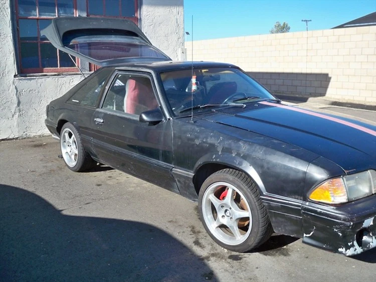

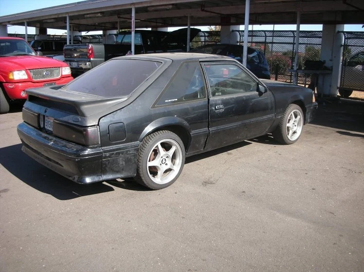

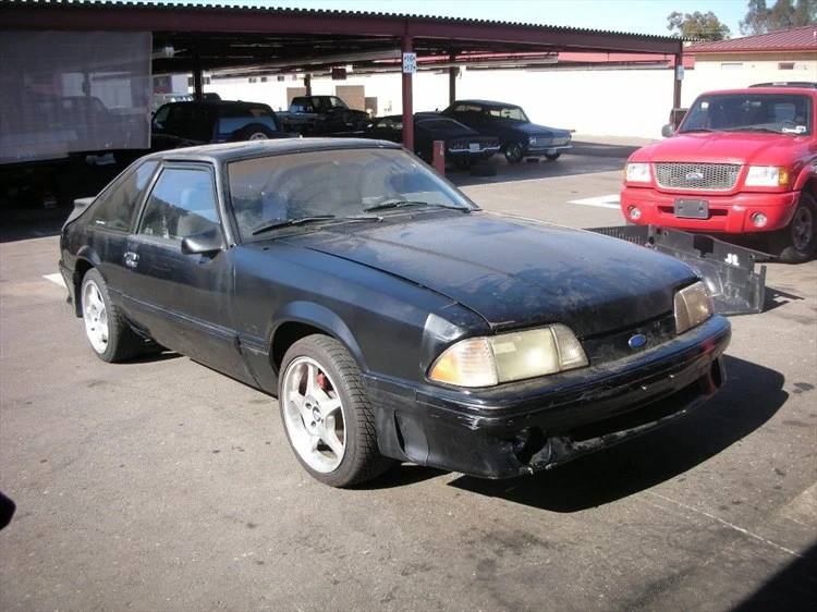

Hey everyone, I just thought i would post up a build thread of what exactly i am working on. I bought the car in January of 09, and a friend of mine wanted to buy it, so i sold it to him in April of 09. The day after he bought it, he blew it up racing it. He had the motor rebuilt, then blew the trans. He let the car sit for 9 months, with the windows down, ruining the interior. I bought the car back from him for $200 as it sat. I had to spend $300 bucks in back tags and taxes, and $250 in storage fees.

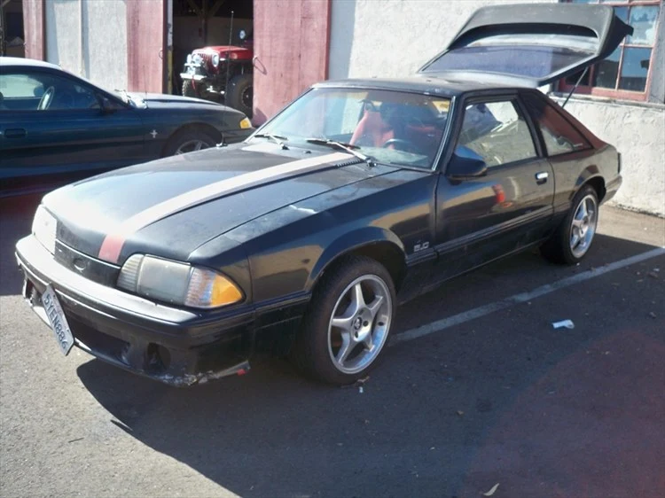

Here is the way the car looks as of last weekend when i picked it up. As you can see, its in rough shape.

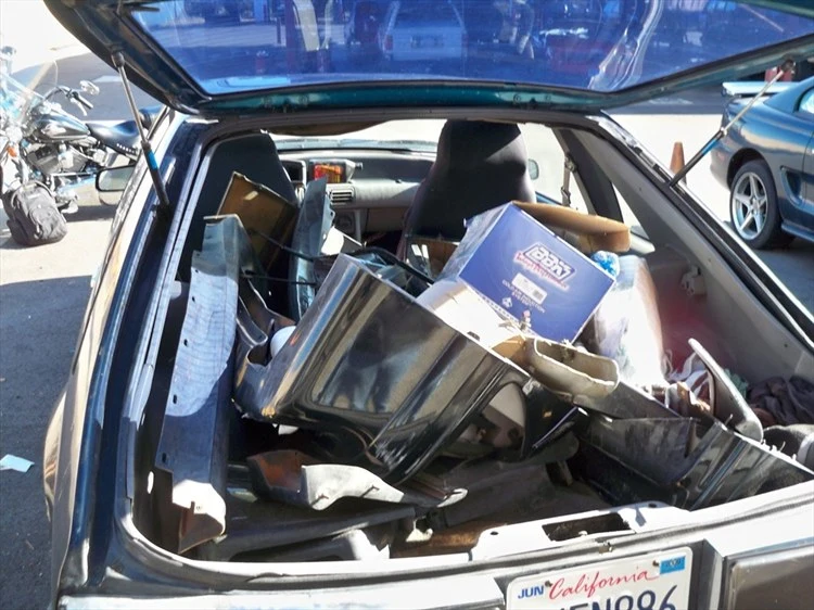

This is the GT body kit along with GOBS of trash.

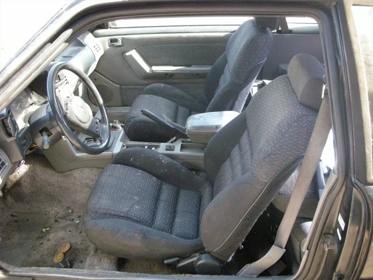

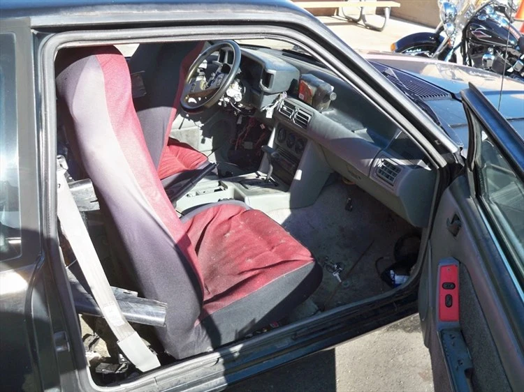

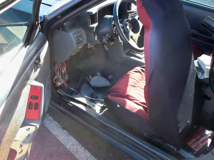

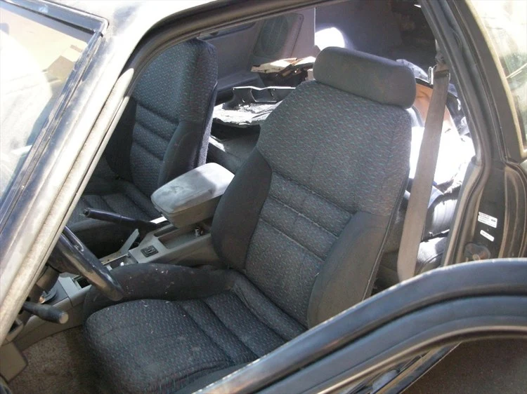

Here is the "lovely" interior. Yes, the steering column was torn apart in this picture. You can see the stains and grossness on the seats, and just how nasty the carpet is

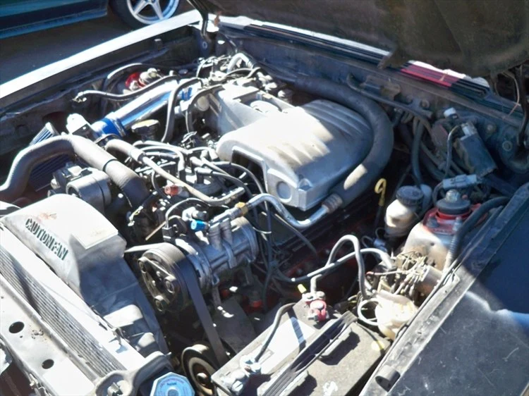

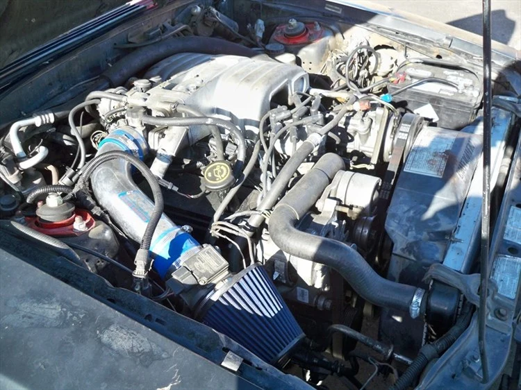

The motor is in pretty good shape considering the condition of the rest of the car. There are a few things wrong though. The battery is dead, the exhaust is a hackjob consisting of flex tube, Hedman long tubes, an X pipe from a 94 GT, and a catback system that belongs on the car.
I got a transmission from a 93 Thunderbird, and when i went to put it in, the shifter on the side of the transmission didn't work correctly with the mustang shifter linkage. The TV cable was readjusted for the car, and I got the batter charged and fired the car up. It will still shift into reverse, neutral and drive, but no other gears. I believe the governor in the rear of the transmission is dirty, because the car will not come out of 1st when it is in drive.

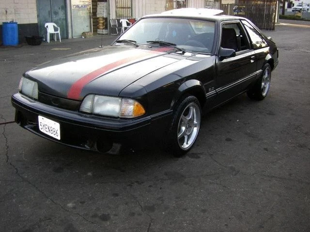

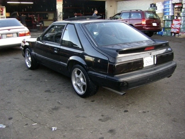

I got the parts of the GT kit on, and replaced the passenger side fender along with covering up that disgusting red stripe.
As you can see, the hood was sitting on top the fender. This was due to the inner fender well being damaged over its lifetime. I simply filed out the fender mounting holes a little bit and whala, hood closes. The hood latch is adjusted too far to the left, so i still need to move it overto the right about a 1/4"
Also forgot to mention that the exhaust mess is gone. I went back to the stock H-pipe and factory shorty manifolds. This will make it easy to pass smog and make working on the car easier. Not to mention it doesn't have a million exhaust leaks anymore.
