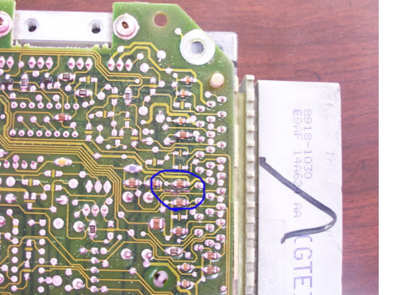

If you have a damaged computer with signal ground problems, see the pictures below for help finding and fixing the burnt computer trace.
The fix is some careful soldering of a small jumper wire across the burnt section of copper trace.

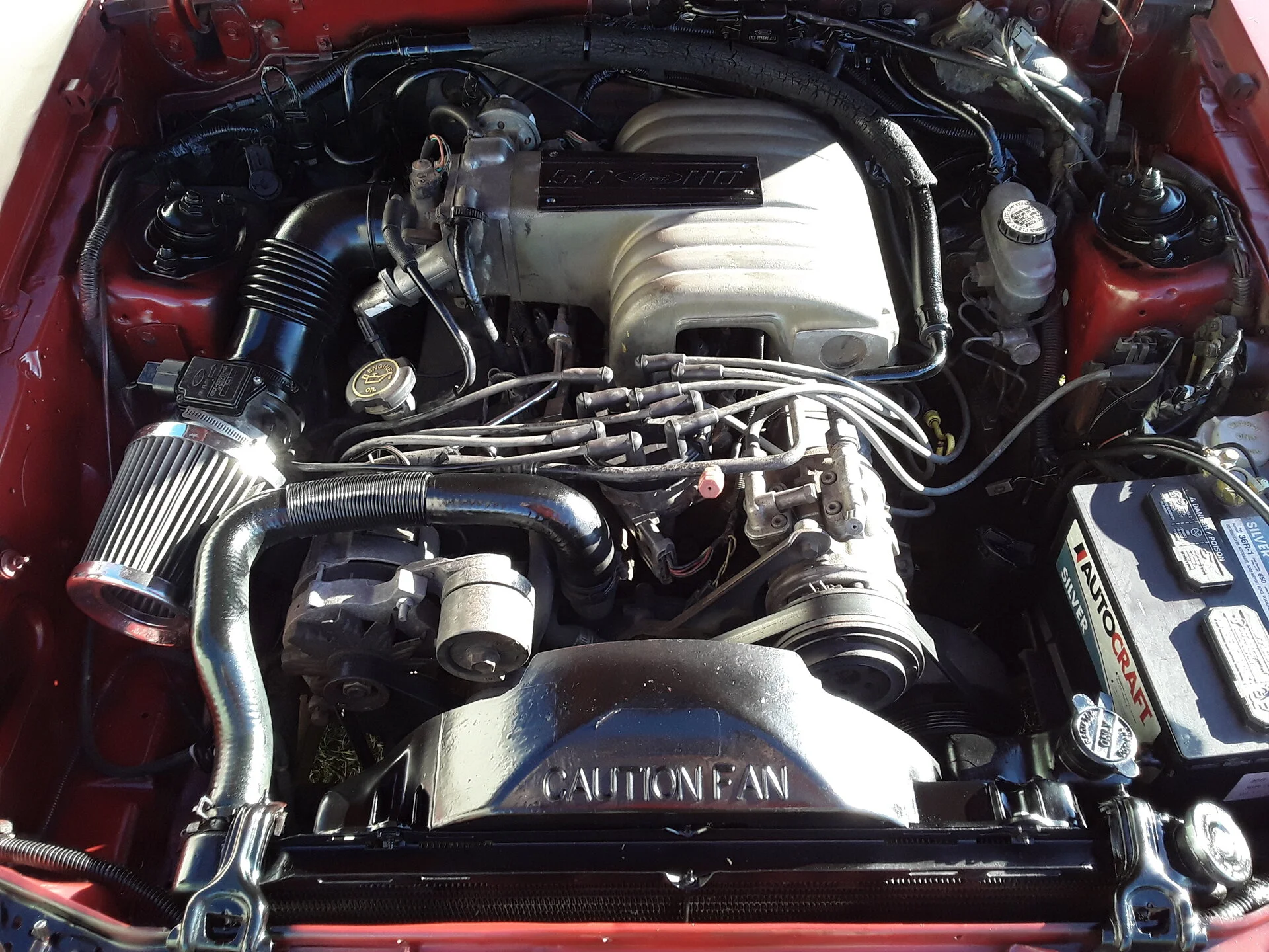

Car Kinda got worse each day now cant drive it too far at all without having to cut it off then recrank it .. then runs fine.. finally pulled codes.. got low tps (previous orwner fr drilled it out alot!!!...) and ACT or something 64 and 63 is what i got.. now i changed fuel filter earlier.. noticed brownish gas.. smh.. prob just need to dump tank put new gas in, and adjust tps and do a base idle reset.. only ptob is im poor, have no multi meter.. and it legit has almost a full tank (work on it daily almost and just drive it maybe 3 or 4 miles.. have had it since september 20th, only drive it back about 50 miles, and ive put like 130 miles on it since.. 50 since i last filled it..

Yeah google water in gasoline pics mine looks like that and here is a pic of what it is currently running lol also tps definitely needs to be messed with and a base idle reset for sure.. also maybe timing adjusted and then possibly going to pull wires and try the standard 137 fire order and pray this will fix my fox cuz if its the ecu like yall think... i know me, this thing is gonna sit under a tree, as i become one of those guys that got out smarted by the fox, and keep telling them kids its not for sell.. ill fix her one day.. lol when i goit the spout was missing (did not know at that time) and it came with a parts car.. been 3 months idk if i can go back and grab stuff now lol but first thing i grabbed was ecu and wire harness cuz i knew that be worth something.. paid guy drove 2 miles bucked and snatched but crunk up and did that till i finally got to a hwy and got up to 55mph.. did decent then still bucked and atched.. never touched tps but everyone fiddled withthat screw.. and fb group told me i didnt have a spout.. got it from other ecu.. so i swapped them out then saw no difference so swapped them back and sold it on ebay to a guy thay owns a foxbody shop lol he actually sent me videos back and forth and helped me with vac lines.. other than that i have drove it to the store back and forth and slowly narrowing down problems.. oh and it had like a half tank i think when i got car.. and was sitting in old guys garage for idk how long but gas prob wasnt the best.. filled it up on way back with medium gas 88 octane.. and dumped a fuel cleaner or 2 in it.. and i went 100 miles almost.. then filled it back up only took like 20 bucks.. and that was a month ago.. ive since became broke lol selling spare parts to buy this ponys love..
