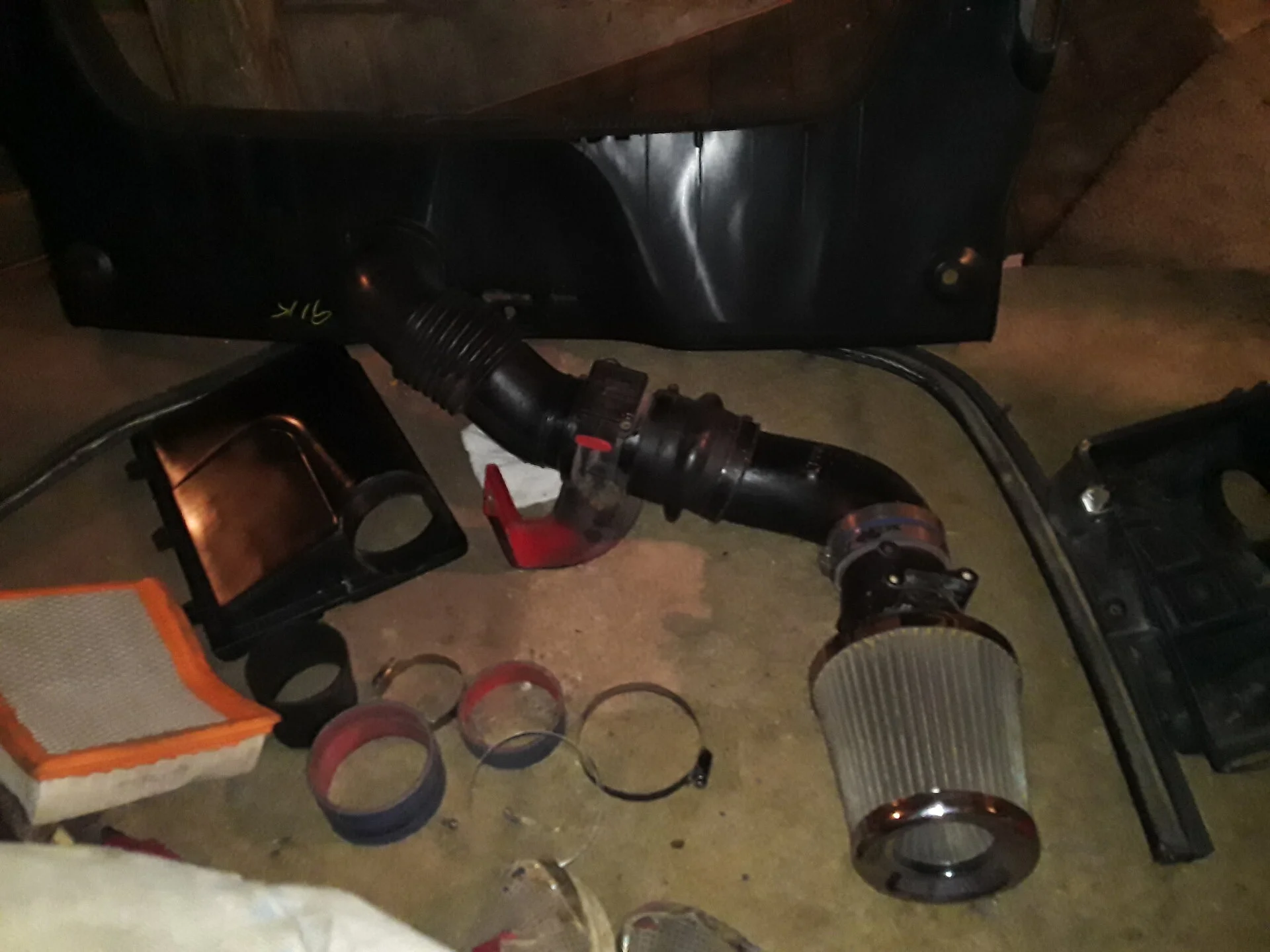

Update i played woth the air filter moved it to the fender and blocked off air.. it actually helped out alot.. i can actually drive the car without having to kill it 30 times... to my understanding its gettong too much air and the maf sensor (hot wires cleaned and mad senaor replaced ) is tripoing out.. basically it was an open oiled air filter thats been washed by me before and never oiled with no heat shield.. and the foxbodies air filter is closed box ram air inside the fender...

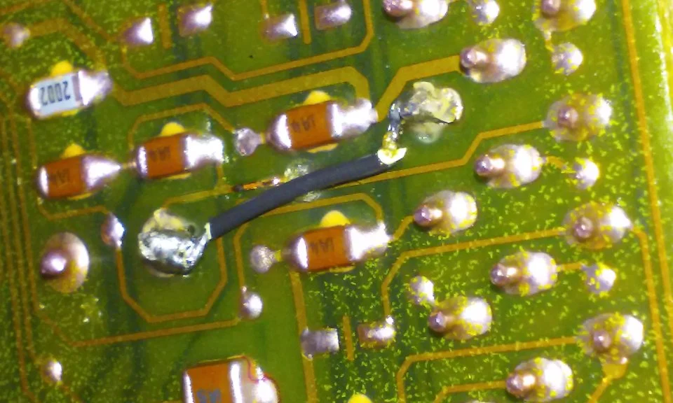

If you have a damaged computer with signal ground problems, see the pictures below for help finding and fixing the burnt computer trace.
The fix is some careful soldering of a small jumper wire across the burnt section of copper trace.
