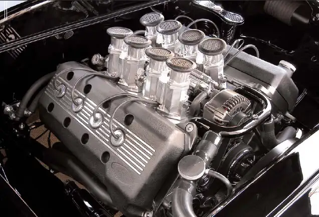

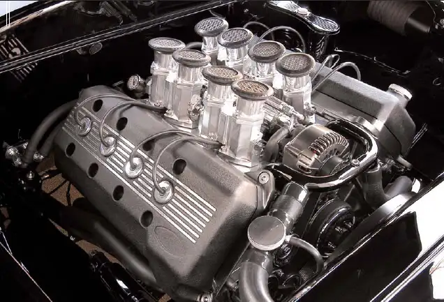

Use that Megasquirt and buy or build this...
Houston, we have a boner.

I have no idea how much that setup would be (the fuel injection one with 8 stacks). I know 69clark is planning on running it on his sick nasty pace car.

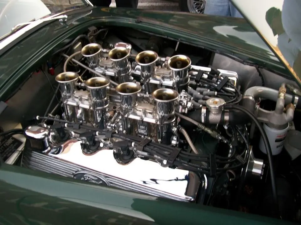

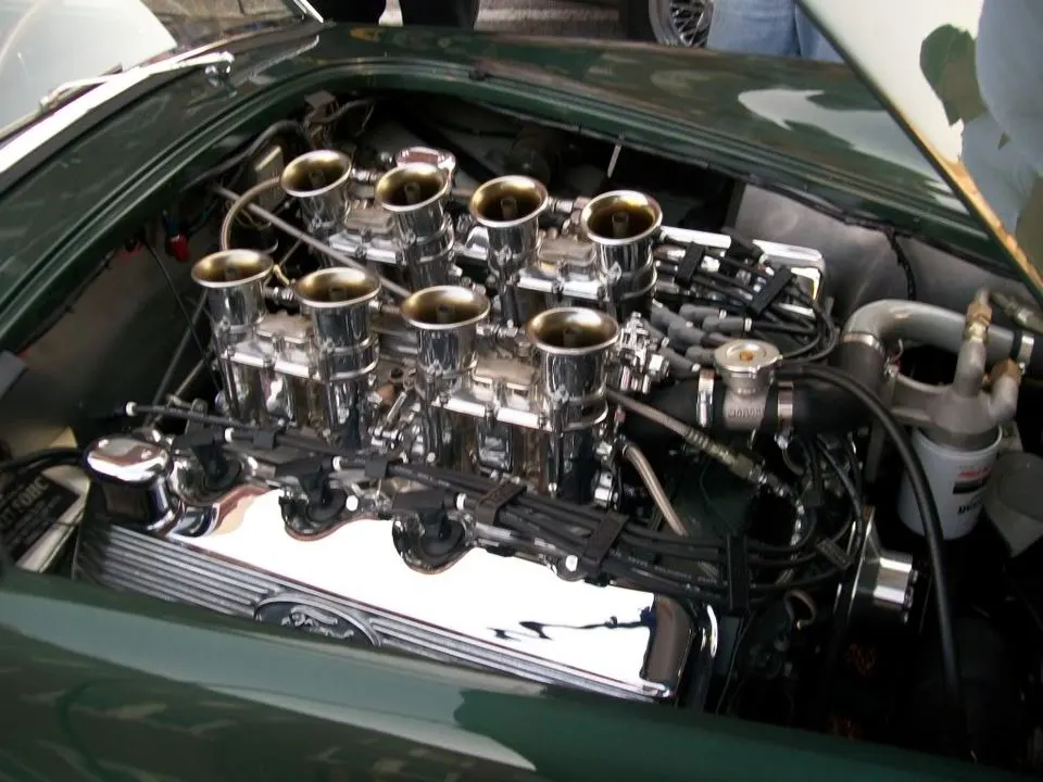

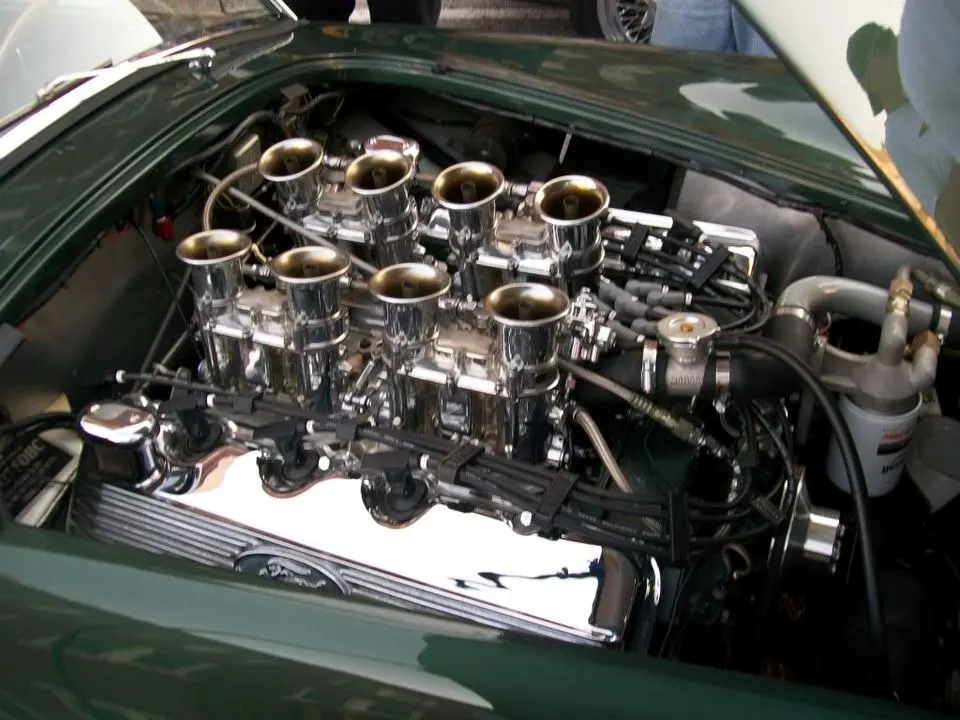

Here's a Cobra I saw at Mid-America.

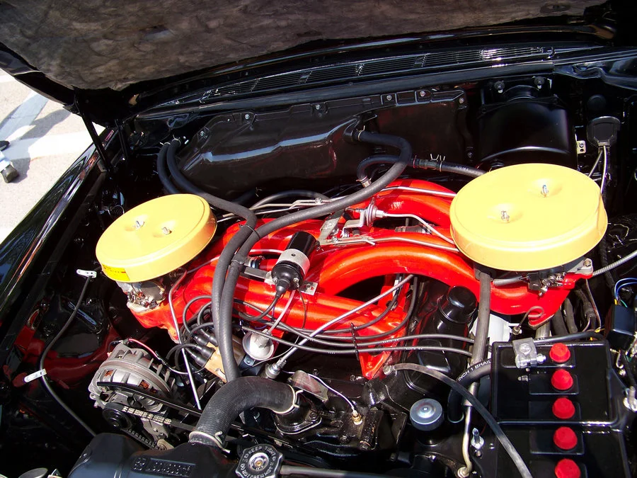

How about using your fabrication skills to make a long ram setup ca. 1960 Mopar 413/426/440? You'd never see another like it on a Ford, and it wouldn't cost you much more than time. I mean, since we're smashing together cars here anyway...

I've always wondered what you could do with a setup like that with EFI. On an application like that, you've gotta carry fuel in the air charge all the way through those long ass runners. In EFI, you don't. Hmmmm.

That looks like a real cammer and not a Coyote in that cobra. AND those are Webers. Those carbs are about 350 a pop. four of them, 1400.00. I'll bet I could never find a similar looking throttle body setup new in the box for even a fraction of that.
I like it.

Yeah, I've also thought about it, and I've always thought it looked cool as hell. But like Nik, I was concerned that the runner length would be a cold start nightmare, and a slow, sluggish pigbitch with regards to throttle response. (Now get it going on the high banks of Talledega,and I'm sure it'd be great.)
That coupled to the fact that the carbs would live right over the headers, and I think for me I'll have to pass on that idea.

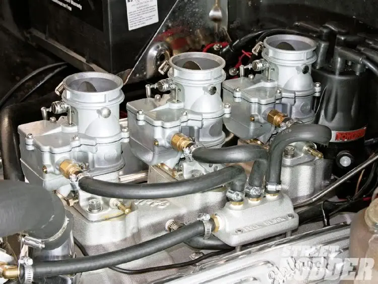

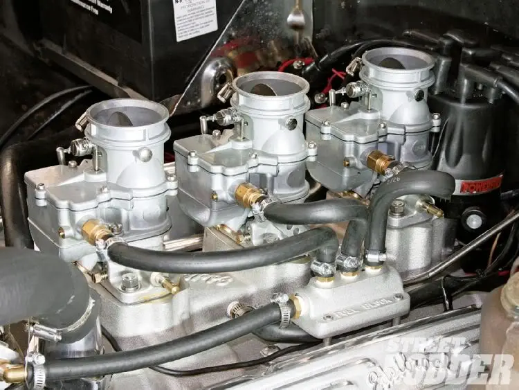

Well, I don't know if this would clear the hood, but this allows you to use your 4bbl carb mount for three 2bbl carbs.
The adapter is made for a 4 barrel pattern of 5-1/8” wide and 5-9/16” front to rear. The measurements are made from center to center of the bolt holes. Remember seeing this on Gearz, might not be exactly what you where thinking, but unique.
Three 2-BBL Carbs to 4BBL Intake Adapter - Speedway Motors, America's Oldest Speed Shop

I was talking about 3 Holley 2300 style two bbls. Those are Rochester 2GC's. (typical of what you'd see on a street rod, running a vintage flathead)
This is a 340 chrysler 6 pack. This is what I meant
I have pretty much ruled out any carb setup that will be covered by an aircleaner. (I mean what's the purpose of having all that junk, if you're just gonna hide it?)
Webers, or individual throttle bodies w/ little aircleaner screens on top is the direction I'm looking to go.
