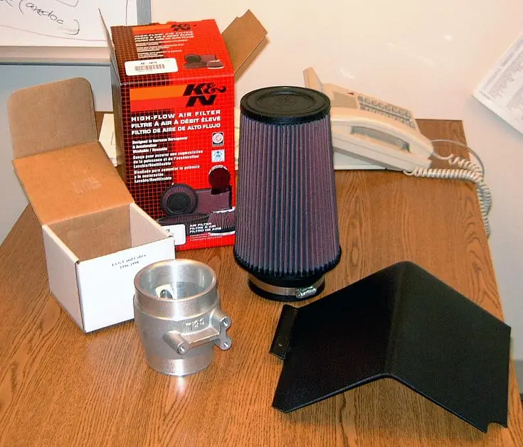

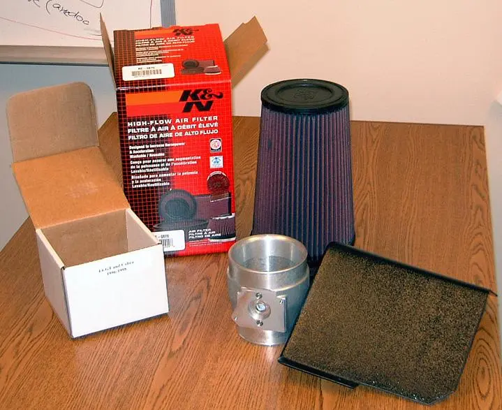

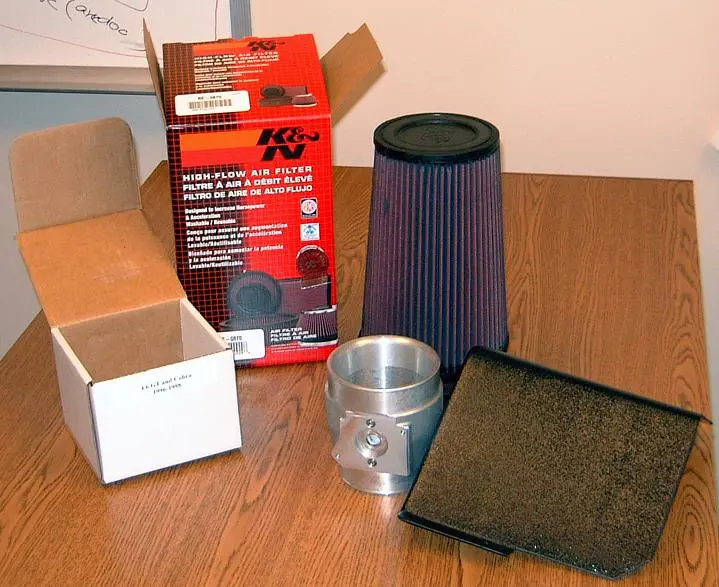

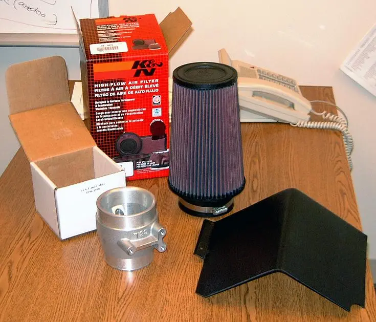

i know this thread is probably dead, but i just saw your future plans, starting with the maf, etc. i think that is a good plan, but i just have 2 things:
1. when i did my 80mm C&L maf, i did not do injectors or adjust the fuel pressure and i was pinging and getting "too lean" codes. you might want to do either injectors or increase your fuel pressure with it.
2. i have a 80mm C&L mass air kit for sale. it was on the car for about 2 weeks before i sold the car. pm me if you are interested in it.
