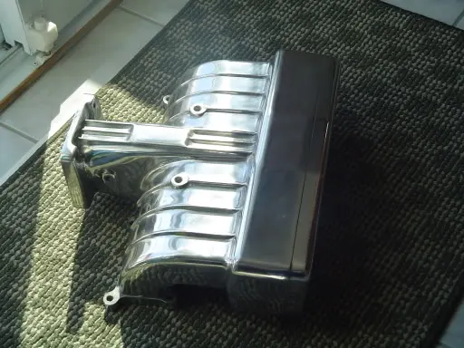

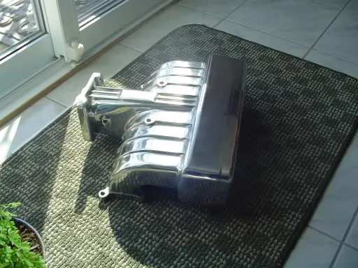

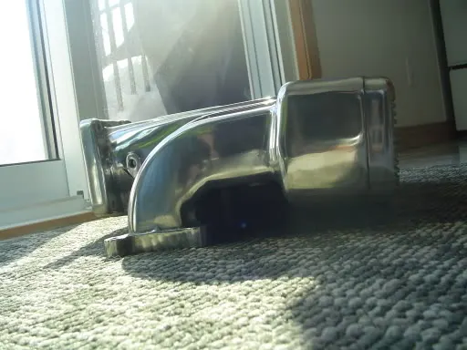

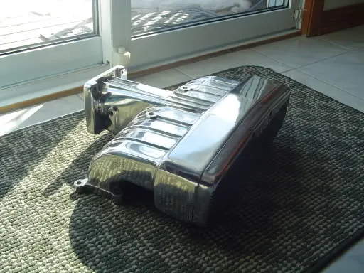

so far i polished a satin Professional products intake. pain in the ass to do. it has a lot of fins on it that seperates each runner so theres not alot of large flat areas to do. i just went over the intake once with tripoli. i still want to go over some areas on it. i'm going to paint inbetween the fins on the plenum plate black and those 4 inserts in the middle too. i should of gotten the polished version from the getgo but this one was used and i got it cheap and locally

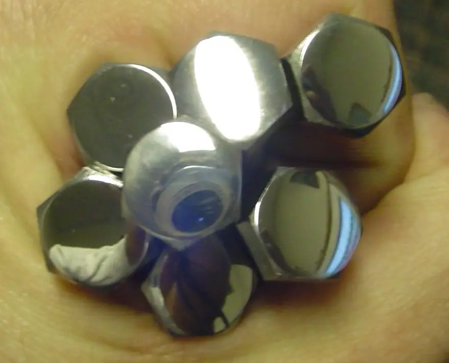

i polished up a kirban regulator i bought took me about a easy hour to do. no white rouge either.
i did some searching and posting and found out all the bolt sizes for the water pump, timing cover, valve covers, intake, and thermostat housing.
these turned out pretty cool and wasnt hard to do. no white rouge

what i do to polish is sand the item depeding on how deep the pits are. normally like on this intake i started with 120, 220, and 320. then i wet sand with 400 sometimes 600. after i attach a sewn buffing wheel to a hand drill and apply tripoli. going over small areas at a time. i wanted to try something different so i started with black emery to get the deeper scratches out. on smaller items i use a bench grinder with a sewn buffing wheel. for the white rouge use a loose buffing wheel.

It looks pretty nice! Kinda sucks you had to start with 120 on that thing, what a pain in the ass.
ya, i started with a satin. i was cheap and local. i payed $240 Canadian for the upper, lower, stock 19 lbs. injectors, fuel rails, regulator, wiring harness, heater tubes, and thermostat housing. to bad most of it is for a FOX, i'll just end up selling most of it.
ya, 120 sand scratches suck

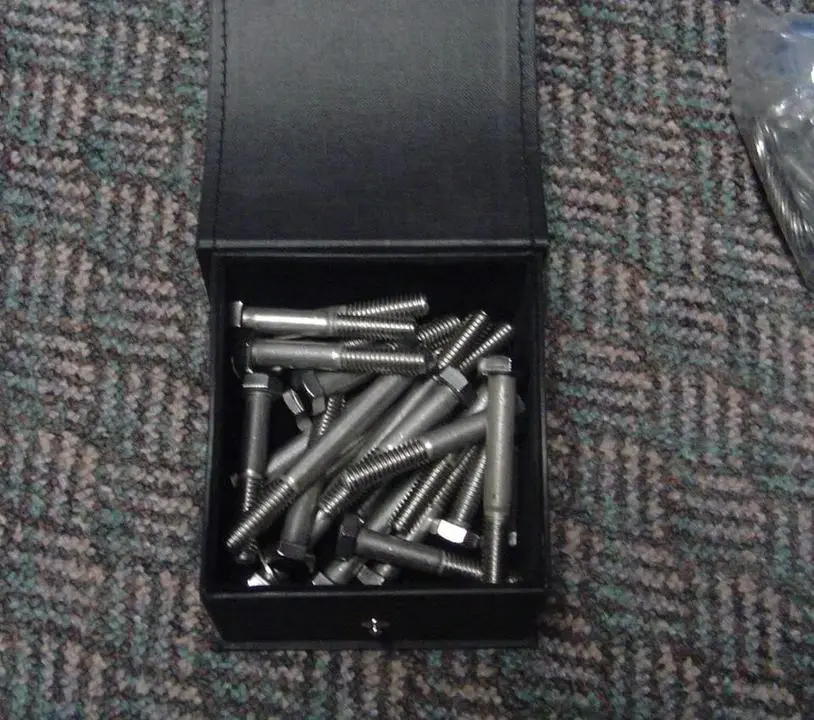

i made a post some time ago asking for the sizes. i did alot of searching but i eventually found them all. i posted it in the link but here they are again. hopefully these are the right sizes, havent tried them out yet lol. some bolts i had to get smaller because they didnt have in my size where i went
i bought all these in stainless steel. they should last
Water pump/timing cover
the thread size is 5/16 -18. here are the measurements:
(2) 1 1/4 in. long
(2) 2.000 in. long
(2) 2.1/4 in. long
(1) 2.1/2 in. long
(4) 3.1/4 in. long
(2) 4.1/4 in. long
Valve Cover
the thread size is 1/4 - 20 thread,
(12) 1 in. long
Thermostat housing
the thread size is 5/16-18 thread,
(1) 7/8 in. long
(1) 3/8 in. long
Intake bolts
(12) 2 in. long
