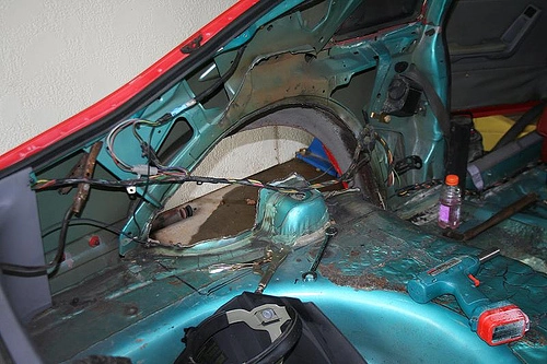

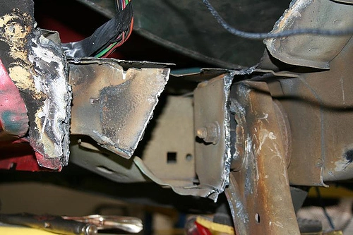

My Progress Pics
PS: We used cutoff wheels for his.... I will be using a Plasma Cutter on mine :D
-AJ
Although a plasma cutter would sound like a much better way to do it, I would be worried about cutting into other important areas without really knowing it. I'm not a pro fabricator (I've done a little bit), nor have I tubbed a car before, but my buddy is doing his notch right now and he blew right through a section of his torque box using a torch on the floorpan. I know a plasma cutter will be more forgiving than a torch, just be really careful! Looks good btw!
Thanks for the info. I will be careful not to hit areas that dont need to be cut. I am using Putnam's car as a helpful guide so i know which parts i will have to use a cookie wheel. I will prolly have to use the cookie wheel on all the frame notching but the parts that are think sheet metal with nothing behind it i will be able to ZAP away with the plasma.
-AJ

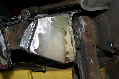

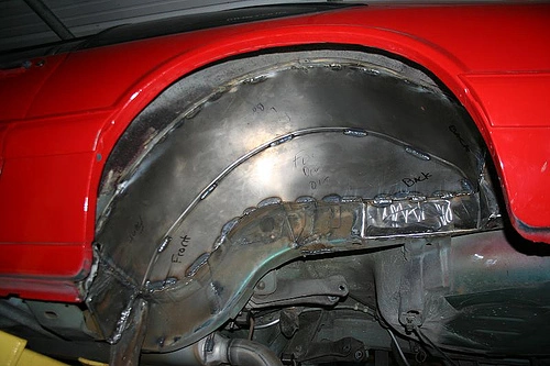

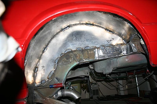

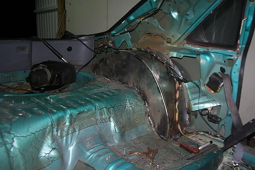

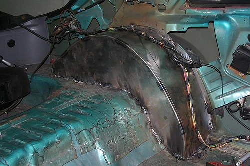

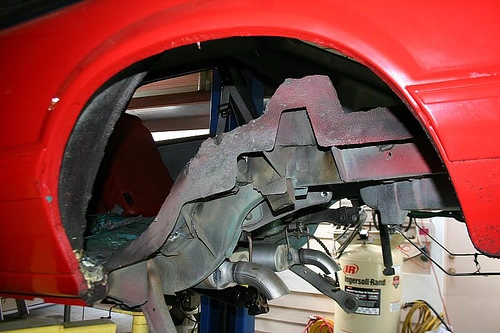

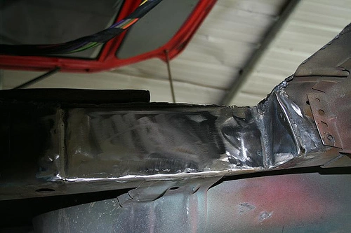

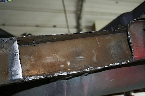

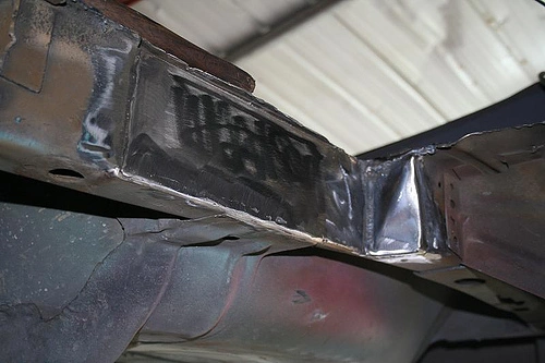

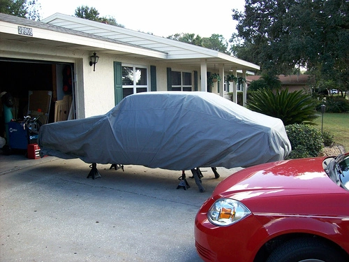

Here are some pics of the driver side done and the frame notching and capping.
Thats it for now. I did place my order from Wolfe Race Craft. Strange Single 10-way adjustable shocks with QA1 150# springs. And my Shock crossmember with upper mounting tabs and comes with the lower attachment brackets to weld to the rear end tubes.

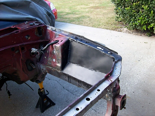

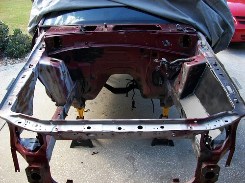

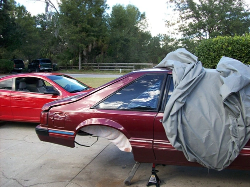

this is just a lil something to show how much work i have ahead of me

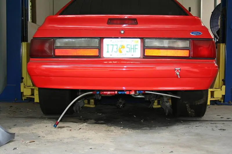

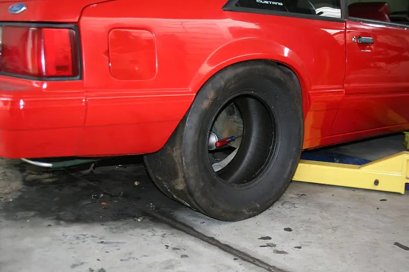

New MT 28x10.5w Pics !!!
I went down to Tampa and picked up a set of Mickey Thompson from a guy. I got them set under the car to see what they will look like. I gotta get my Weld Prostars ordered. I waiting on all my stuff from Wolfe Race Craft to come in so i can finish my rear suspension.
I should be able to hook now!
