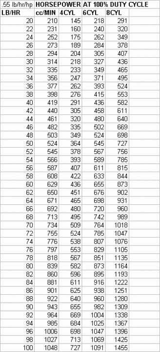

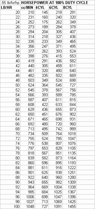

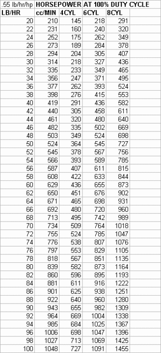

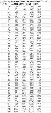

According to this chart it is crank hp used in the calculation, which would put him in the 100% duty cycle range.
HP vs. Injector Flow Rate
The following chart displays the maximum obtainable CRANKSHAFT horsepower vs. injector flow rate at 100% duty cycle, assuming a BSFC of .55 lbs./hp/hr. For Wankel and 2 stroke engines, multiply max hp in table by 0.9 to compensate for the higher BSFC of these engines. Injectors should be sized for 75-85% maximum duty cycle on engines used in constant high power applications such as race cars, aircraft and boats.
i'm betting that's for return style fuels systems and doesn't apply to returnless.

I don't think so. I just checked my SCT tuning manual and they use the same formula and they use crankshaft hp as the reference number. It makes no mention of it being different for the two systems except that the return style system will adjust pressure accordingly, or can be set manually in the EEC.
