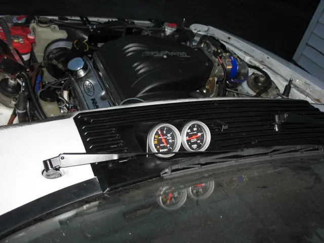

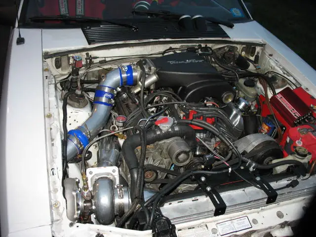

its all motor til the end of the burnout which youll hear the turbo
hp stage 1 turbo kit with electronic boost controller, on a 357w, trick flow intake, victor jr. heads, e303 cam, wideband 02 sensor with gauge. plus other goodies but ya...
took it out for the first time, and made 2 lbs of boost, the front lifted(not off the ground) but it plants you and broke the rear tires free, lil later on got to 3.5lbs of boost and the motors happy the tires wear down.. then finally got her upto 5 lbs of boost and that was insane, the rear tires stand no chance and when you hear the psssssh....you kinda get tingly... got to a stop sign, gave it some break and some gas, just enough to bring it off idle, dropped the break and the tires left their signature
my dad was along for the ride and i went into a parking lot, and was driving got into the boost and the tires gave way, he started flawling his arms like quagmire did when he was sittin in the strip club yelling wooooah and throwin his money all over the place, it was hilarious...the great thing about it all is the car stays pointing straight in the direction you started just has absolutely no traction...and they are bfg drag radials....
anyway just thought id share....hope everyone enjoys the video

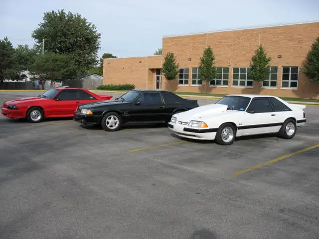

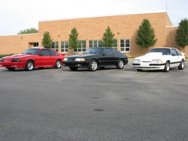

88mouse said:
nice.
i would like to have the car beside yours too.
ya the car beside it is a 74 challenger, with a 360 mopar crate motor, weld drag stars, t/a hood, r/t spoiler.....
but these arent too bad either
90 gt, 91 gt, and the 88 lx

Foxfan88 said:
looks really nice! whats done to the motor??
351 bored 30 over so 357, forged internals, about 9.5:1 c/r, u/d pullies, trick flow intake the black one, 3/8" intake spacer, victor jr. heads, harland sharp rocker arms and harland sharp stud girdles, 70mm t/b, aeromotive 1:1 afpr, msd pro billet distributor, e303 cam.....

there was a bunch of things we had to do differently because it was a 351, the proportioning valve had to be relocated, the driver side framerail had to be persuaded for clearence of the driver side header...the inner fender hole was massive due to the position of the header and turbo, the lower radiator hose had to be fabbed up, lots of crazy lil things in there too but overall the car is awesome.
