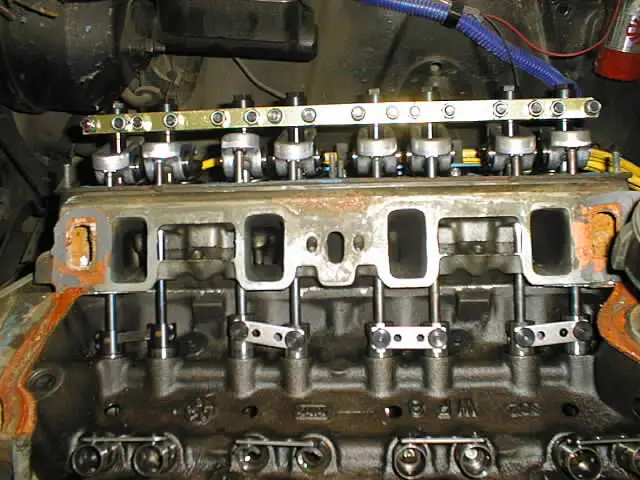

fwiw, I have a set of 66 289 heads, ported with SBC valves, still dont flow close to the AFR 165's I have..
my vert actually runs better with the performer than the RPM.. but I did some port work to it.. :D
