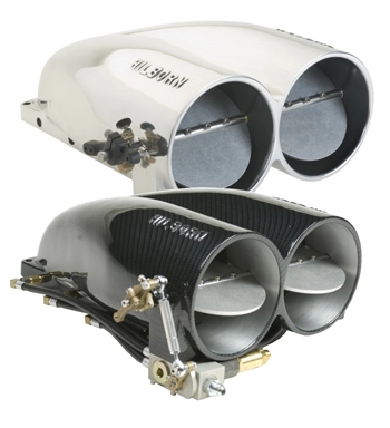

Actually, If I mill the existing Edelbrock manifold down to just break into the tops of the runners,....AND if I can get a 1/2" piece of alum plate completely tigged onto those runners as a base/mating surface for the blower, that'll put the bottom of the blower just above the top of the alt. From that line, to the top of the existing air cleaner measures 7". (which coincidentally is the same dimension for a 6-71 case height) the carb measures about 4" from base to top, and a 2 hole "ShotGun" blower hat probably about another 6-8".
(has to be a 2 hole "Shotgun", because no self respecting fabricator would settle for one of those gay, 3 hole, used up, "bug catcher" looking air cleaners that have been sticking through the hood of every tunnel rammed,or blown Camaro since the early 90's)
That said, while the blower itself would be under, the rest of that mess would indeed stick out of the hood right at 10-12".
But that is what is mod is about right? When was the last time you saw a carbureted 6-71 setup that wasn't scraping the bottoms off of the clouds?
