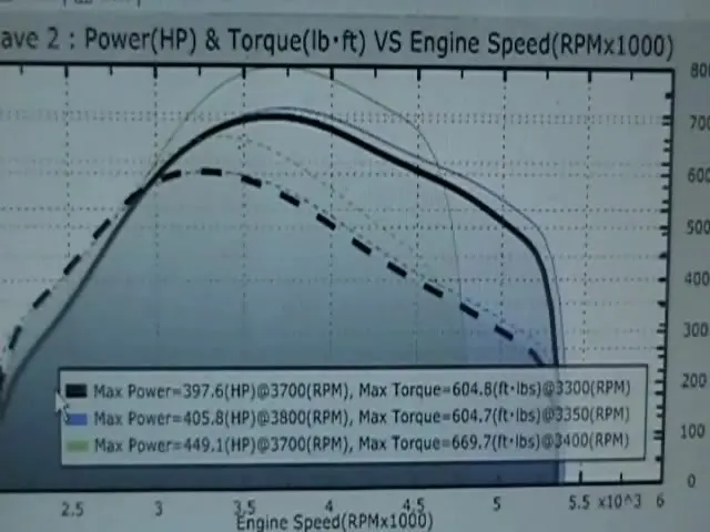

My car has had a weird problem of making peak power at 3700-3900rpm and I'm trying to figure out why. So far I've narrowed it down to a few things(or a combo of things) so I pulled the engine out of the car to hopefully try and fix it. Here are somethings I've thought of so far:
Bad valvesprings
cam not degreed and installed right
ignition "blow out"
Here is a dyno graph of the car:
As you can see the car is making good power when it makes power before it falls off. The car had a stock TB on it when it was dynoed and I found out that it was leaking like no other so a 70mm Accufab is on it now. My ignition box is on it's way back from Mallory and I'm going to try a set of the bigger Taylor wires out, so hopefully the ignition part is covered. That just leaves me the valvesprings and the cam.
Since the engine is out, should I pull a couple valvesprings and have their pressures checked just to eliminate the possibility? Also, can you degree a cam with the heads on? If not, should I pull the cam out and retard it 4* just to see if that helps it make power up top? Done a leakdown test and everything is in check.

It has a wideband and it's 11.6 across the board. The plugs did have a .032 gap I believe on the stock ignition so maybe that is the issue. I'm going to gap down to .028 and run the ignition box when it gets back and see if that helps anything.

Yeah I know about the block, it's going to be fun while it last though! As for your questions:
1. Didn't try a smaller gap because I was waiting on Mallory to send my ignition box back
2. Turbo isn't too small, tried a 76mm with a .96 exhaust housing(we thought the exhaust housing on mine was the issue) and it didn't fix it or make power any higher
3. It didn't misfire through the run at all, that's why I wouldn't face the fact it was the ignition issue
4. Boost is solid across the board, 10psi on the lower hp runs and 13psi on the 449 run
5. 93 octane
6. Total ignition timing was 19* on the 395 or whatever run and 20* on the 405 run, 19* on the 13psi run
7. Tried unhooking the mufflers with no hp or RPM gain, so that isn't a restriction either

What's up man! Yep, wouldn't you know it the day before I was scheduled to dyno my ignition box went out. I decided to go for it anyways for the fun of it and see what it would do. I'm glad I did really because it showed me the other issues I had at the time. I'll take a pic of the valvesprings tomorrow and post up tomorrow and see if you guys can tell if they look like they've been floating. I may throw the engine back in because I can always degree the cam in the car just as easy on the stand I guess if it still has the same issue after the ignition box is back.
The best way I can explain the power loss is it feels like it's pulling pulling pulling and then just goes "flat" and stays that way up top. It doesn't pop, crack, miss or anything just kind of stops making power and goes flat. I'm borrowing a buddies set of big taylor wires, will have my ignition box back and plan on tightening the gap up on my plugs just a little. With the boost leaks fixed and the ignition system in top order, if it still doesn't make power up top I'll know it's valvesprings or cam related for sure then.
