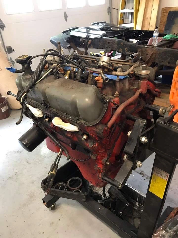

Should I swap the motor or work on the v6?

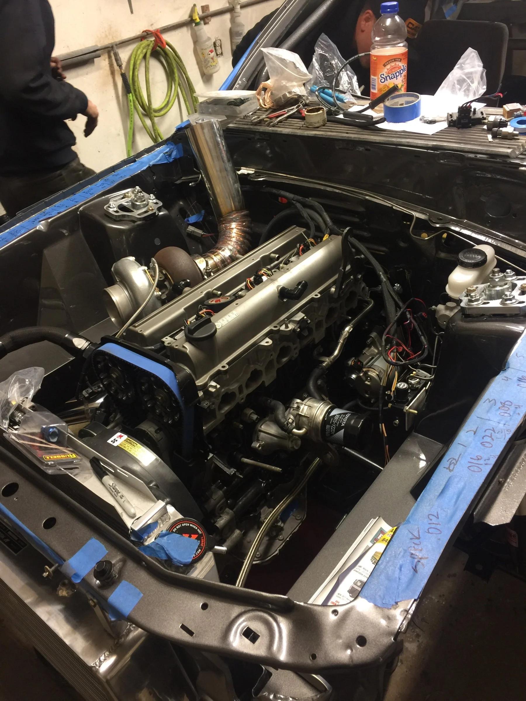

Or you could do one of these straight 6s .... We built the mounts a year ago this March . Body is paiinted motor assembeled and we started the engine for first time 2 weekends ago. A project I have been working on with my buddy for a few years now.

2jz makes stupid power. Stock engine can handle 35psi and make over 900 without unbolting the head
Stock crank , mains are studded , Manley rod , stock piston . Porter head , GSC stage 2 cams and a precision 6466 . Should be a killer street car when we're all done with it .
Going through the last couple of pages my suggestion would be to sell this car and buy something that meets your wants/needs. It's a clean car you should find a buyer fairly easily. Just don't expect a ton of cash for it. You're waffling all over the place. That's a recipe for dumped cash and a car that doesn't live up to expectations. Ask me how I know....

If you want reliable, respectable, and cheap put a roller 351 in it with a mild camshaft and decent carb and intake. It's really the best bang for buck. More than 250+hp and 325+tq. Plus, the block is good for 750hp....if you ever want to add boost. Add heads and the numbers climb a even more.
Either way you will need a k member, headers, dual exhaust, intake, carb, accessory brackets, fuel pump, fuel pressure regulator, camshaft, distributor, plugs, and wires, oil, oil filter, hot chic to pose with car.... What's an oil pan after all of that ?
No real need to punch the motor out...but you could stroke to 393, 408, 427.
351 , vortech , TKO would make a fun car .
O wait wasn't supposed to post that
What transmission are you using for this engine, and what controller for the engine?
Haltech elite 2500 standalone with a race pak dash . Quick time t56 to 2jz bell housing , using the aje k member we were able to build the motor mounts so that the t56 fits in the stock location using a stifflers crossmember
