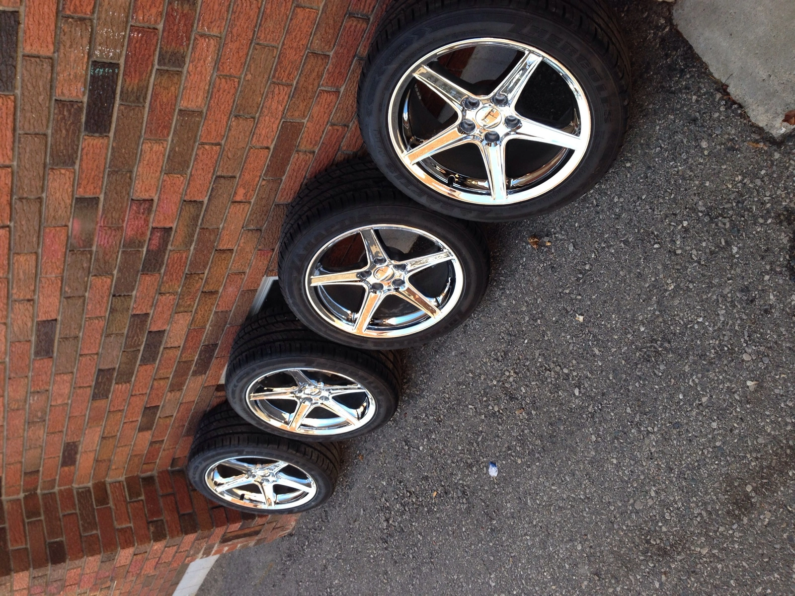

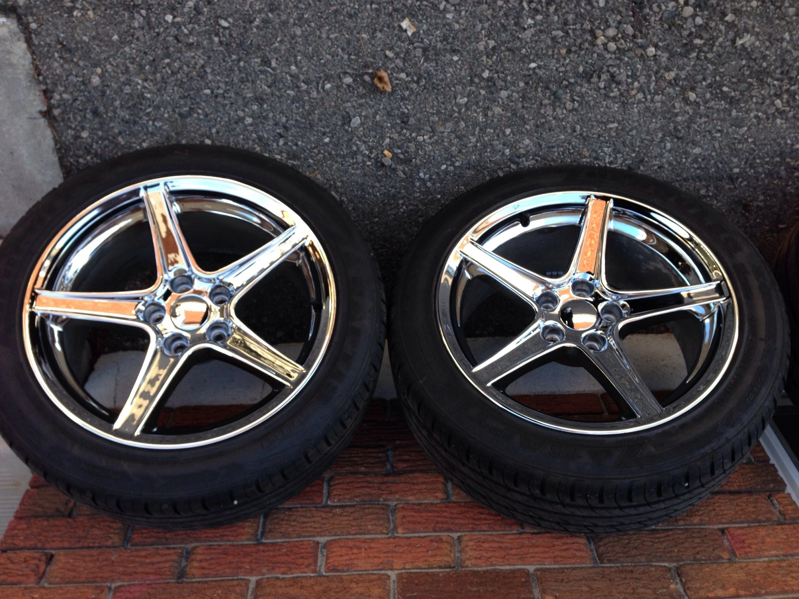

So here's what I picked up, 18" saleen reps by American Muscle. Here's what I'm working with.
1989 GT Cobra (Clone)
Front suspension has Tokiko blues on, rear has quad shocks removed and Tokiko blues on the back as we'll, MM control arms, lowered an 1.5" with eibach springs. I think I have a little bit of a problem. The side wall maybe too tall. Tires are 245/45/18x9 all the way around. Is anyone running a 45 series tire on a 18" rim and lowered suspension. I think I maybe have to sell the tires and go with a 40 or 35 series rubber. 285/35 or 40 on the rear and 245/40 up front

A 245 45 18 is a very tall tire.
That's over an inch taller than the 275 35 18 i run.
It's just too tall.
I can damn near guarantee it's going to rub like hell turning in the front.
Maybe hit the tailpipes in the rear, along with looking like a truck or suv tire.

I think your bang on the money. And your right, I'm not worried about the width. It's the height. Previous rims were 17" ROH ZS with a 275/40/17 on the rear, no problems at all, and fronts were 255/45/17. My issue is going to be the height of the sidewall. I may end up having to go with even a 35 series tire. 285/35/18 on the rear, and 255/40/18 up front. I apologize but for right now it's just pure guessing until the car is home from storage this spring. And I don't want it to look like a monster truck lol. I posted the tires for sale already, and summit had nitto 555's a 285/35/18 for $225.00 a piece. Not bad I don't think.
No. You should have ordered 245/40-18 front and 275/35-18 rear.
What offset are those rims as what 5 lug swap are you planning. Those questions will impact rubbing a lot more than the tire size.

Fenders front and rear were rolled last year by a shop because I knew what my intentions were come this spring. The wheels are 18x9 all the way around with an off set of +30. And I just changed my order of the tires so I hope you guys are right. Lol!
