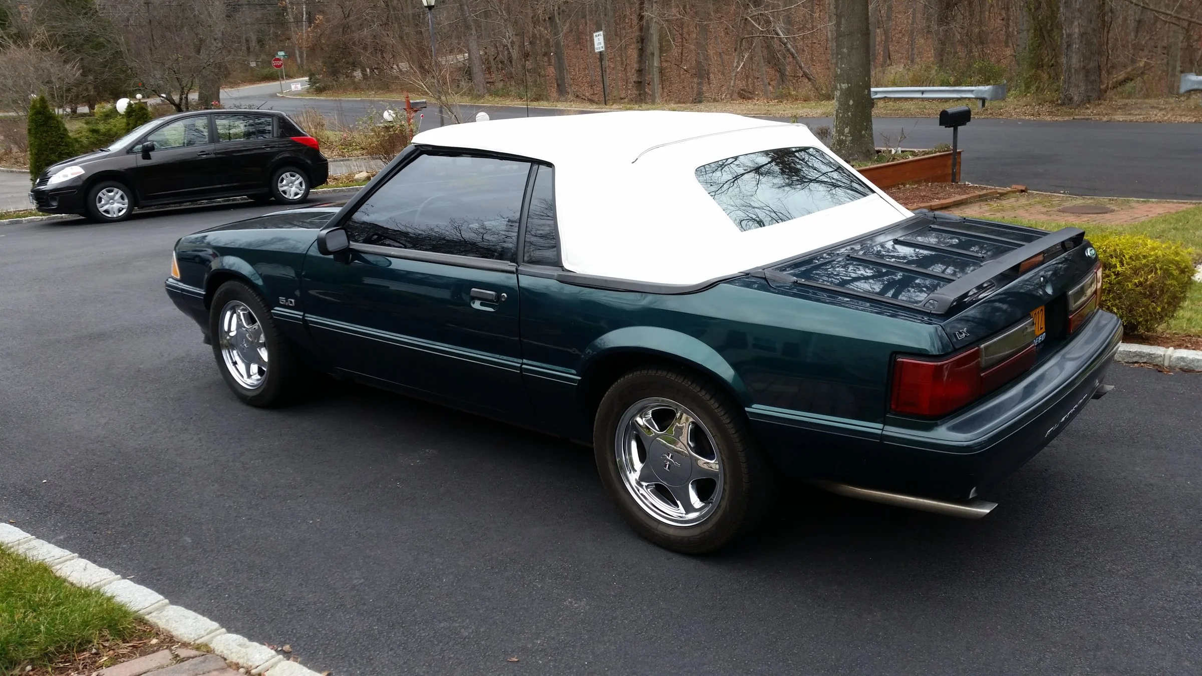

Hi everybody. Just bought a 1990 Lx 5.0 Convertible 7UP edition and looking for some suggestions on radials as well as some other basic upgrades.

For street tires, I recommend Nexen on the budget end of things (N5000s are pretty decent), and Bridgestone/Firestone on the more expensive end of things. I'm personally a HUGE fan of the Firestone Firehawk WideOval A/S, have them on my Mustang II and on my dad's 2013 Hyundai Accent hatch, they (surprisingly) perform equally well on a rear-wheel-drive musclecar and on a front-wheel-drive hot hatch. Other really good choices would include most of the Continental Contiprocontact line, almost anything Michelin/BF Goodrich makes (though they're very prone to dry-rotting long before the tread wears out), Hankook and Kumho's sport tires (the Ventus from Hankook in particular is excellent), and Pirelli's PZero line if you're not going to drive in wet weather often (they're HORRIBLE in rain though).
It's a 5 speed. I have Kumho which spin way more than I'd like in 1st and 2nd. I had mickey Thompson ET Street radials on my vette which hooked up real well. I'm not looking for anything that extreme but def something that is going to help me launch off the line.
Pirelli PZero Neros stuck like glue on my stick 2010 GT, the Firestone Firehawk WideOval A/S on my little II spin just the tiniest bit with 300rwhp, a really steep rear gear, and not nearly enough weight on the ass end, and they're really not wide enough (running 205/55/16 to match the biggest that clears in the front so I can just have one spare).
congratulations and welcome.. For tires, I like BFG Comp 2's.. but they are a 340 wear rating and are not for someone looking ot get 40,000 miles out of them. Nitto's are great but imo not for all season or in the rain.

I plan on keeping it nearly stock that's why I thought tires might be a nice lil way to get some more performance and keep its value.
The shifter is stock and definitely has long throws.
I definitely baby the car but on those rare occasions I'd like to line up at a stop light I'd like to have some grip.
