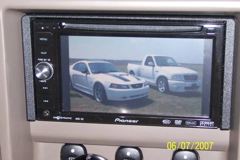

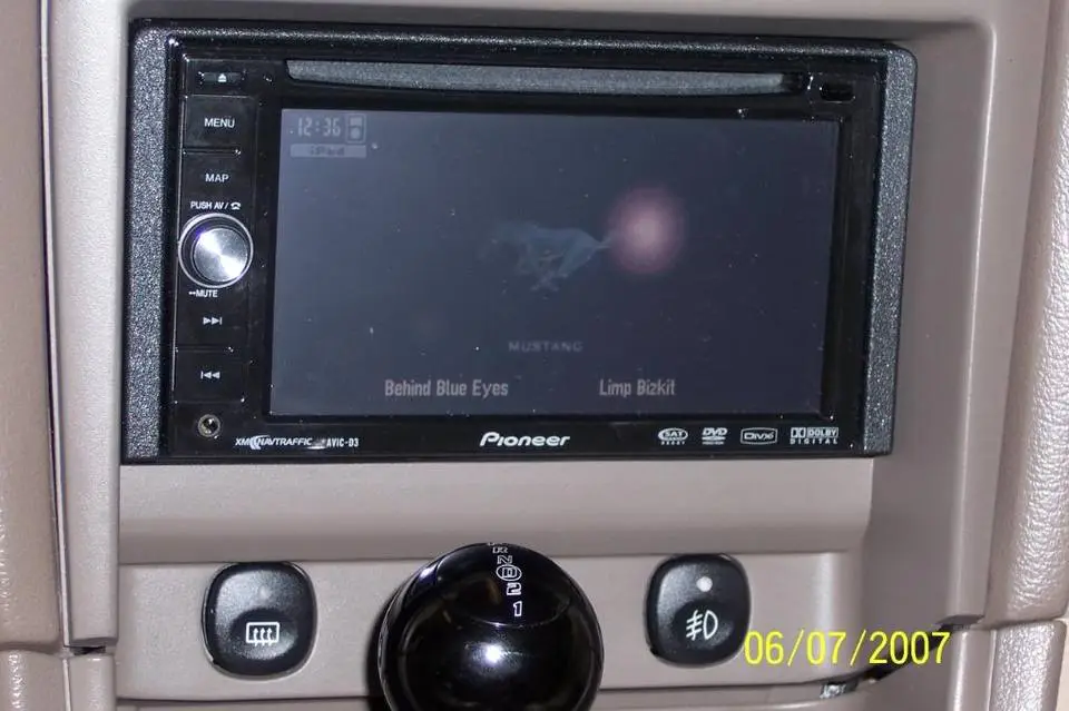

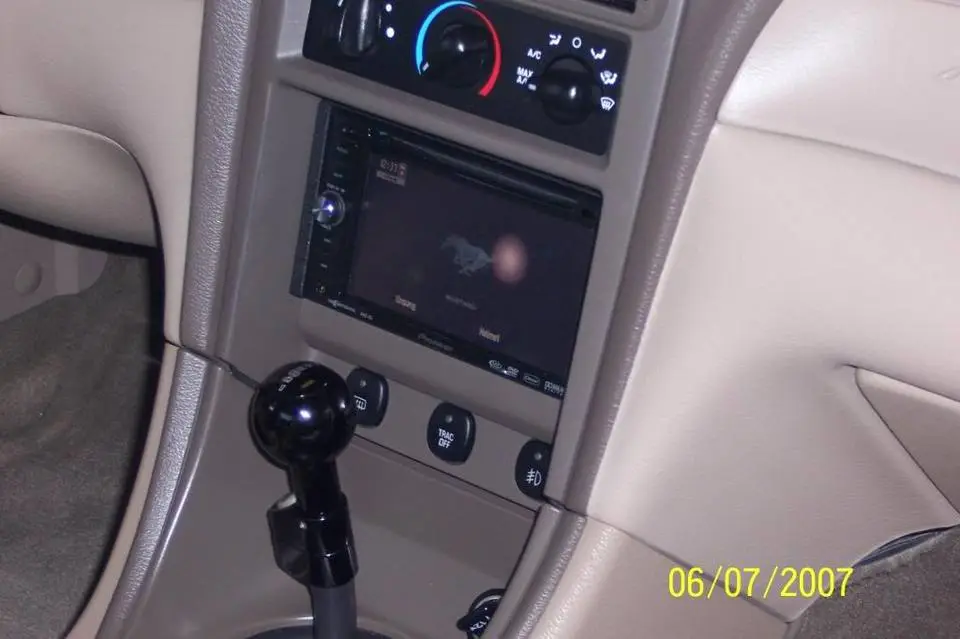

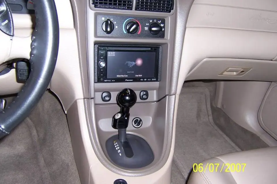

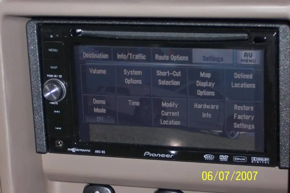

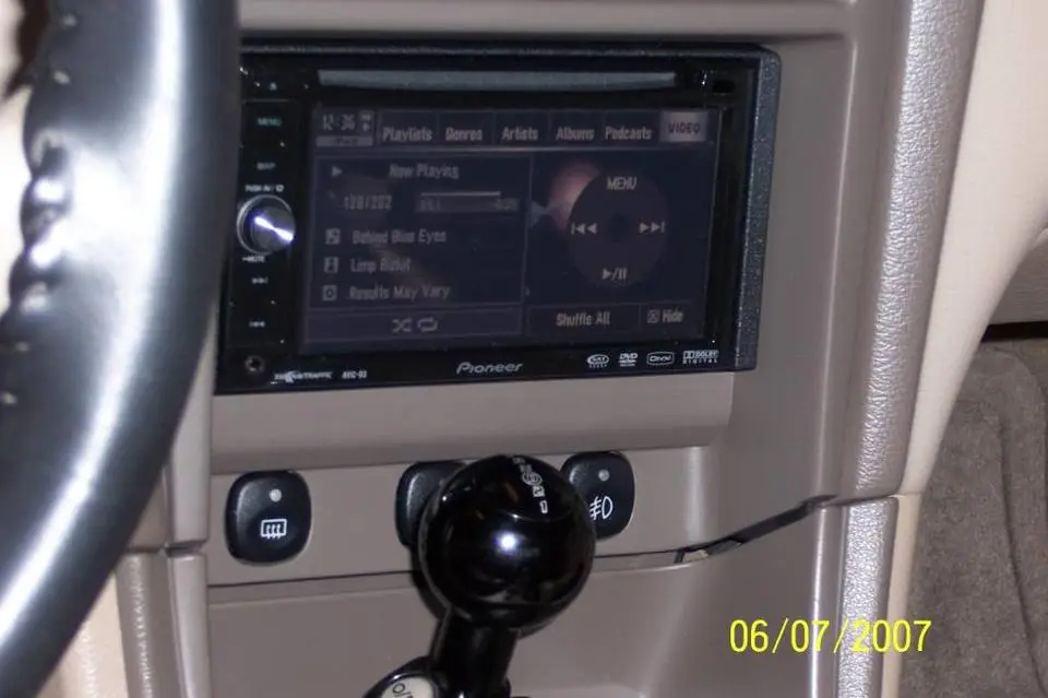

Slowly getting rid of the Mach 1000 system in her car. The 6 disc changer pretty much quit. So now she has the Pioneer AVIC-d3, very nice. I also got rid of two of the stock amps and all the speakers except the two subs in the trunk, soon to also be gone. I put Polk audio comps in the doors and the rear deck, which I have hooked up to a Kenwood 4 channel amp. Man does this thing rock now. Much better than stock. Heres a few of pics of the Pioneer.
