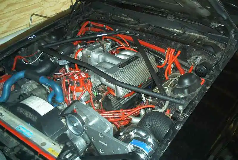

I am at work so i dont have pics right now of the car, but I do have some of the engine bay and stuff... Wanna see them??

Yeah, pics are awesome! A guy in my school had a 87' 5.0 T-bird with 10-hole rims. Looked and SOUNDED amazing. Plus the guy drove like a maniac and showed off all the time, that car made me want a 5.0 so bad. Unfortunately u can only get t-birds in Automatic, and they're a lot harder to find than stangs anyway. so i went with the mustang. Im not complaining tho, I love my car!

Heres some pics...

The combo is a gt-40 long block, ATI P1SC w/3-core. I have just about all the bolt ons. 42 lb inj, gt-40 intake, complete msd ignition, 70mm t/b, equal length shorties, x-pipe (no cats), 2.5 tails, pro-m ati MAF, cobra ECU, etc... 4.10 gears, tremec....
