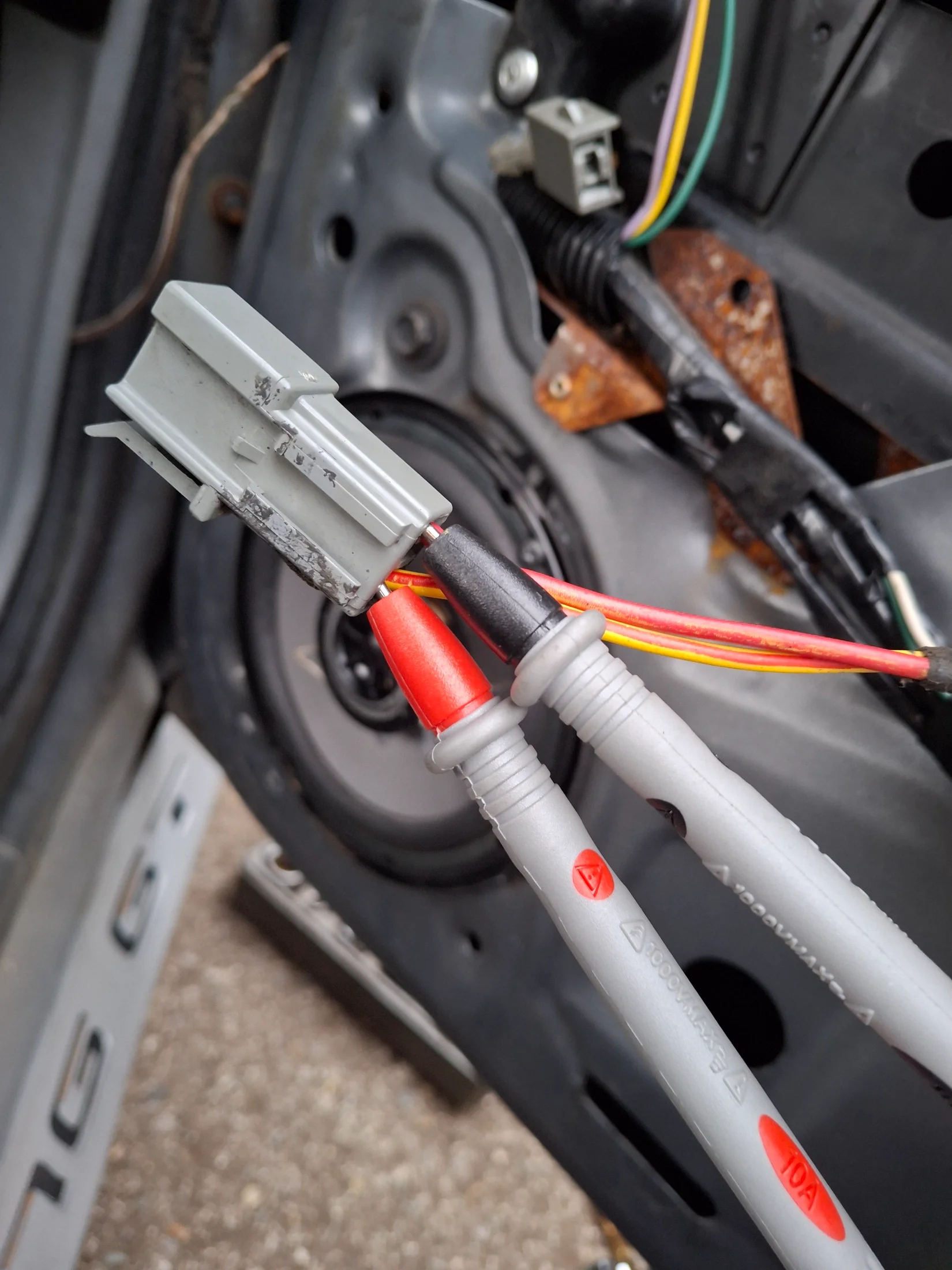

I took the door panel off of the right hand door to see if I could figure out what is going on with the power window motor. I hooked up my multimeter to the back side of the door harness that connects to the power window motor (see pic) I was getting some weird readings when I would activate the up and down switch. I was getting between one and two volts, positive and negative, depending on which way I pushed the switch.
I disconnected the connector from the motor and left my test leads in the same position on the door harness and hit the window switch again. Now I was getting positive 12 volts and minus 12 volts like I would expect. I hooked up the connector from the door harness to the power window motor again and got the weird reading of only one and two volts.
I rigged up a couple wires to the power window motor connector and connected it to my jump box. I was able to get the window to roll up and down.
Does anyone know why I am getting low voltage when I connect the body harness to the window motor? I wouldn't think it is a bad window motor since I can get the window to go up and down with the jump box. Could it possibly be a ground issue? If so, where is the ground for this wiring circuit that I would need to clean?
I guess I should also so mention the drivers power window works properly.

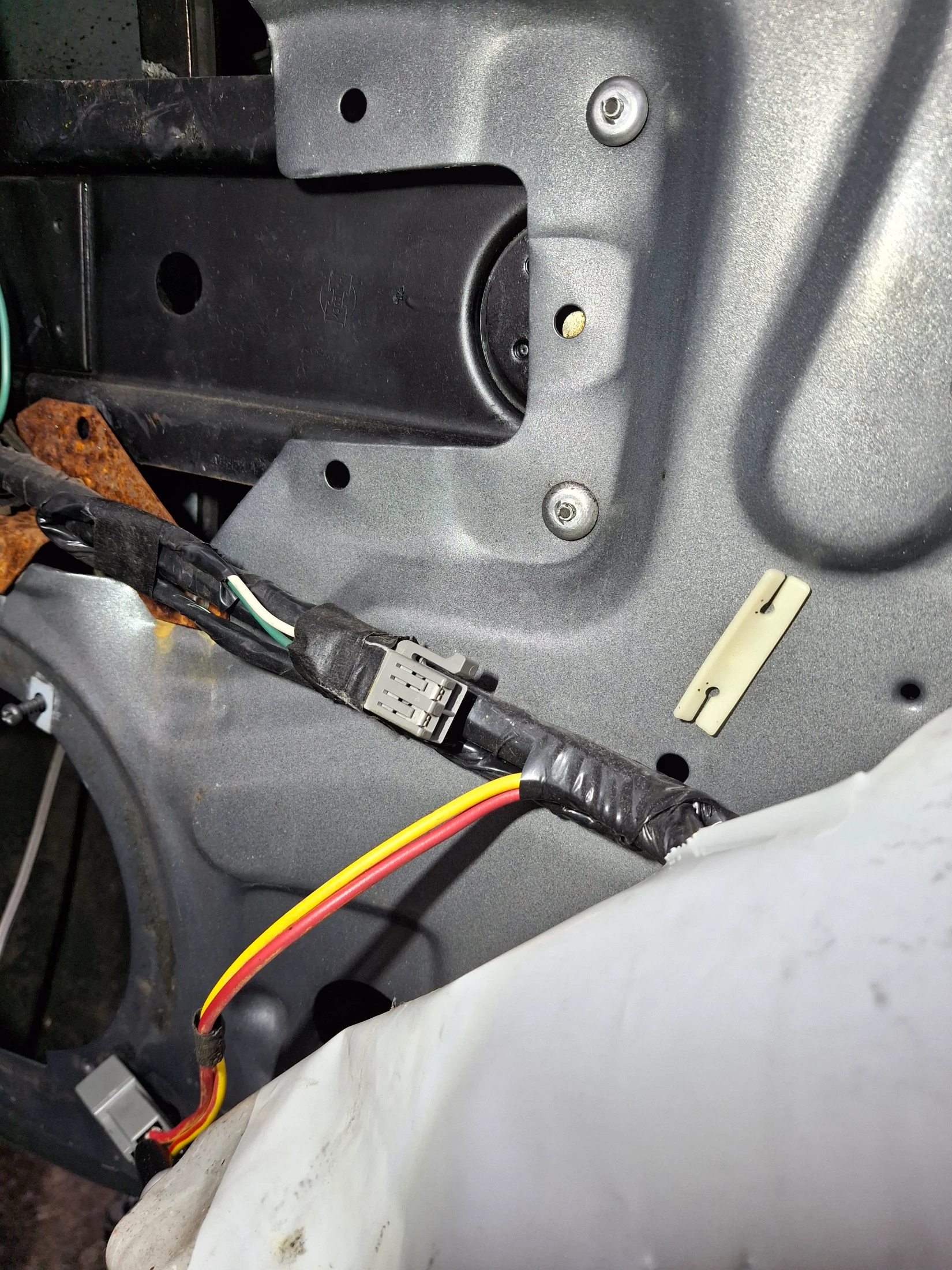

While I had the door panel off to look at the power window motor I wanted to see why someone had a wire running from the door speaker to the rear speaker. While I was looking around on the door with the door panel off I saw a secondary harness that was taped to the main door harness. The tape looked factory. I am guessing this harness is if the car had speakers in the door from the factory. Is that correct?

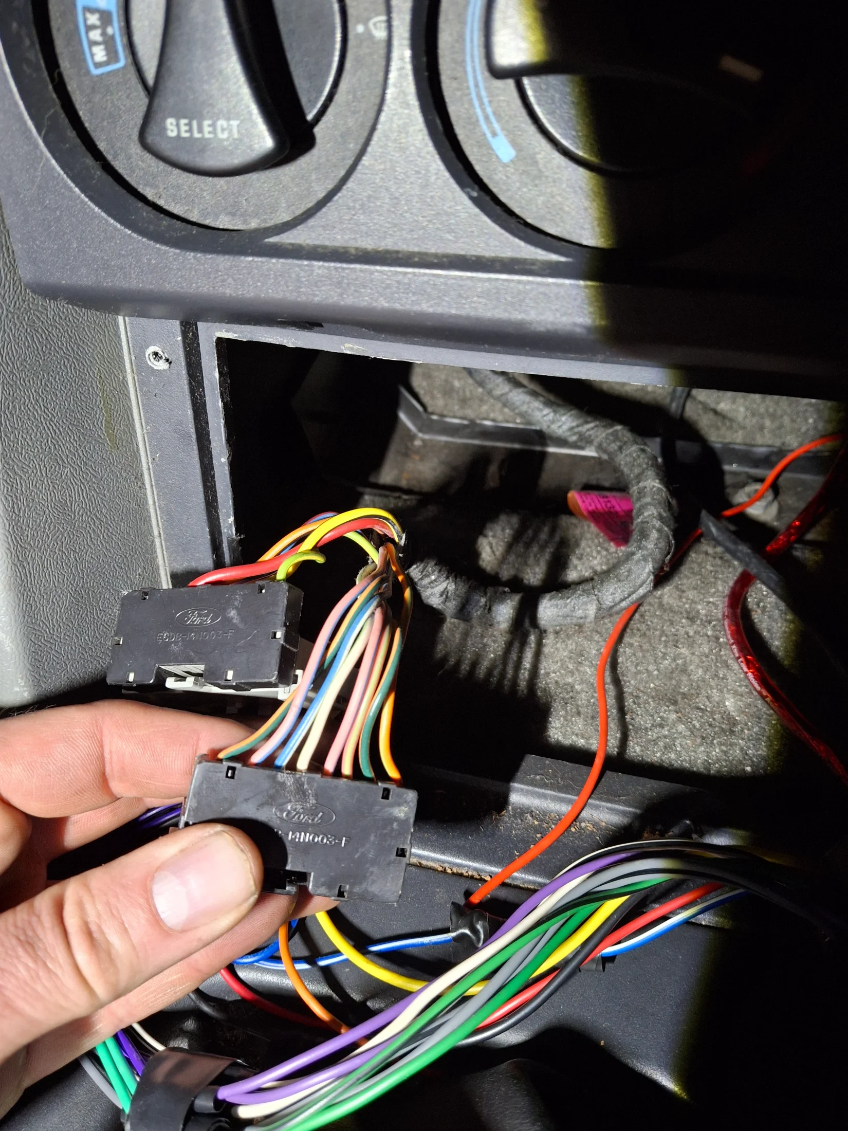

I pulled the kick panel back a little bit and found a connector with nothing hooked to it and the same color wires as the connector in question on the door. I want to run dash speakers and door speakers. Do I run wires from the connector in the kick panel up to the dash speaker to wire the door speakers?
Itooks like there is not any factory wiring for the door speakers at the connector that goes into the radio. I'm guessing that is because my car did not have premium sound from the factory.

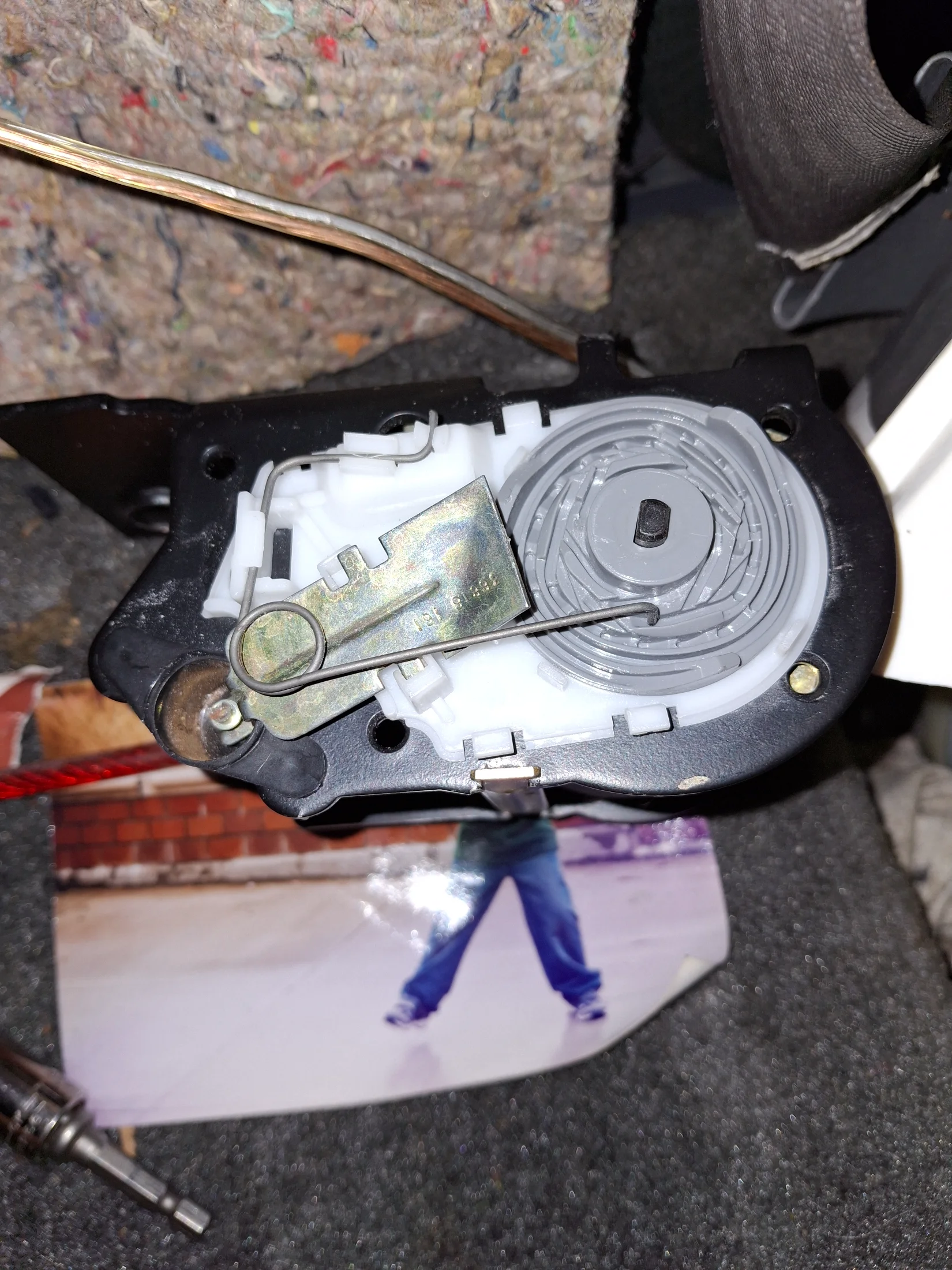

Last night I removed the inner quarter panel plastic trim so I could get to the seatbelt. I've never removed that trim on one of these cars before. It wasn't too bad but not a lot of fun either! I did have a problem with the metal piece that goes above the door and covers up the edge of the headliner.
I removed the seatbelt assembly and took it to the bench. I rotated the spool that the seatbelt winds onto a little bit and the seatbelt suddenly recoiled like it should. Basically it was stuck. I got to looking at it a little more and experimenting with it. My car is an '88 so it has that little plunger in the door jamb area. I took the cover off the mechanism that is activated by the plunger. It has a weird looking mechanism (see picture) When I was experimenting with the belt I was able to get it to get stuck in the full extended position a couple of times and it was because the little spring looking thing was getting stuck.
I took the whole mechanism off and I think I'm going to leave it off. The seatbelt seems to function properly, if not better, than when the mechanism was on it. I wonder if the 1990 and up cars were the same seatbelt design minus the plunger and it's associated mechanism? I bet they are the same and this was more than likely a problematic design and why Ford went away from it starting in 1990.
I think I'm going to re-install the plunger but leave the mechanism off that goes on the seatbelt assembly unless you guys see or think of something I'm not seeing or thinking of.....
