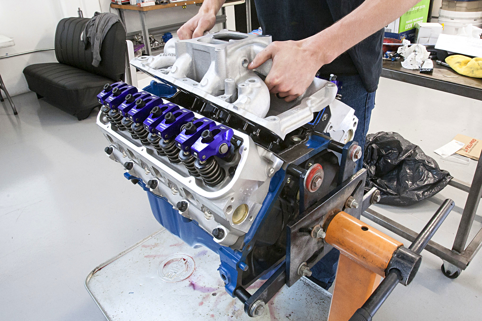

If it were me, I'd use the engine you bought but get a set of heads for it. With a set of heads you'll likely need to get new injectors, 24# should work. I'd also definitely go through the engine to be sure it's up to snuff. Maybe it's just me, but I don't trust anyone's work by their word unless I know them well.
As for heads, here's a link for you to an article where they're looking for 350 HP. I realize this is a little more than you're looking at right now, but it's also another resource you can reference.
And here is a link to my post from last week about heads. There are a few different brands mentioned that would work nicely for what it sounds like your intentions are. There are also a few different links you can use for research.
As I stated in that thread, I'm leaning heavily toward a set of FloTek heads. They can be had for around $800/pair. There is a link to Speedway motors for those heads in that thread or here is Flo Tek's direct link. I've not researched deep enough to know which way is the cheaper route once you include shipping and taxes and such. I have a feeling direct from Flo Tek's site may be the way to go.
