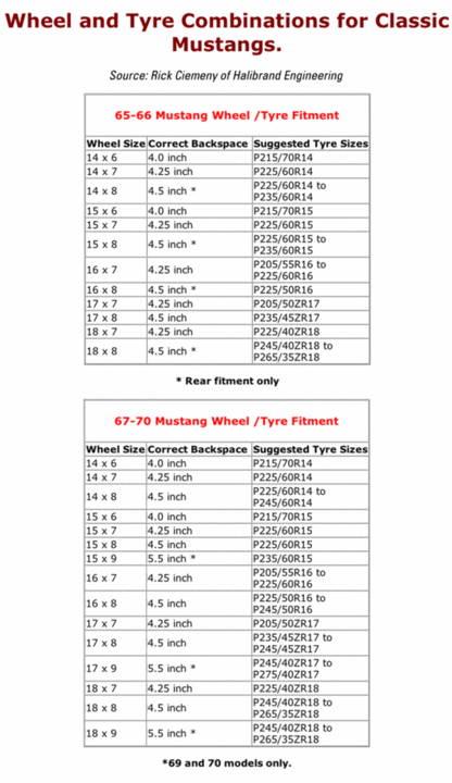

oooh... I found the chart... I'll check it out and maybe that will answer my question.
I would still like to know what others with a stock suspension setup run on their 15" rims...
