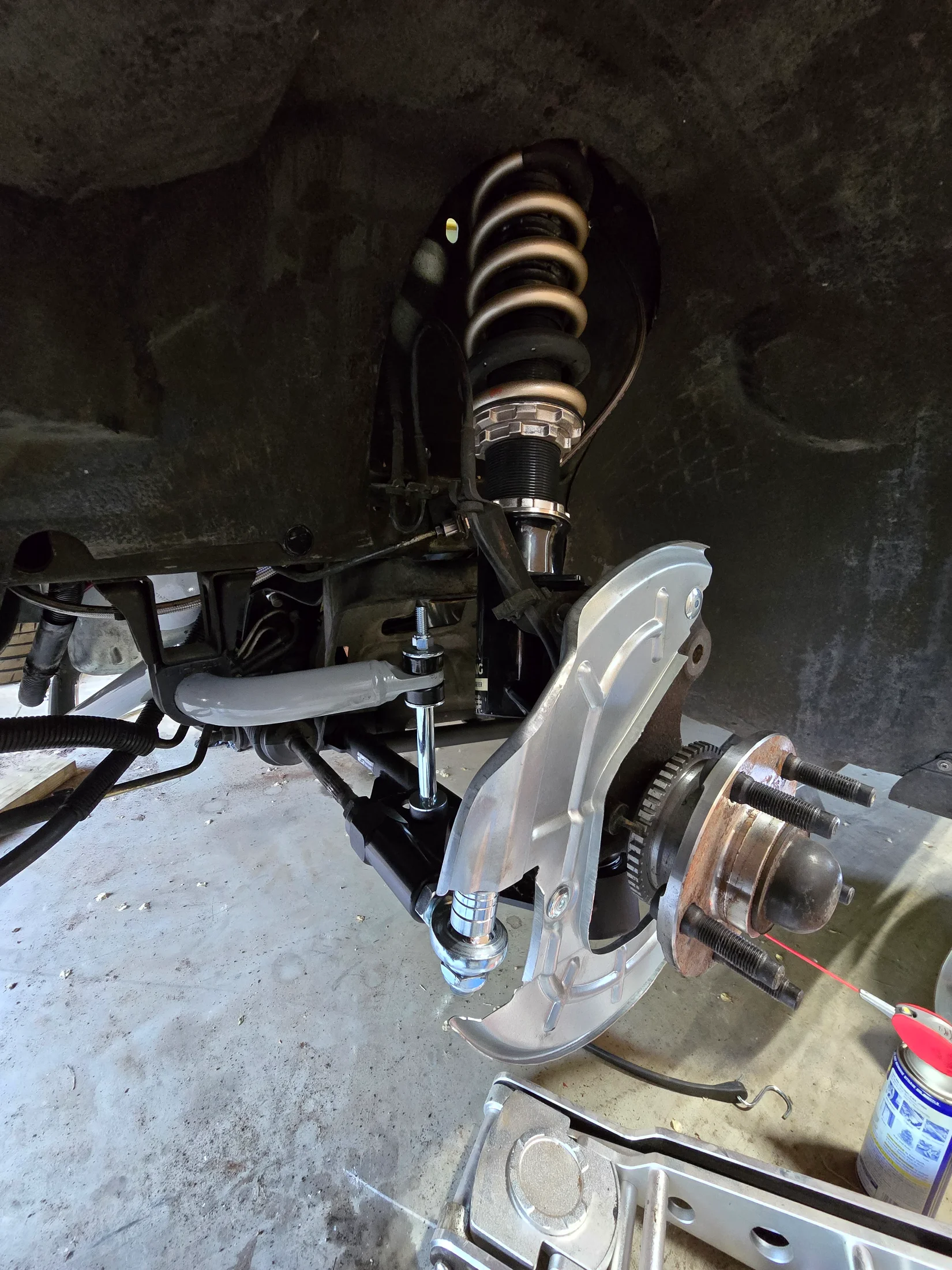

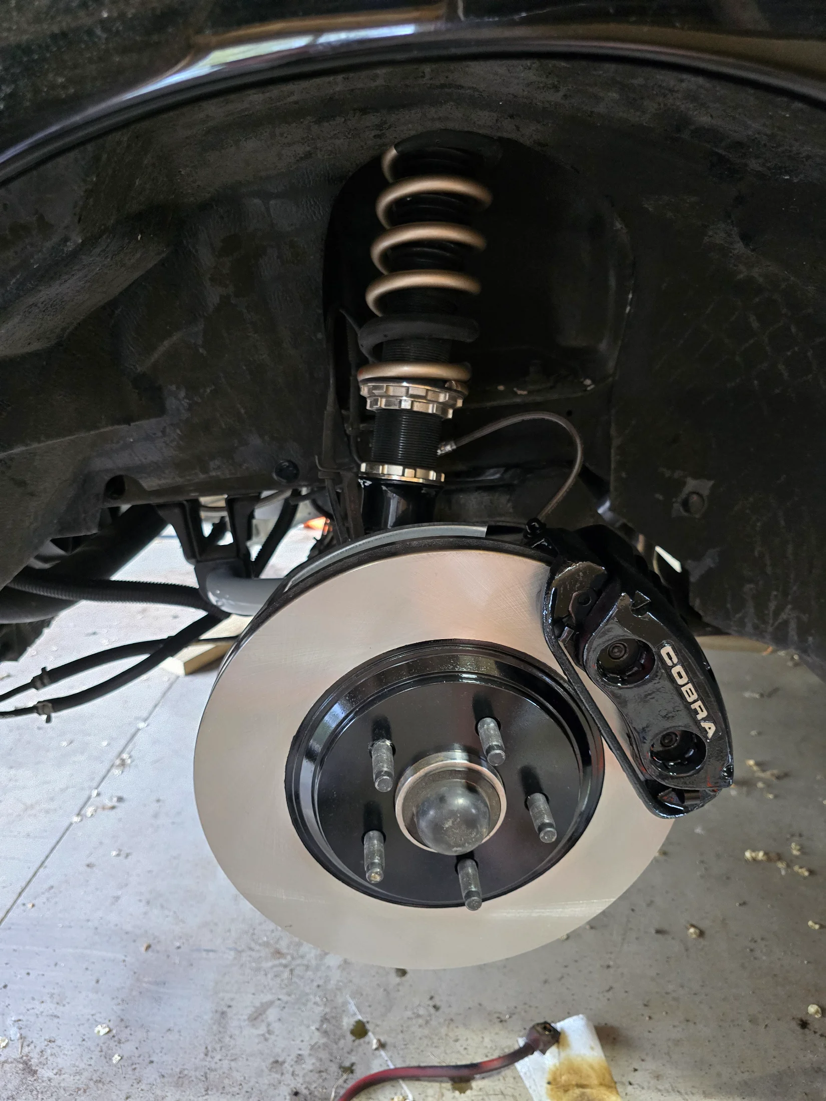

Getting there. MM arms are on. Steeda sway bar with new end links are on. Fresh brakes with shiny painted calipers, new dust shields and stainless brake lines are on but not yet bled. Went ahead and got a bump steer kit "since I was in there." Stiffer coilover springs installed. Hubs are fresh Moog units as of last fall.
Like a dummy, I ordered a full 94-95 Cobra stainless brake hose kit. Drrr, the rear hoses no worky on an IRS. So the rear stainless hoses will be here this week and I can swap them in and get things bled. The rear brakes are nearly new, so I only plan to paint the calipers and rotor hats for a cleaner appearance, like the front.
I also have a Stifflers transmission crossmember to replace my l
hogged out stock one. Now that I've invested so much in this car, those little hacks bug me.

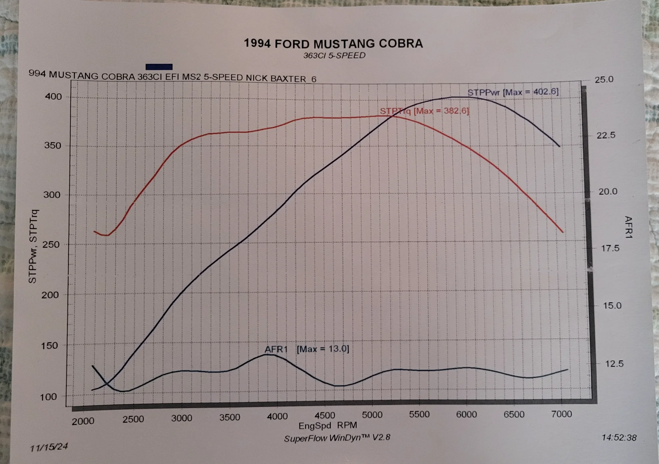

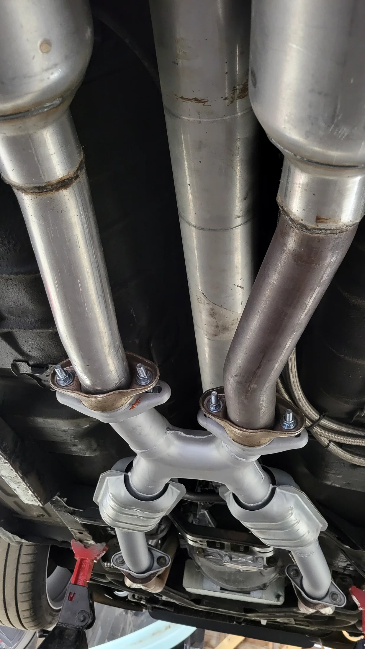

I ended up going with a Victor EFI intake and an 80mm Accufab TB. I knew I was trading off that high RPM horsepower, but didn't realize just how much until last Friday on the dyno. I modified a BBK catted H pipe to fit my Mac longtubes, and replaced the now too quiet Magnaflows with Jones Full Boar mufflers. I actually love the sound, and lack of fuel smell from the exhaust.
I have to upload the vid to YouTube, so bear with me. I was expecting 430-450 at the tire based on 567 at the crank (with the old intake setup) on the engine dyno. I was slightly let down only hitting 402. Even more so seeing the power drop off at 6000 RPM, where it was still climbing at 6700 with the old intake setup. Needless to say, E85 and a Vortech are in the cards for next year.

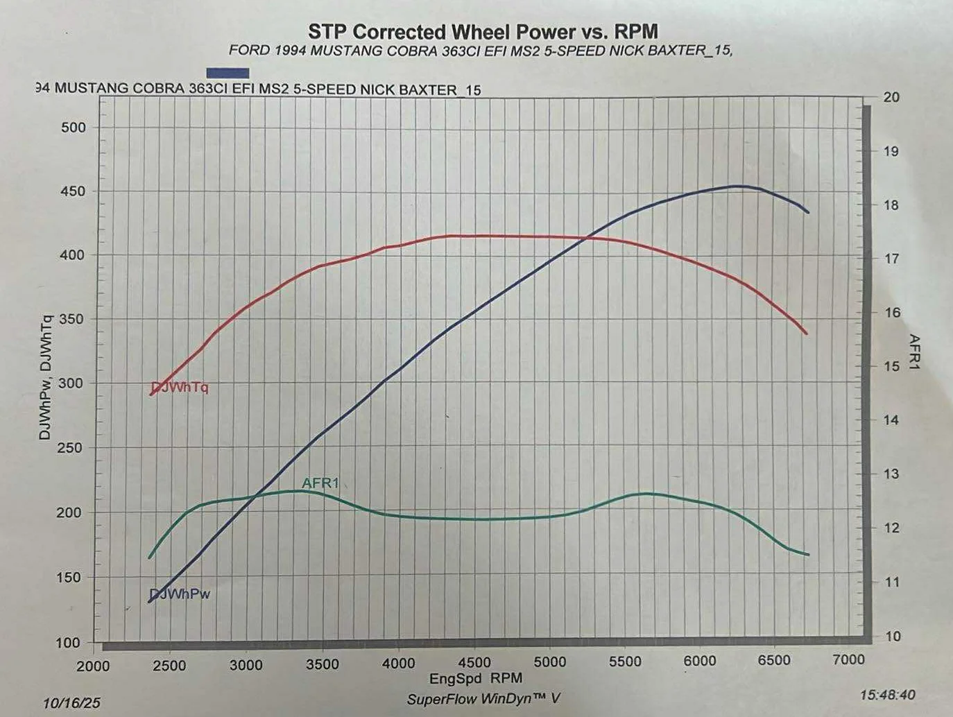

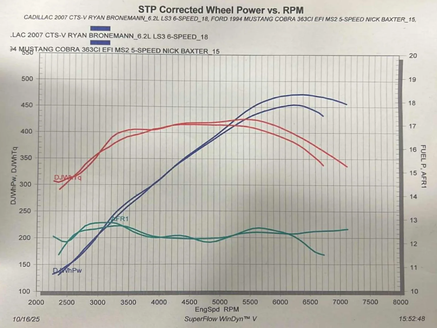

I have a Dart block, forged Scat crank (internally balanced), forged H beam rods, Bullet forged pistons from Vigilante, Ed Curtis cam, AFR 205 heads, Morel linked hydraulic lifters, hardened pushrods, 1.6 roller rockers, and the Edelbrock Victor EFI intake, and 80 mm Accufab throttle body. 1 3/4" Mack longtubes, 2.5" Prochamber, and 2.5" cat back. My rods and pistons are not lightweight, and I've learned that does rob power. After my engine refresh, I had the rings gapped for boost, and my compression is 11.2:1. I do plan on a Vortech at some point, but for now its N/A and on E85.
Finally just made it back to the dyno today where it made 456 rwhp, and 419 rwtq. As you can see in the graph, the power drops off at 6300, because of the Victor EFI intake. With the Super Victor and elbow it would make more power at higher RPM, but when are you running above 6300 on the street just daily driving? To each their own, but i like my torque curve for the street.
For :poo:s and giggles, my tuner sent me a graph overlaying his 6.2 N/A LS (376 CI) from his 2007 Caddilac CTS-V. He just rebuilt it with a bigger cam than mine, but with ported stock heads and intake. For being the almighty LS with more cubes, its not much more powerful. However, goes to show how good the stock LS heads and intake are. He is obviously the higher of each the hp and tq.

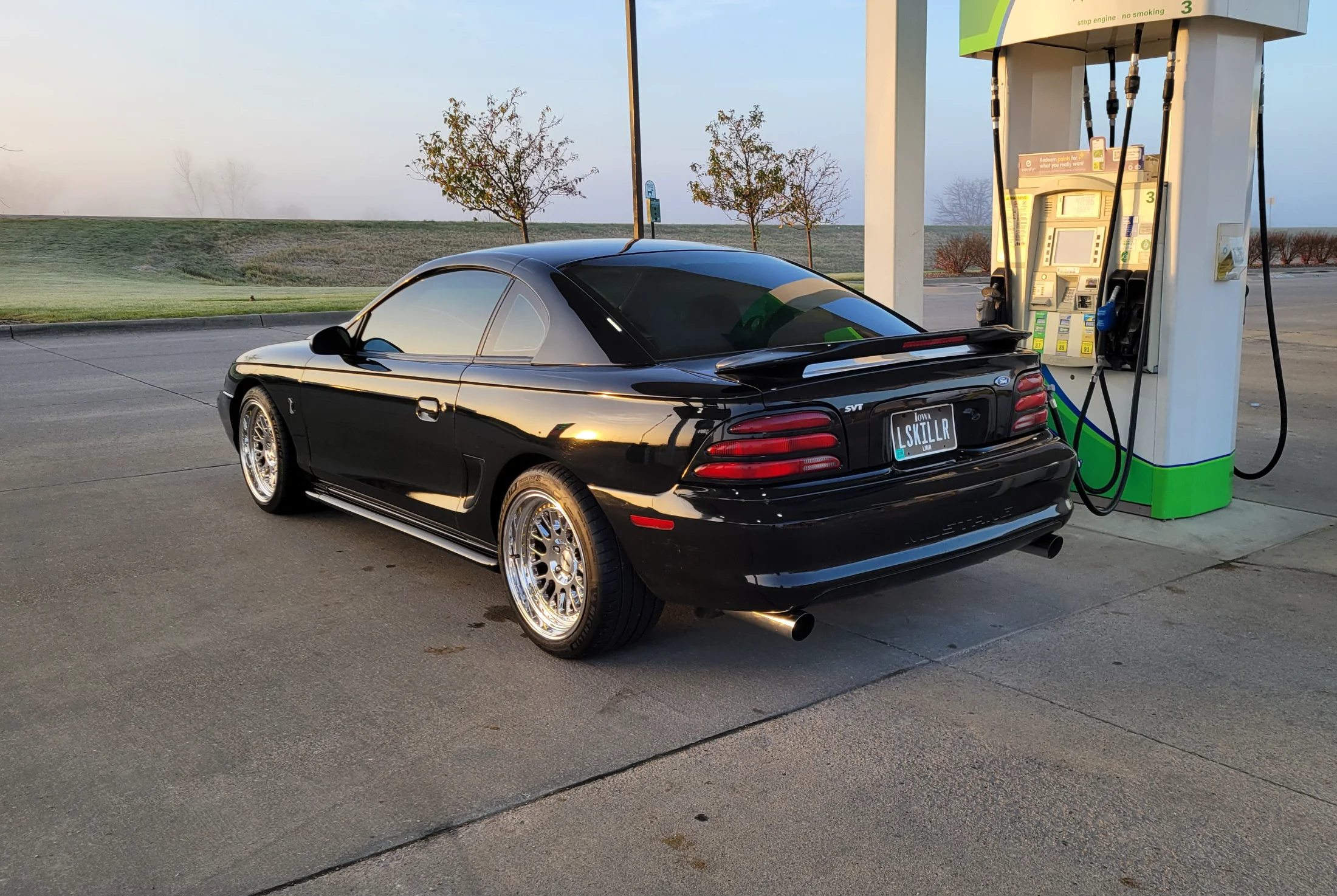

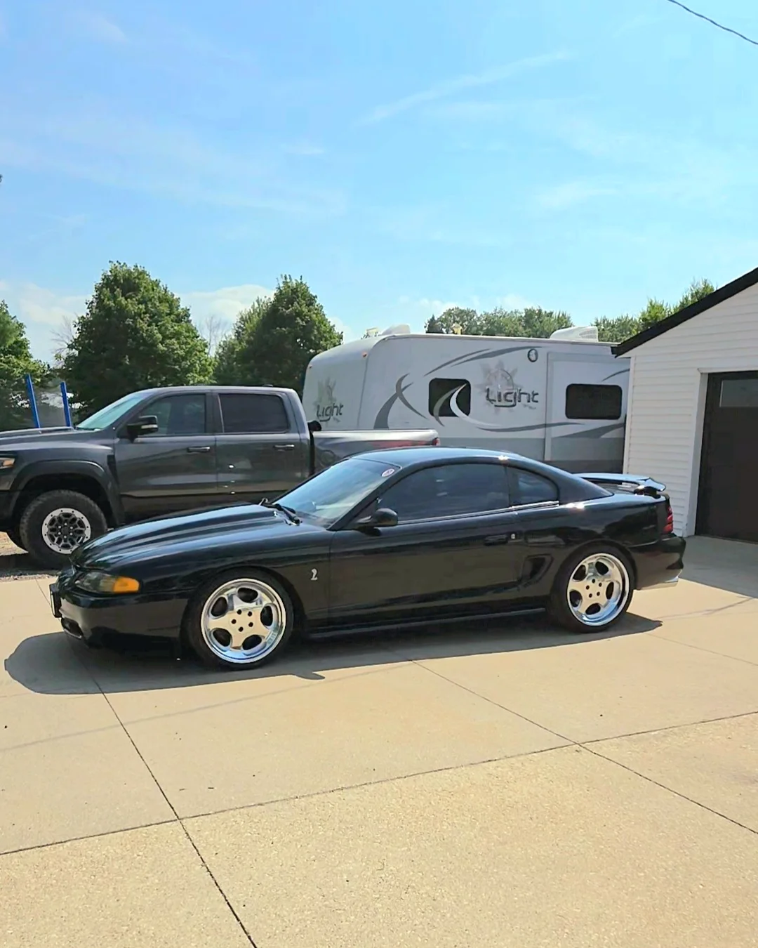

Well folks, Im still around. The most noticeable change as of late is the purchase of 19" Makers Forged 2 piece 94-95 Cobra wheels. I set my ride height accordingly, but need a stiffer pair of rear springs to keep it this low.

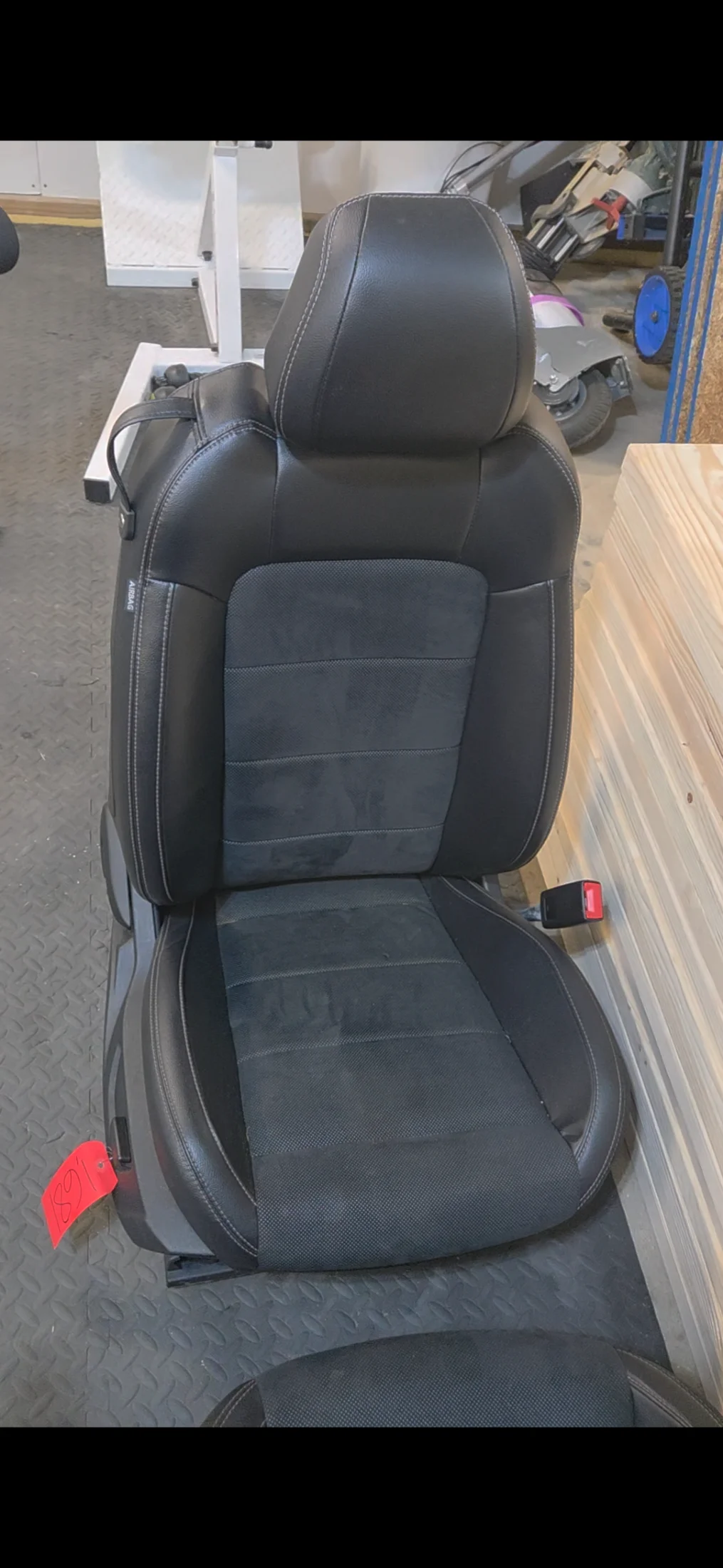

But before I dive into all that, the charcoal Terminator seats in an otherwise all black interior was starting to bother me. Turns out the ones I had were a very sought after 2004 only color combo, so I was able to sell them and bop over to my local Mustang parts slinger (Midway Mustang in Dewitt, IA) and pick up a nice set of black leather/suede 2021 seats. The bags never deployed, so I thought it to be a good score.

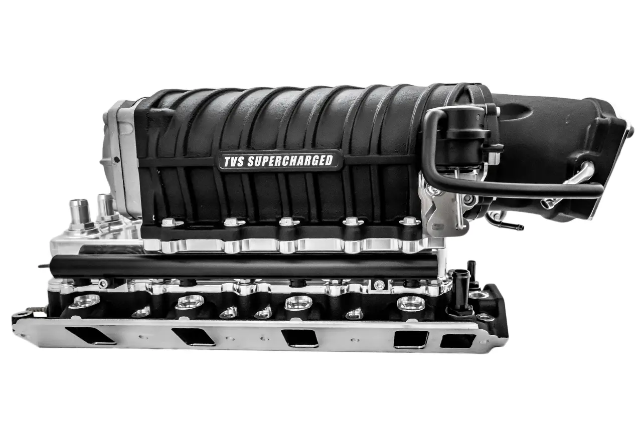

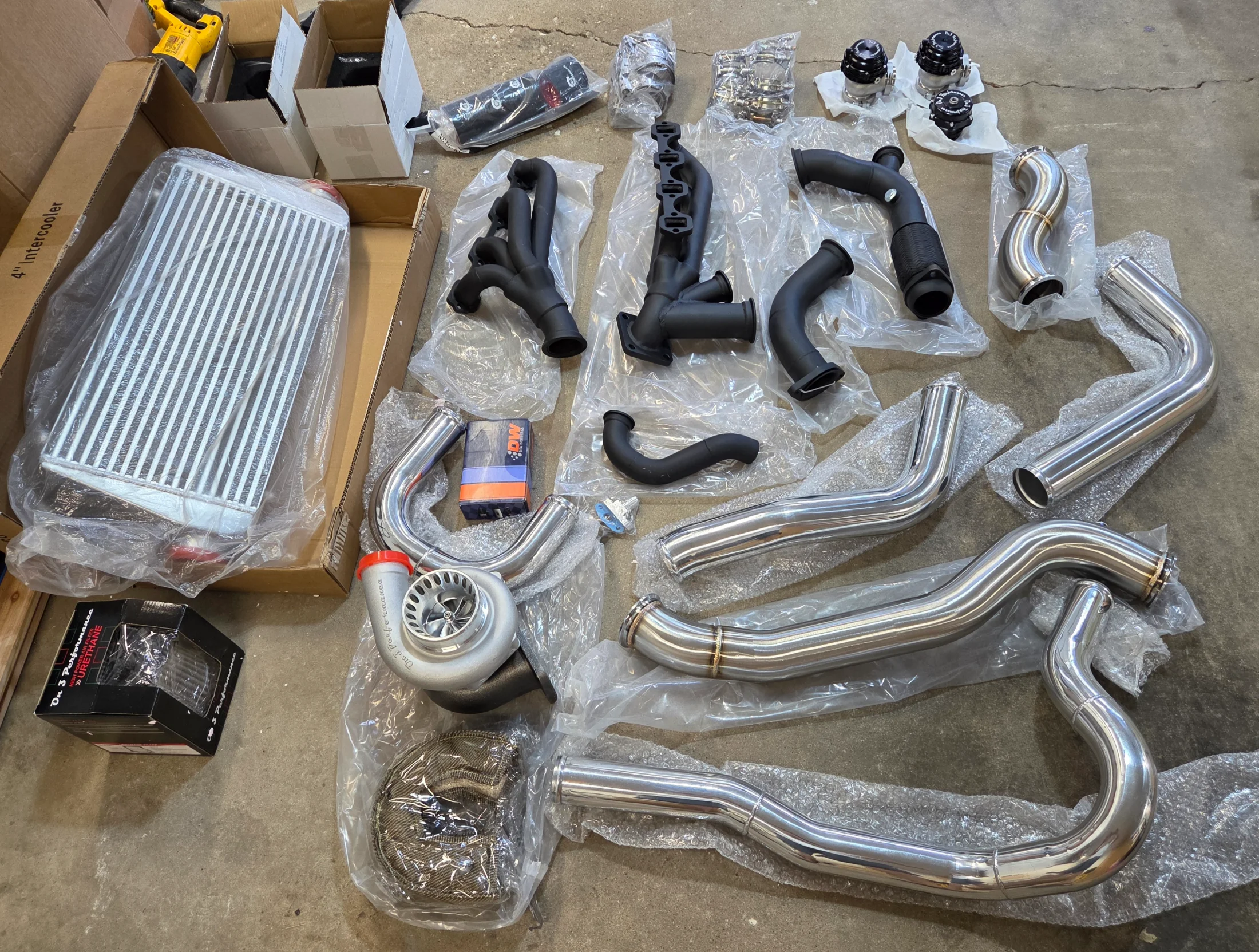

My choice to go turbo was for a few reasons, not just to be fast. Daily driving a TRX made 450 to the tire seem like an everyday Sunday drive. Also at the ride height I want to be at, my longtube headers are like 2" off the ground. Lastly, I want whistle and blow off noises, and the On3 turbo kit was half the price of the Procharger intercooled kit with their lowest trim blower. I am at 11:1 compression, so an intercooler is a must.
I went with a 67/66 for quick spooling, and on 7ish lbs will hopefully be around 650 at the tire. I think thats all the TKX is going to like, and I want my set up to last. Ive seen too many guys on here end up on permanent jack stands from turbos, and I dont want to be one of them.
