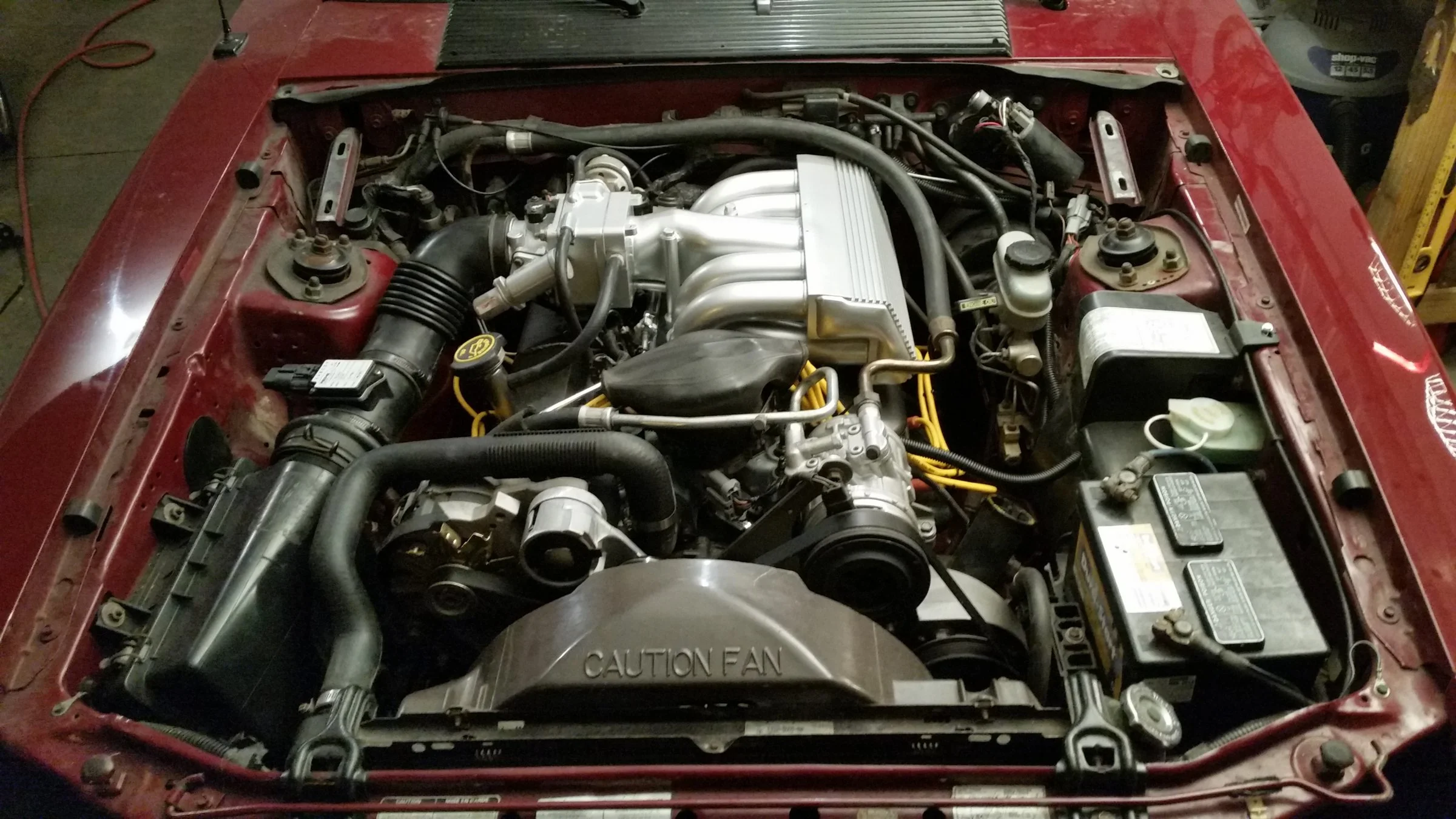

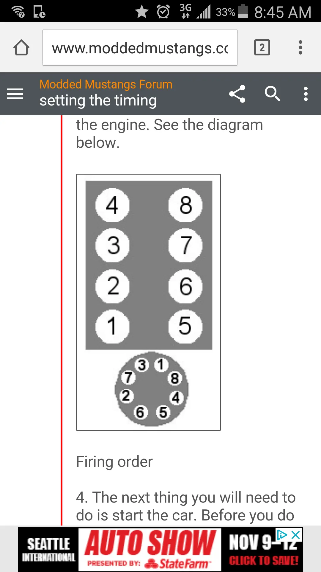

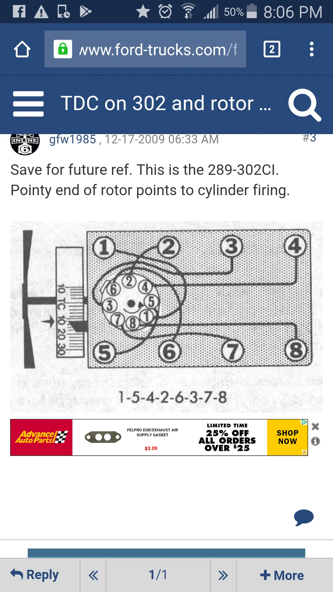

Fell back a few pages... I finished bolting up my MAC H pipe last night (which fit like sht), and installing new oxygen sensors. I put two gallons of gas in the tank (its about to sit for 6 months, so no need for several gallons), and gave the key a turn. To my surprise it started right up and ran like complete :poo:, lol. I thought I had the distributor off a tooth, and proceeded to advance and retard it, effectively never having the car start again after that. Once I could smell gas, I stopped trying. Did a little investigating and figured out I ran my spark plug wires for a 351W firing order. Im so smrt! Tonight I will re route them, restab the distributor, and we should have fire! Its friggin loud, but I will make a vid with my phone outside to capture it without being complete drone sounding.
Ah, turns out the pic I had stumbled on was from a truck forum. I just googled 302 spark plug wire routing, and didnt give it much thought.
A simple rerouting of a few spark plug wires, and viola.

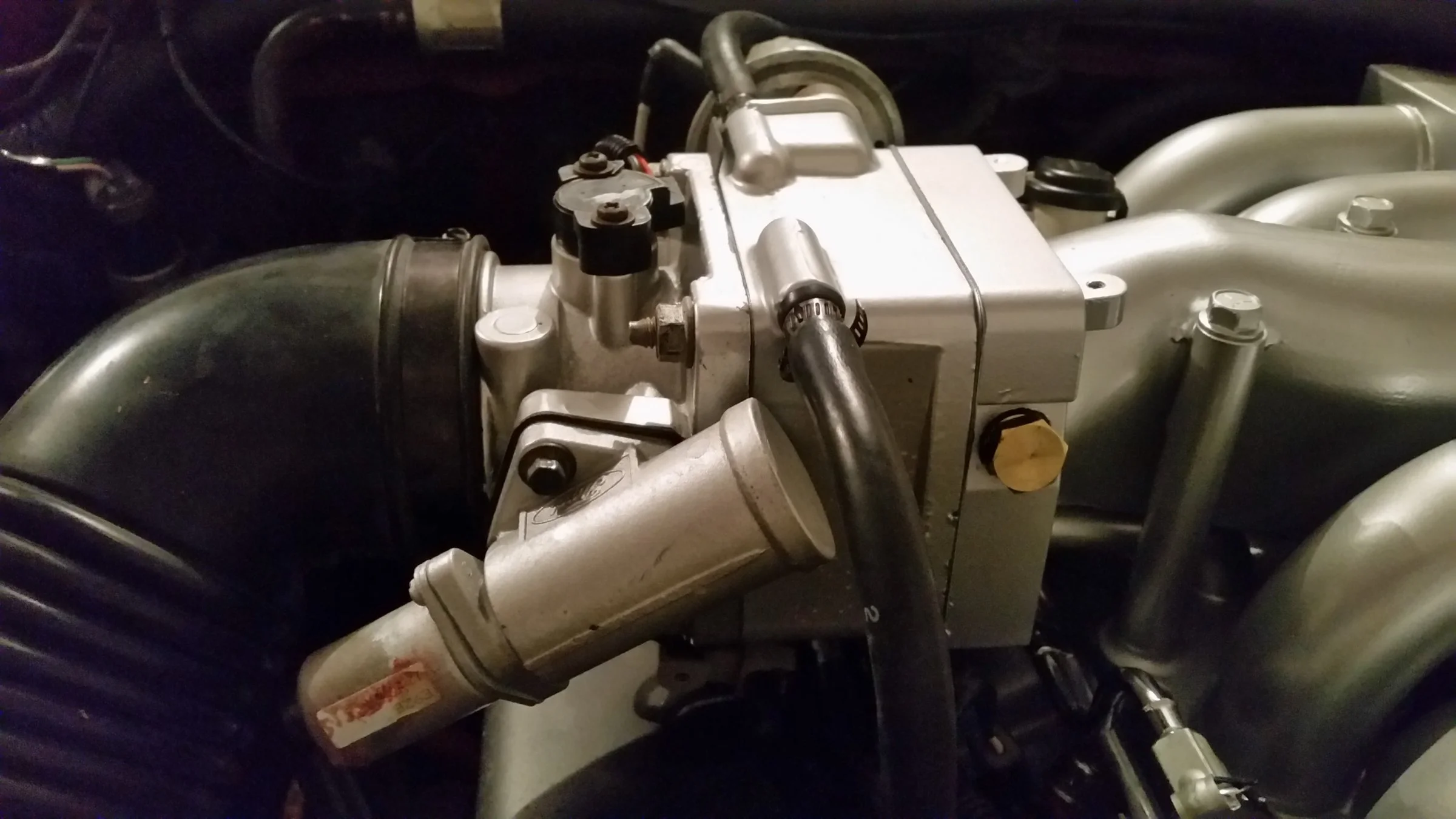

So I made another dumb error with my valve cover breather tube. I forgot to drill the Explorer TB for the tube off the stock TB. The EGR spacer had a port, so I just hooked it up there and didnt think much of it.

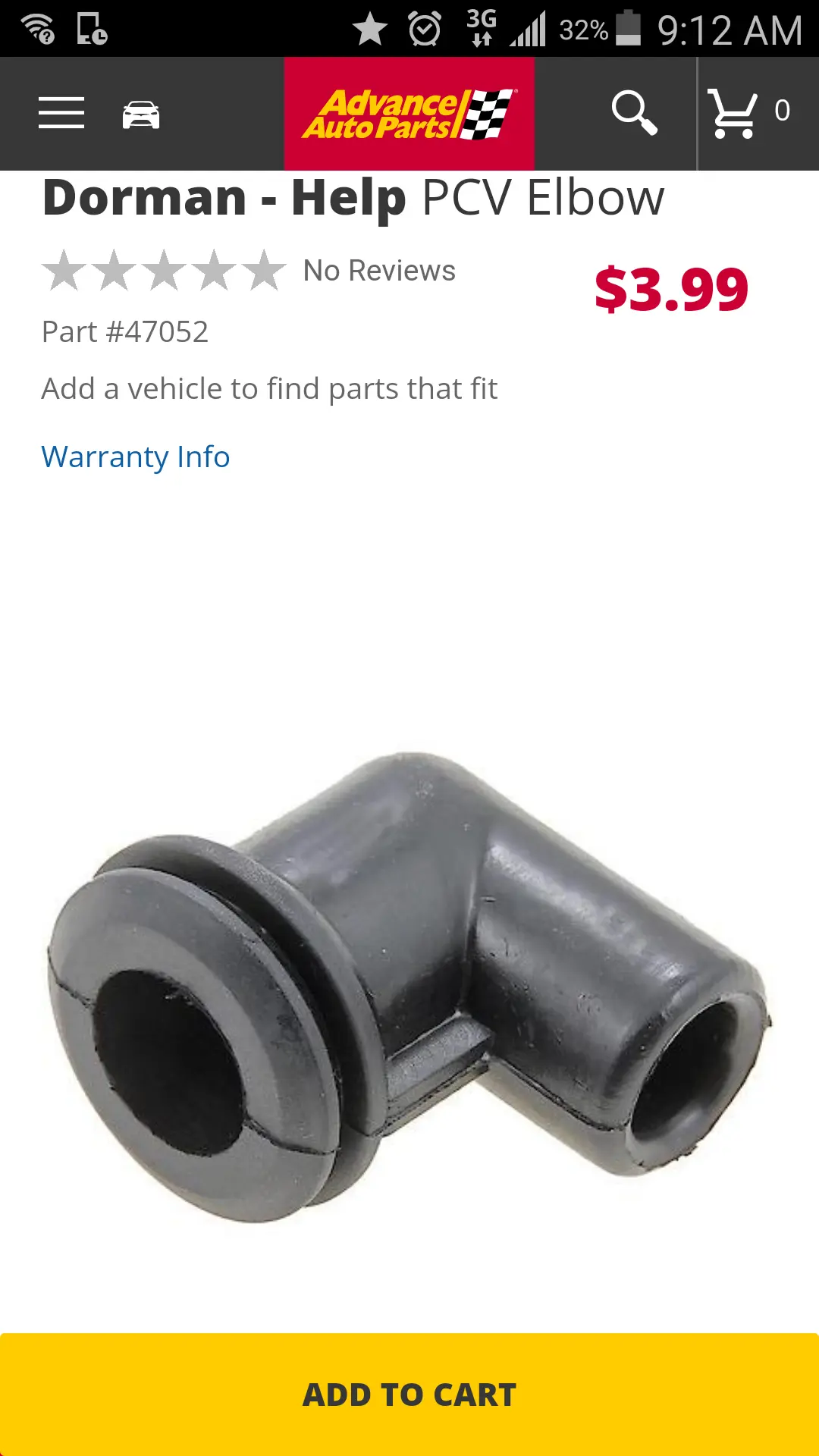

Turns out hooking it up behind the TB blade instead of in front of it makes a big difference in how the car runs. I found a brass plug for the EGR spacer port. Since I already threw away what was left of my stock throttle body like a moron, I am going to plumb the breather line to my intake tube like the Explorers did. Found a little grommet type deal to use for cheap.
I will have that tomorrow, and will get it installed tomorrow night since I can take it indoors and do it in the kitchen. Still need to figure out how to get a video to upload here.

I really appreciate it, but I am going to try this other route. I can mount this elbow to the underside of the intake tract, and that PCV tube will be a little more hidden.

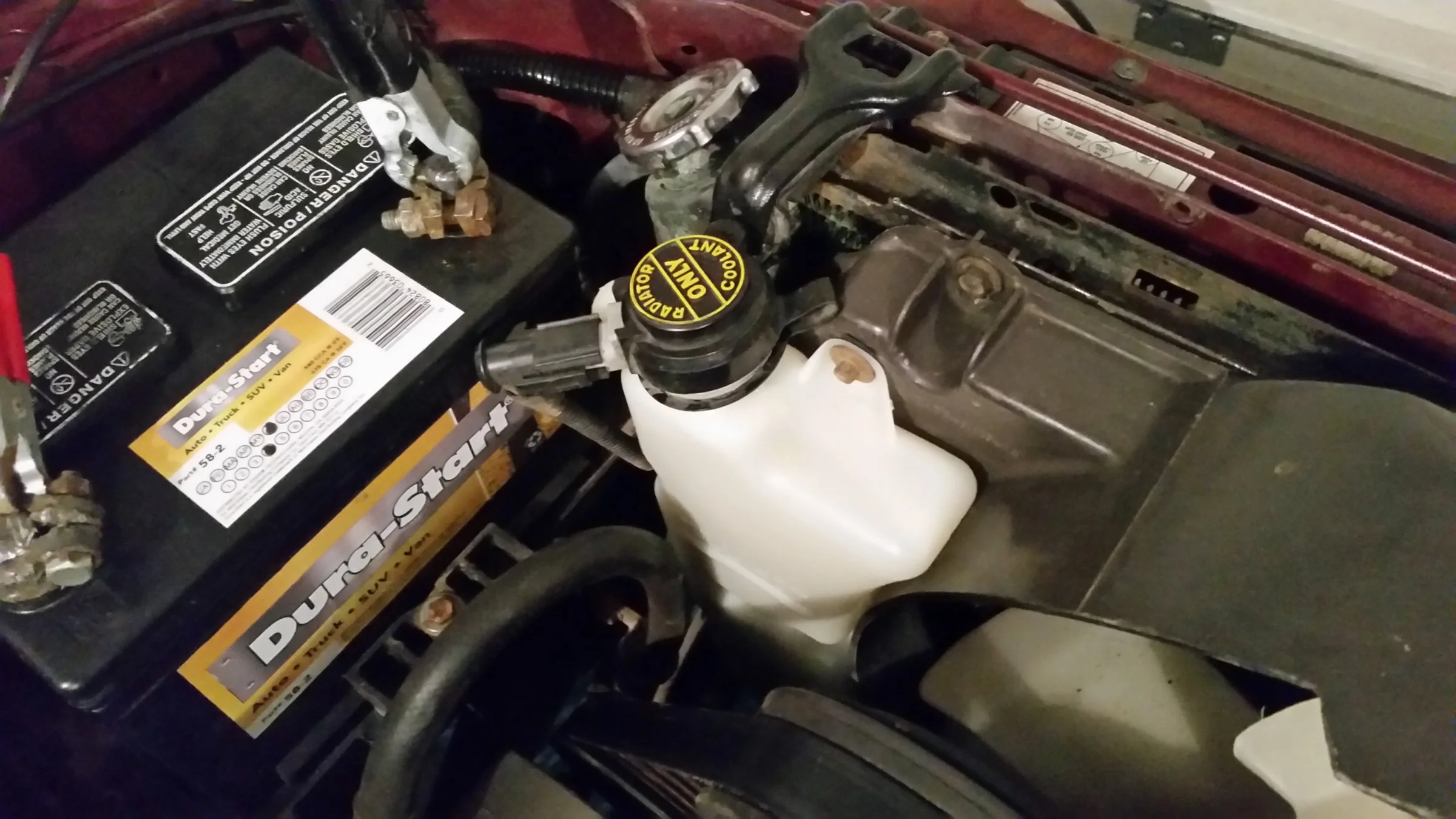

As far as the car, I got my coolant reservoir swapped out with the new one, and plugged the threaded port in the EGR spacer. Aside from the made in China sticker, the reservoir seems every bit as nice as the stocker.
