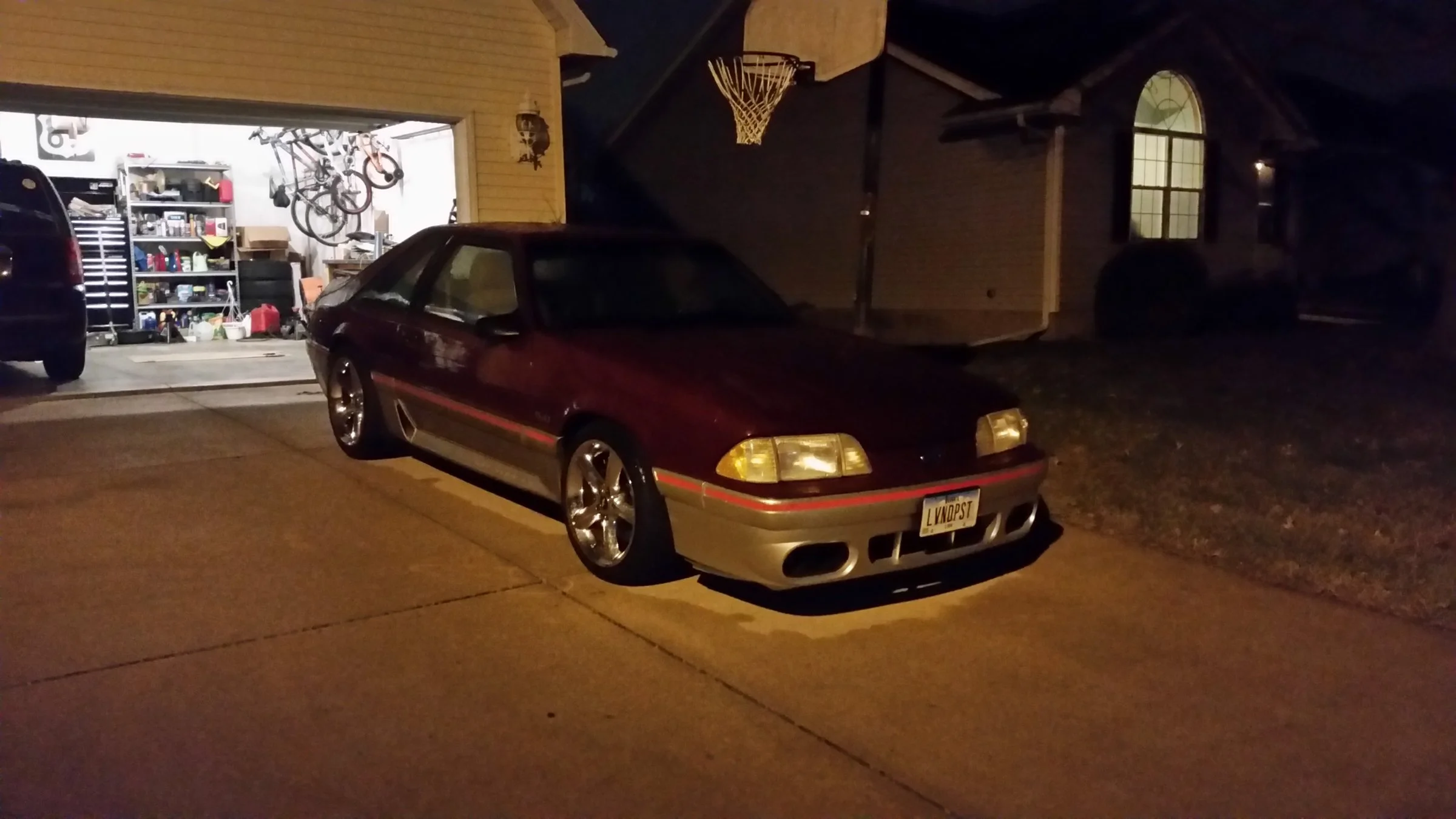

There she sits, out shivering in the cold, too damn heavy for my wife and me to get up over the bump into the garage. Next time I'll just stink up the garage versus pushing her out to find that she wont start.

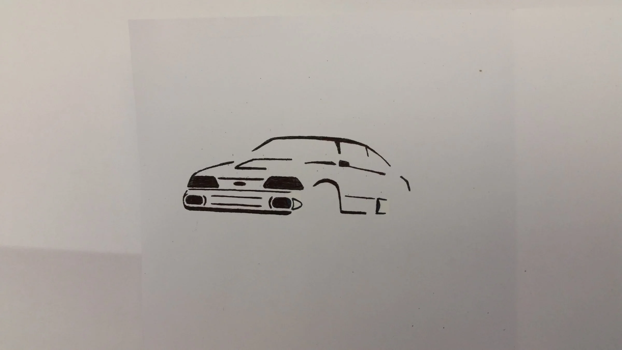

Two things:
1) Porch pirates better not steal my TFI module that is waiting for me to get home!
2) A buddy of my bought a little etching kit to make those metal cups and mugs with pictures engraved on them. I drew up this to represent my car with the Cobra bumper and '83 scoop while bored at work this morning. What do you think, should I have him make me one, or revise anything about it.
