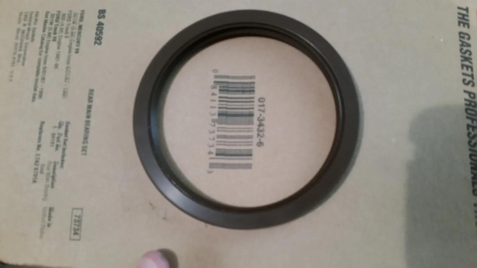

Ok, no more tears. I need a new TB gasket and the Accufab TB and spacer is installed. While I was digging around looking for an extra TB gasket, I found this.
Good thing I just bought and installed a different one. Its no @tannerc91gt axle length error though, so Im ok with it. Anyone need a new rear main seal?

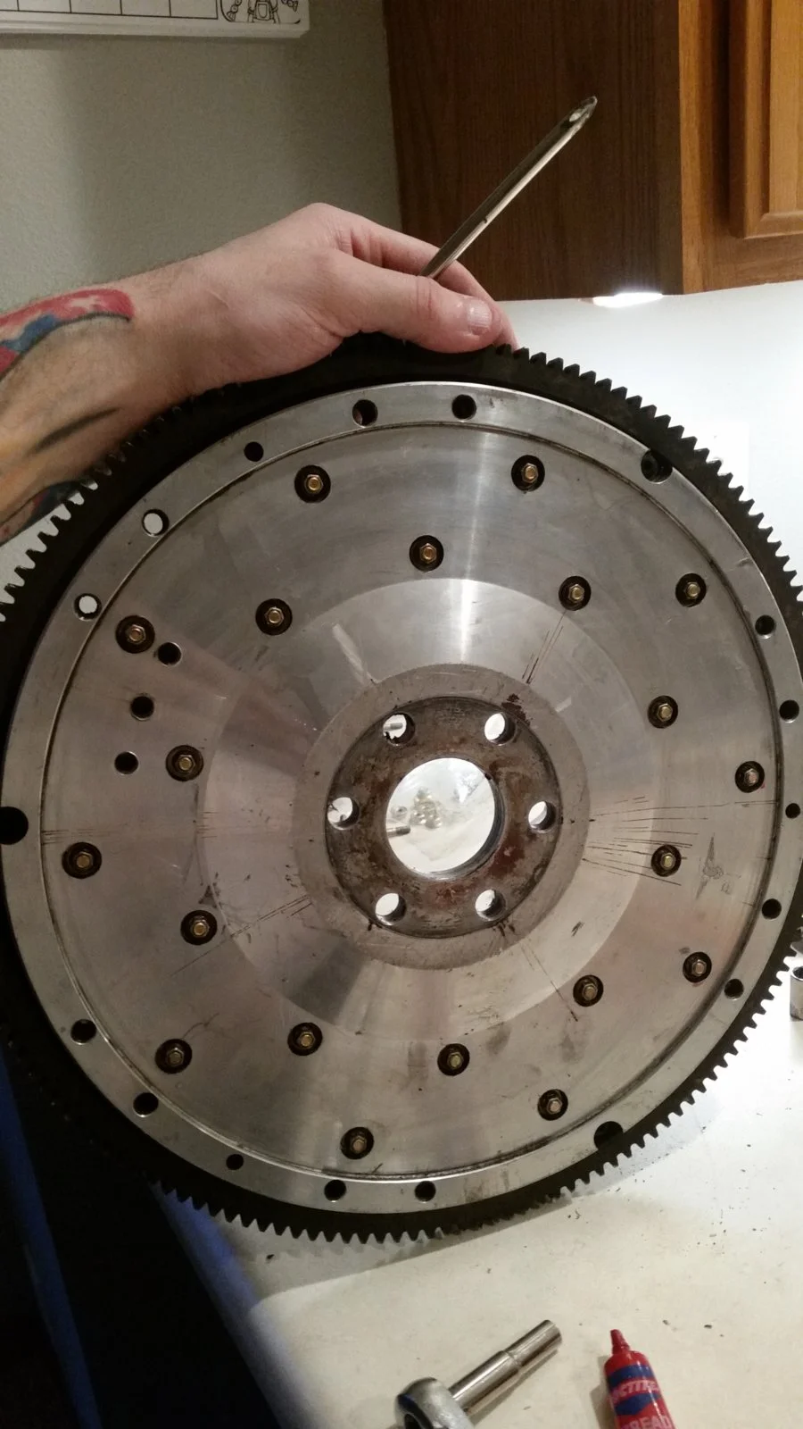

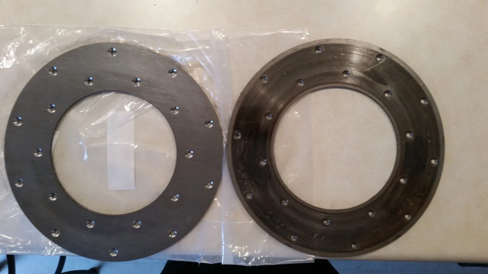

What I did manage to do was change out my flywheel friction surface plate. Had to do that in the kitchen to be able to watch my kids as my wife prepared for the bday this weekend. She is the type to go way over the top...
These little bastards called for 5 ft lbs... To me that means red loctite and snug with a small ratchet. The heads of the screws are phillips, so you clearly arent meant to be able to over torque them anyway.
