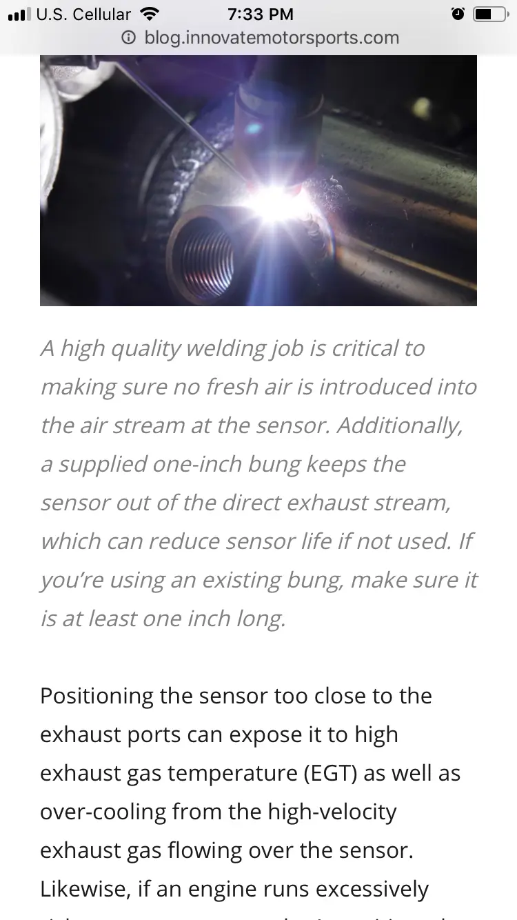

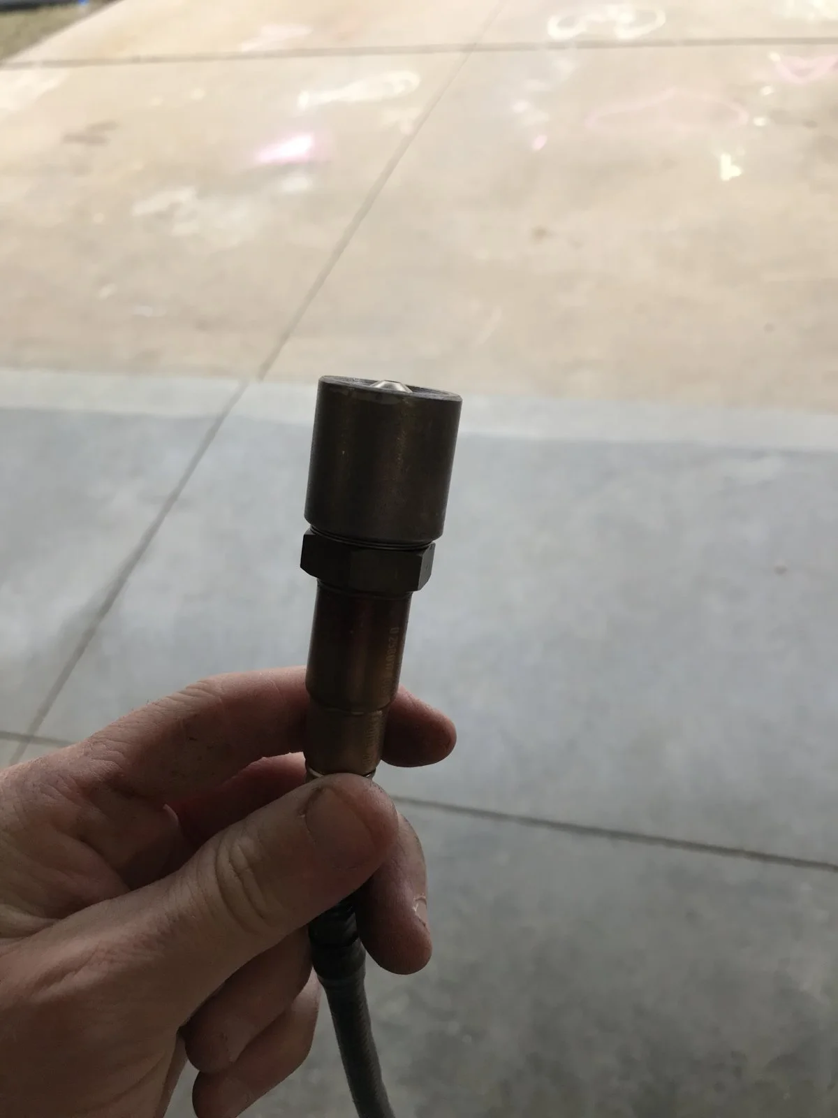

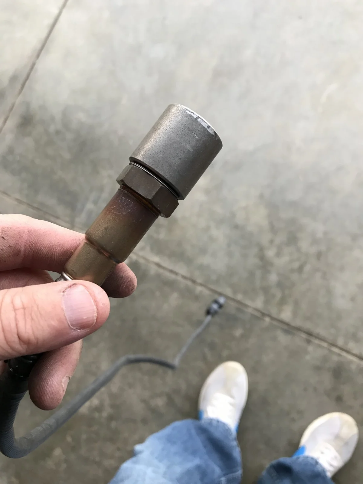

Hey @a91what or @CarMichael Angelo , I am welding the bung for my wideband on my H pipe. The bung seems a little “deep.” Should I cut some off of it, or are wideband sensors supposed to be a bit out of the actual exhaust stream? The sensor is essentially flush with the end of the bung when screwed into it.
I still had the h pipe off my car when I installed the o2s in my lt headers, the end of the sensor sticks out into the stream, uncovered.
the bungs were already installed. :shrug:
Right, and my stock O2s are that same way. This is for an aftermarket wideband sensor through. Not sure how they differ. Still haven’t welded it yet, got distracted by a two year girl wanting to come out and play with Dad.

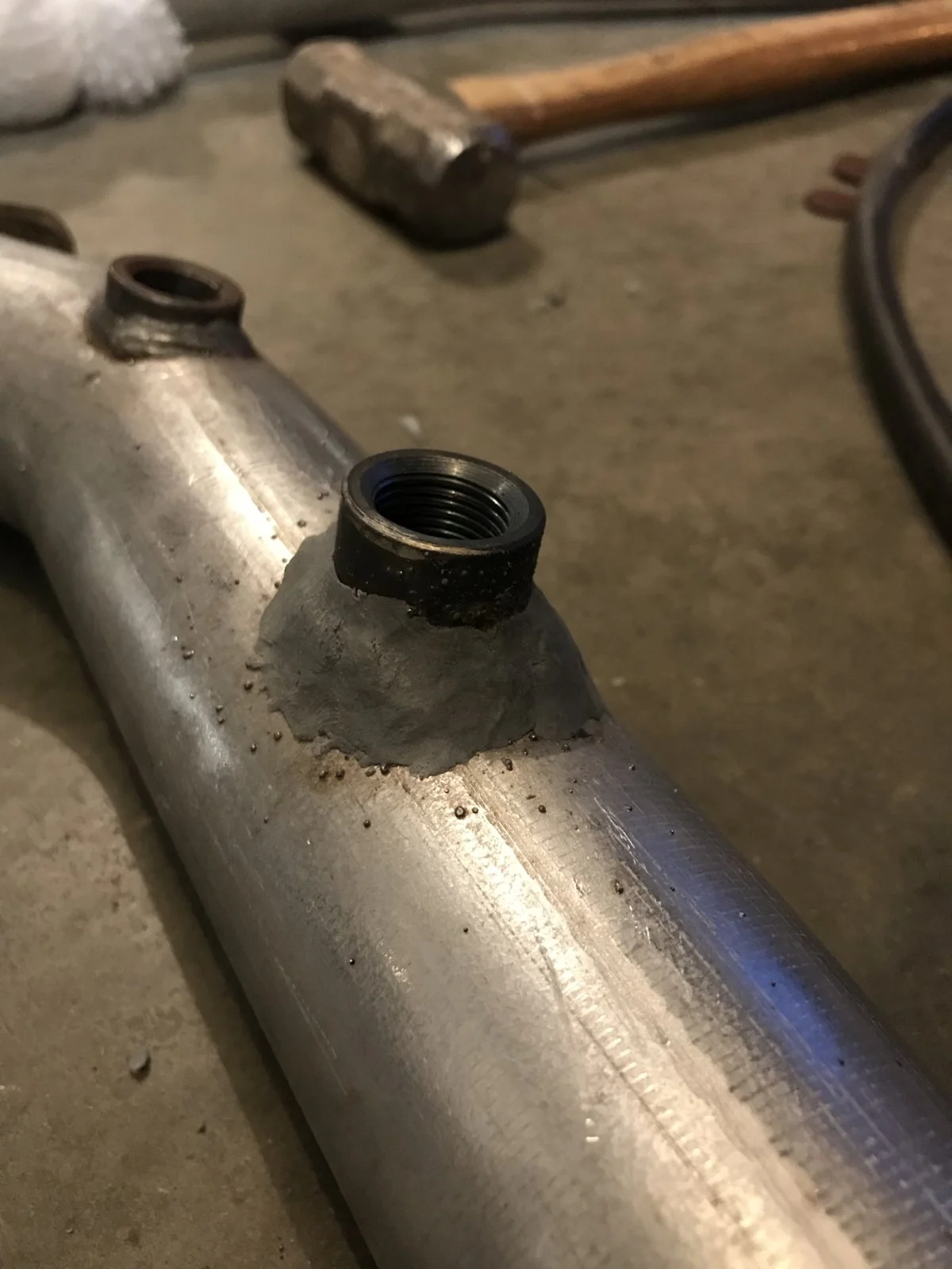

Not risking anything here. I actually got a good weld all the way around, but took it a step further and put high heat exhaust epoxy over the weld. I used this stuff to fill the air tube on my old H pipe, and couldn’t get it off with a hammer. Good stuff.
Not good stuff....depending on how close that is to the heat...it will fail.
If you needed it,..there was something wrong underneath....if the weld was suspect..time for one of two things.... *hint......High heat Goop ain't one of them.
1. Get yourself a freakin bottle of argon/mix gas, a regulator, solid core wire,..and convert from flux core wire. ( the end result will be so pretty,..you'll thank me)
2. Spend more time behind the trigger.....
I should have taken a picture of the weld(s). Obviously not super pretty, but I was happy when done as it was much better than some of my previous ones. The epoxy was “just in case.” I am confident all is well, buddy ol pal.
