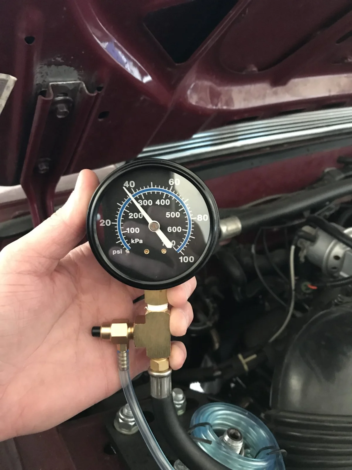

Welp, I have 39 lbs of fuel pressure at idle at the schrader valve. Went to swap my wideband and factory O2 sensor as Steve had suggested, but my O2 sensor is already seized up in the brand new BBK h pipe. It threaded in by hand, and I snugged them with a wrench, but is coming out really hard. Headed to advance for some anti seize so when I get this b*tch out I don’t f*ck myself again.

So I learned two things tonight. 1) Never be too lazy to install O2 sensors sans anti seize. My threads on both the bung and Motorcraft O2 sensor ended up fubared getting it out just to interchange with the wideband. I did swap the two threading them super lightly, and the wideband showed 13.x to 14.x at idle. 2) @a91what knows his .
