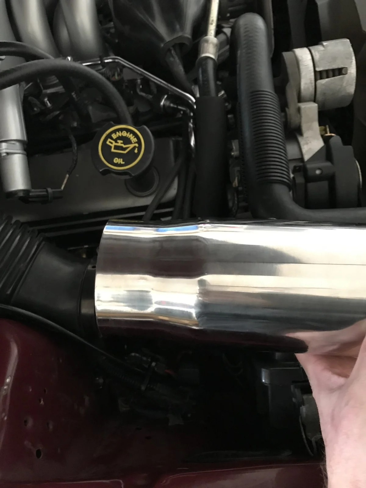

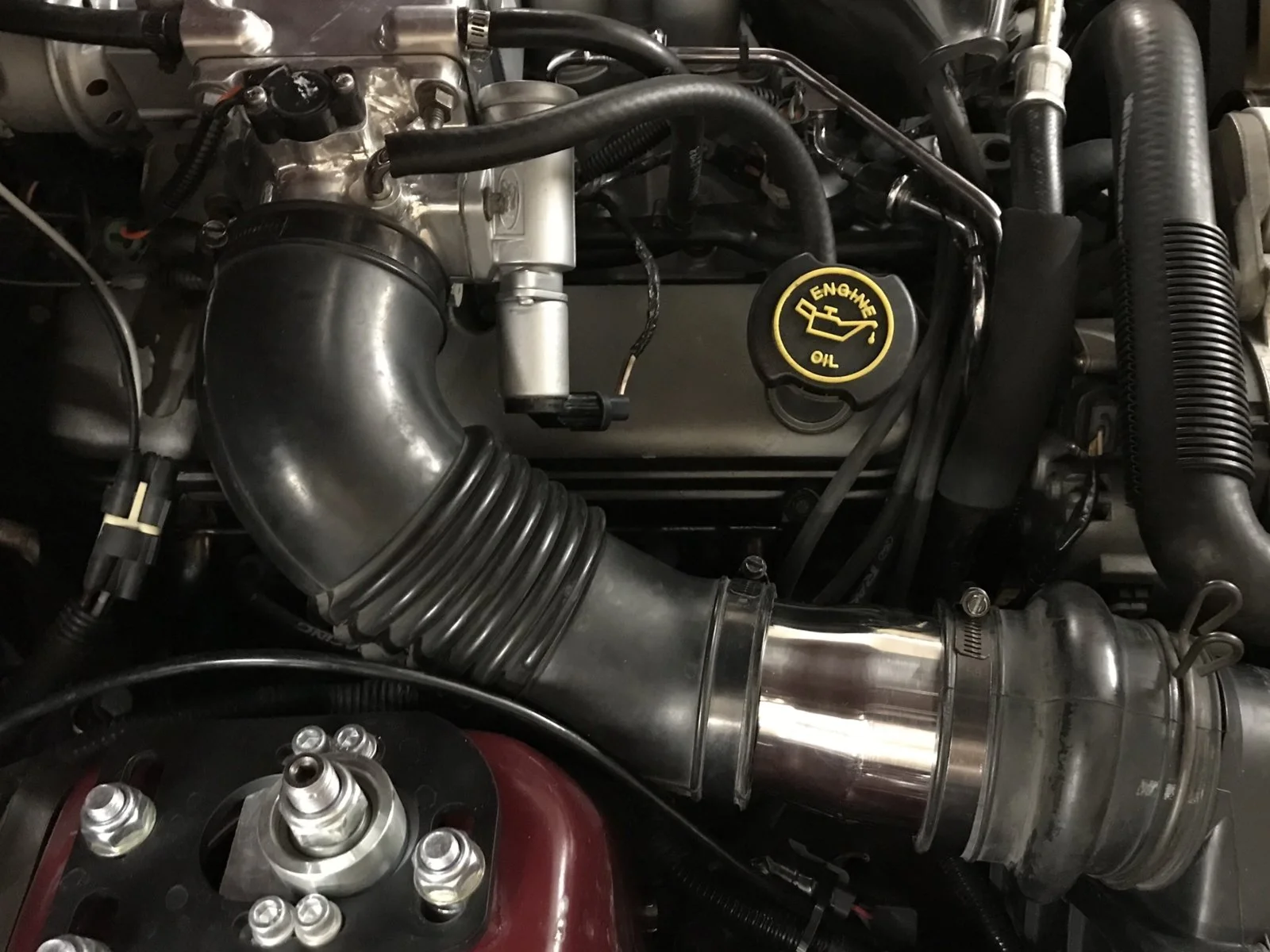

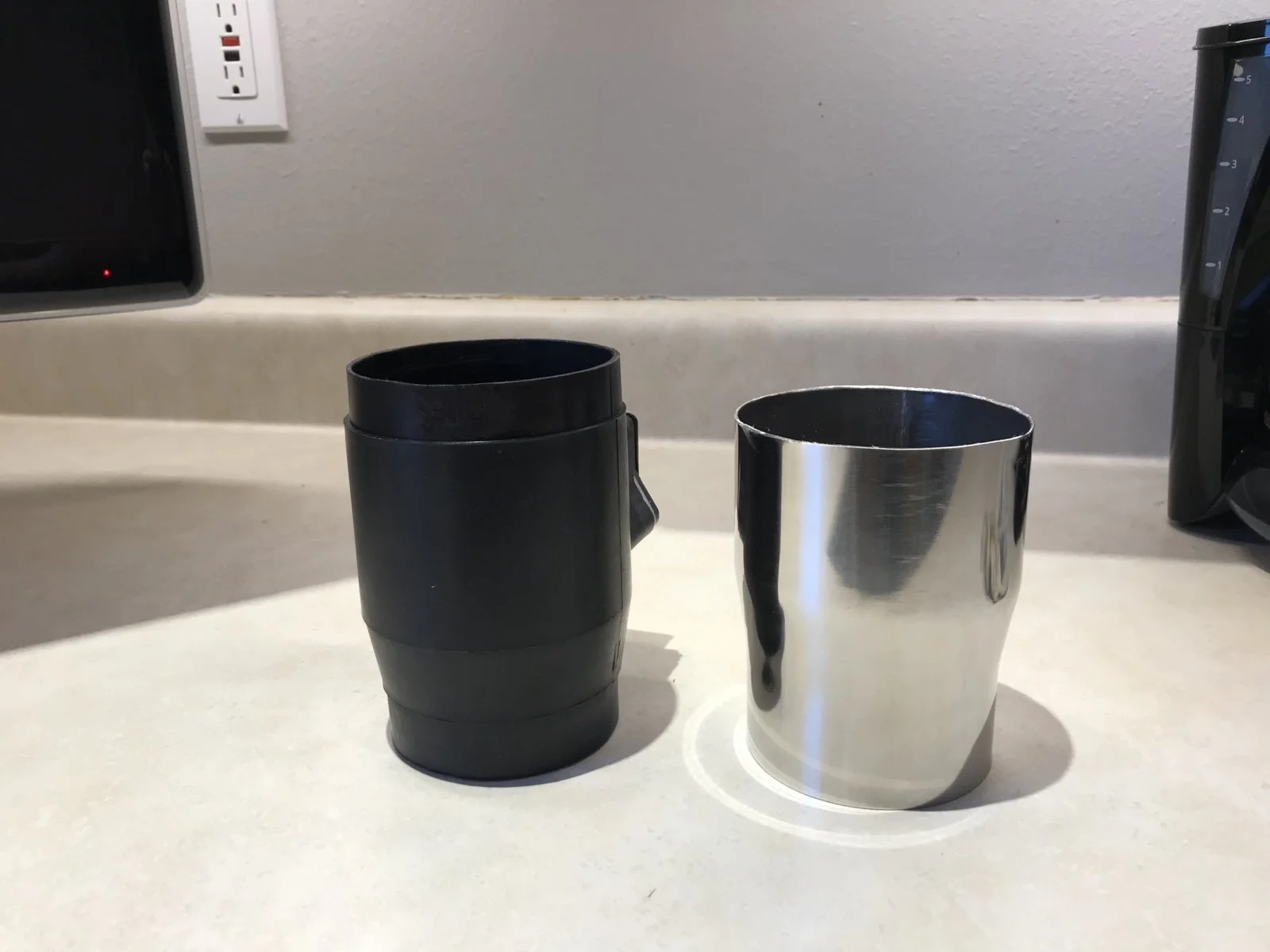

Little bit of small fries stuff tonight. I needed something to go in place of my MAF. Something 3” at one end, and 3.5” at the other. It dawned on me that I had bought two truck exhaust tips with the intention of cutting them down, but abandoned them after phucking up the first one. So I had one good one to use.
Two sawzall blades later, it was cut. Little bit of clean up work and it’s in. Can’t say I like the stainless steel look (even though it matches the Accufab TB), so I will be scufffing and painting it.

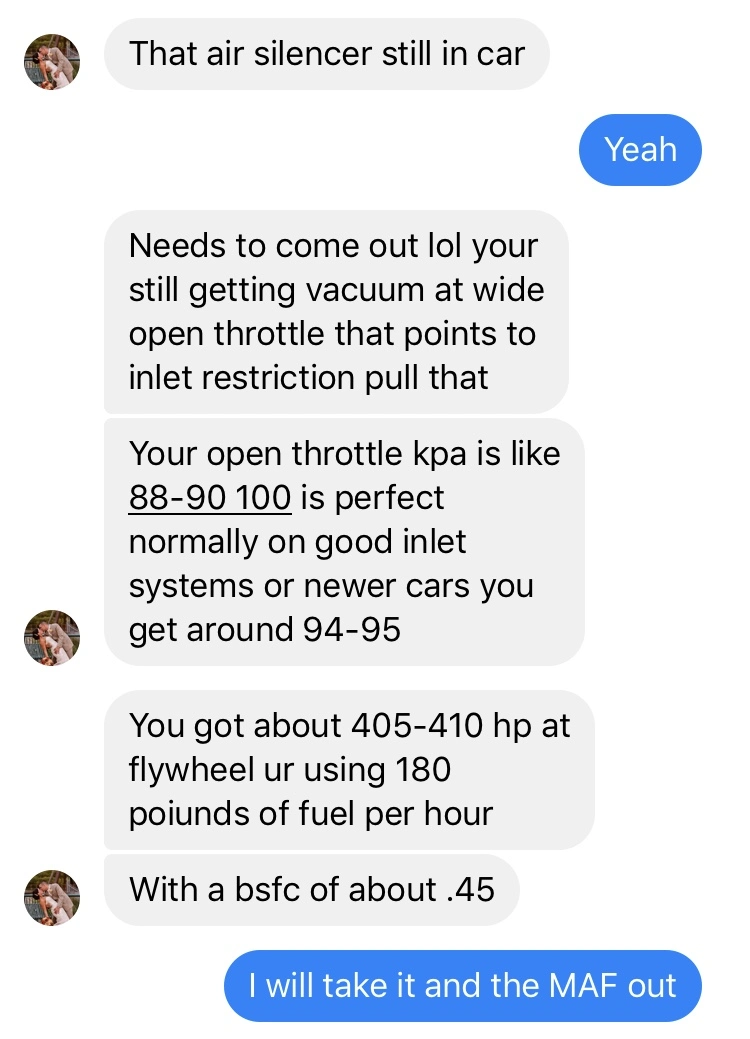

Man I tell ya. I have learned a bit about myself lately. Maybe it’s because I havent slept well the last couple weeks. Maybe it’s because I am learning a new operating system at work. Maybe it’s because I am just a crotchety old “get off my lawn” kinda old man deep inside. Not the @CarMichael Angelo type (he can run and even build a computer), but the type that thinks these computers these days just make life harder. Who needs them???? (In my best angry old man voice)
My local tuner is being a great guy, going above and beyond to help me. Even when I’m not asking him to. He messages me, asks me questions, tells me to go try this or that. But I tell you what. I downloaded Tunerstudio, he is sending me files to try... You think I can get the :poo: to work on the laptop I acquired? Hell no. The download is right there in “My Documents” on the computer. You think Tunerstudio can find it? Nope, like it doesn’t exist, except I’m looking right at it.
Told my guy he is going to have to keep coming over and doing it in person when he has time. I can be patient. I’m not about to sit and waste his time when I can’t run a computer worth a f*ck.

I am taking the car to him after work tomorrow and leaving it with him for the weekend while I go out of town. He said he will have it all ironed out for me by the time I’m back on Sunday afternoon.

I just want to see excellent dyno numbers and repeated posts of him enjoying driving the car
Thanks man, that’s all I’m after as well. I love wrenching, and building things with my hands. But a guy has to know his limitations. I want nothing to do with the tuning. Many of you enjoy it, I simply don’t. So fingers crossed next week it’s finished and ready for me to finish the paint and install my subframe connectors.
PS, he seems to think it will make decent numbers for the combo I have. This is what he said before I had even removed the air silencer. Of course the dyno will need to back it up though.
