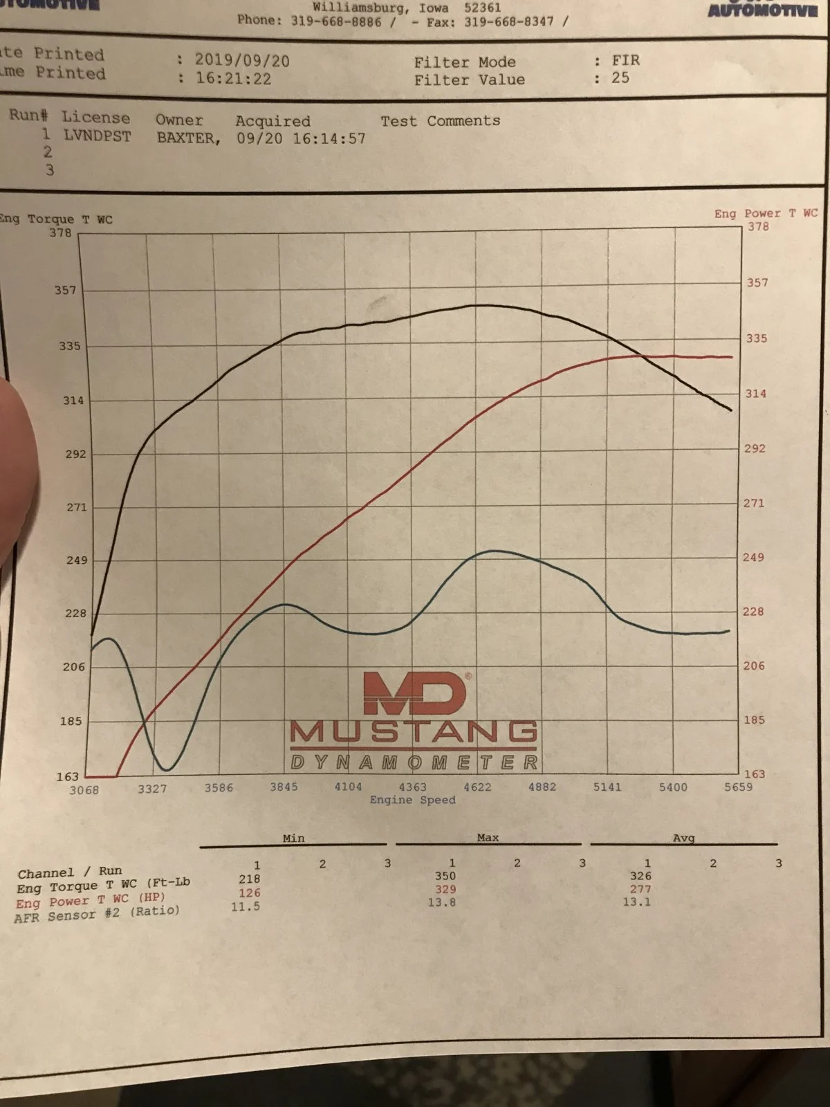

Damn good numbers. I’d be happy with those

Hmm, the graph shows max power of 329 hp, but I remember 330.2 vividly because he and I agreed it was right on a milestone and high fived. Anywho, check out that wavy AFR. Due to the AFR issue, he was only running it from 3000 to 5700 RPM. Stupid thing didn’t make power above that I’m guessing due to the rich condition. I want this engine to last, so I won’t be revving to the moon anyway.

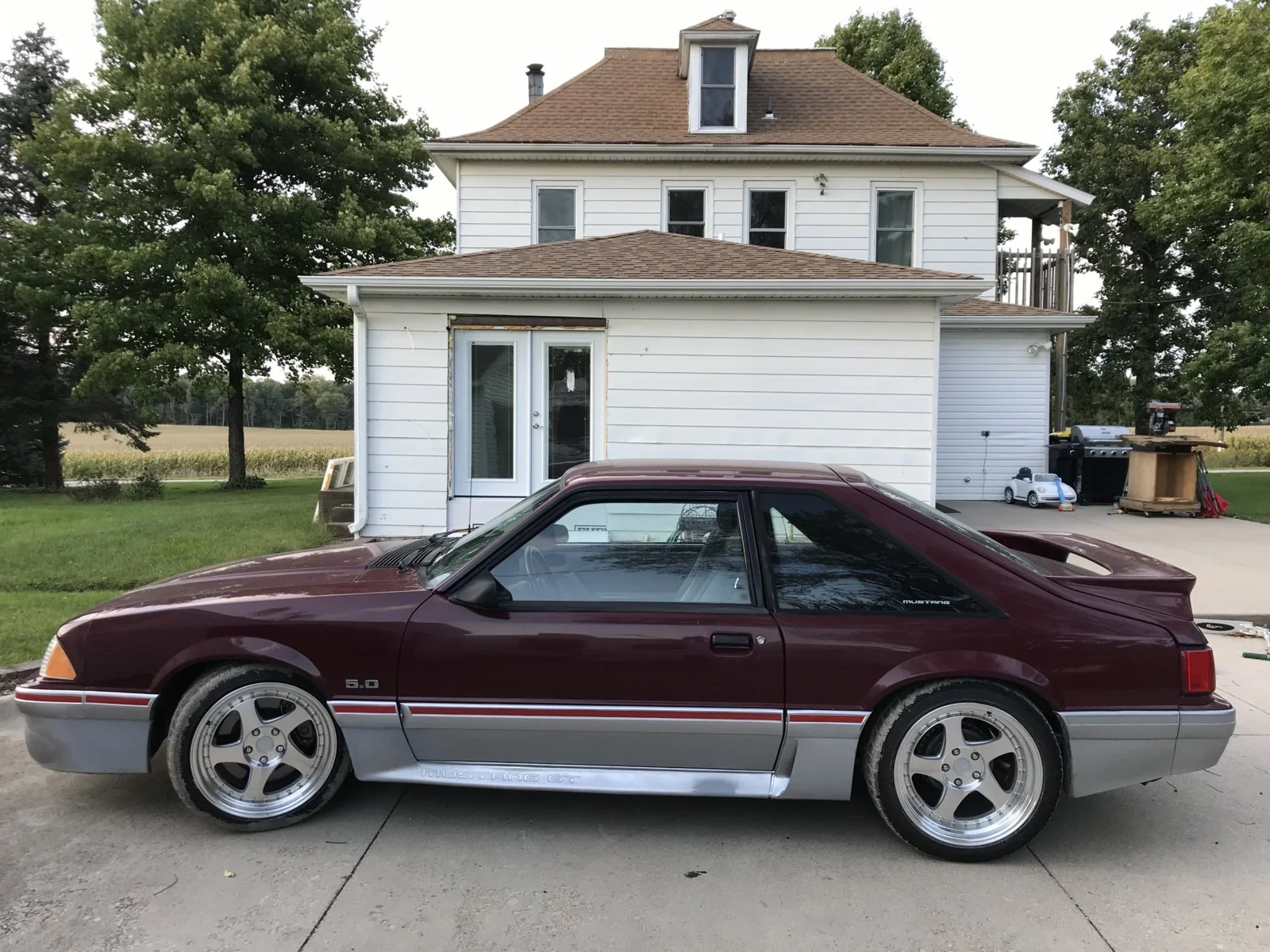

Poor ol’ Mustang. Spent years in a barn only to be rescued and then returned to a farm. I live on a paved road, but my driveway is gravel and when we get a lot of rain it has a sloppy spot. The car sits outside right now, but I have a barn... The only thing holding me back is the risk of mice.

I'm still curious to see your dyno curve when you swap to the systemax. One of the criticisms of my combo has been my choice to run an explorer intake, which I did thinking it would be better for street driving. Curious to see your numbers to see if that's actually the case

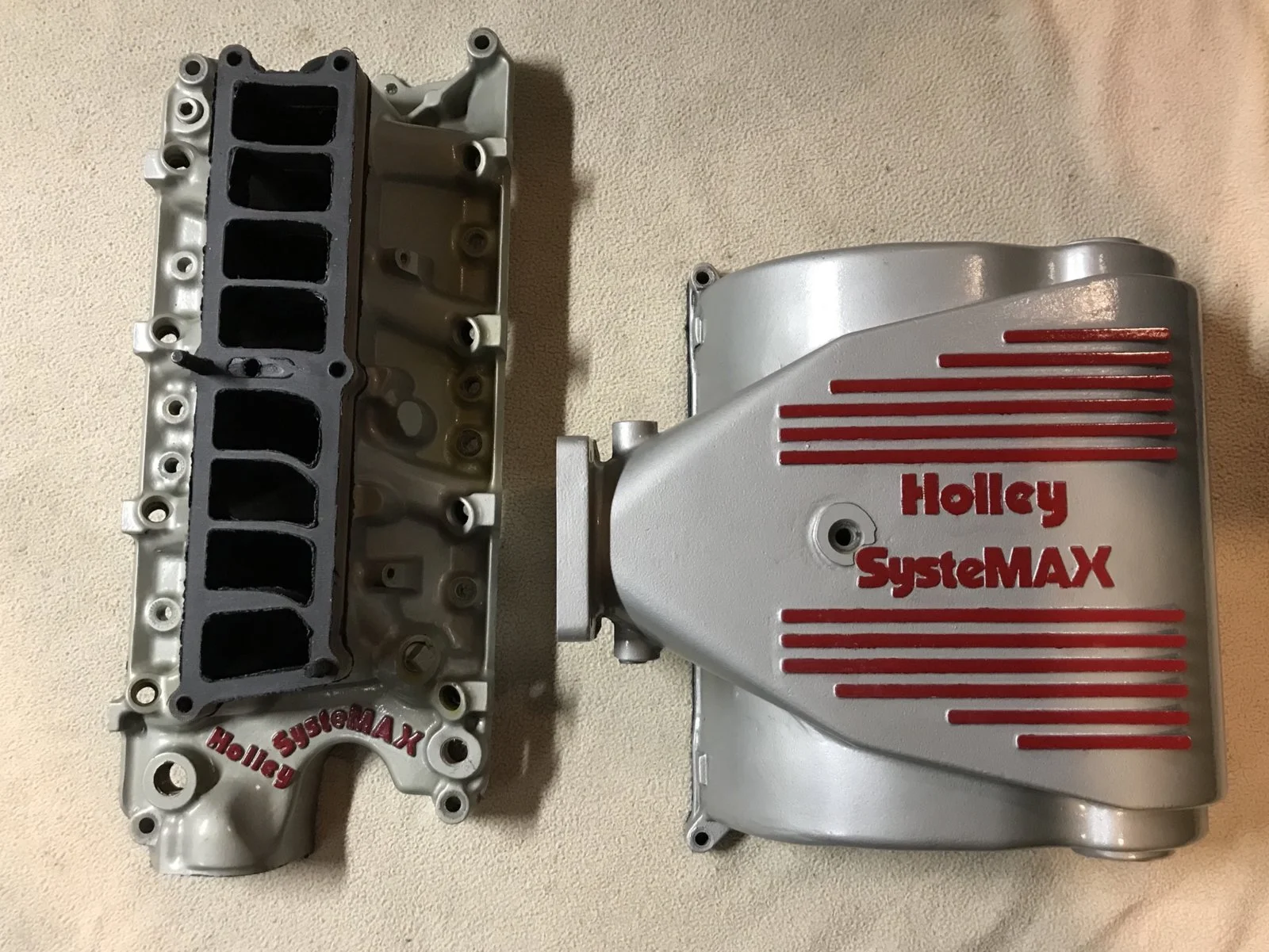

The Systemax has arrived. The great news is that it’s already painted/powder coated and all I have to do is scuff and paint it my color of choice.
It came with a BBK throttle body, Trickflow SN elbow, and a 1” spacer I don’t plan to use. May get lucky and recoup a little money, even though I got it for a great price off the start. I’m not selling the tubular intake until the dyno shows me this is worth it. Whichever gives the best curve (not just peak numbers), is the one I will keep.
Before I paint it as is, I was considering smoothing off the logo from the top. You guys just use a flap wheel and an angle grinder for that?

Yes, when I cleaned up my explorer intake I just used an 60 grit flap wheel on the angle grinder. It makes a clean and quick work of it.

Flap wheel makes quick work of it, but if you aren't careful you'll get waves. I'd take it down most of the way and then use maybe a belt sander or something to get a flat uniform grade on top

I just started on restoring my Explorer intake, but what I’ve done was with a Dremel, flex shaft, and some grinding discs. It prob takes a little longer than the angle grinder, but you may have a little more control, especially just trying to remove that logo.

Thanks for the suggestions guys. I may just leave it alone and paint it a uniform color. Kind of kidding myself to think I have free time to put into it.

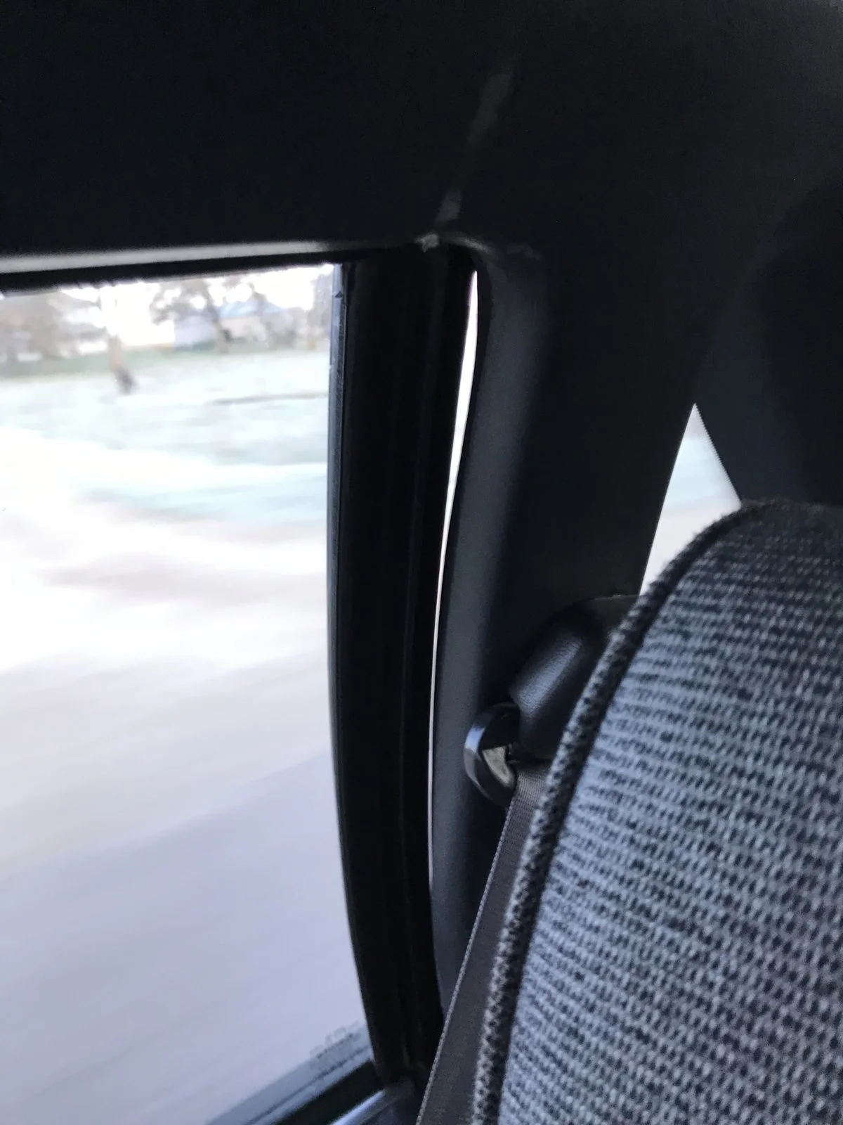

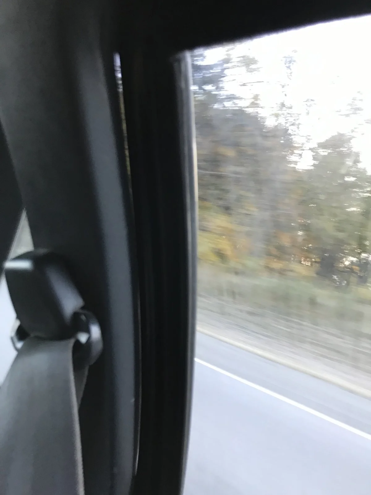

But one new issue came up. I was hearing a decent amount of wind noise, so I finally investigate (while driving down the road). After installing new LMR door and hatch weatherstripping, check out the fit!
Not sure how I didn’t notice before, but I guess it’s because I wasn’t driving it. This bothers me because it’s money spent on a product. Gonna have to hit up Wayne’s thread to remind myself which the best brand ended up being because this is bull poop.

I'm pretty sure that it was the Daniel Carpenter gaskets that turned out the best. I bought mine from LMR, but apparently I got the unmarked Carpenter ones. Wayne said they were the good ones based on the part number. I bought this kit LRS-20708KIT and it came with these seals LRS-20708A. Looking back at Waynes post in his reply to me he indicated that these seals sold by LMR are the DC seals.

Toward the end of Waynes thread someone else posted about having door closure issues. He gives some advice on how to fix the issue, so defiantly look back at his review.
Once and For All.....Door to Body Weather Stripping Shootout
www.stangnet.com
I've seen where the window frames can become bowed over time and you have to kinda bend them back toward the car. Could that be part of the problem?

It could be, I’m not sure. I’ll have to look at it closer over my lunch break. I suppose I could also bend the metal lip that the seal slides onto a bit to give it the correct shape as well. Who would think a 30 year old car would need tweaking when using aftermarket parts...

Those window frames shouldn't be sticking out that much. Something else is going on. Are they bent?
