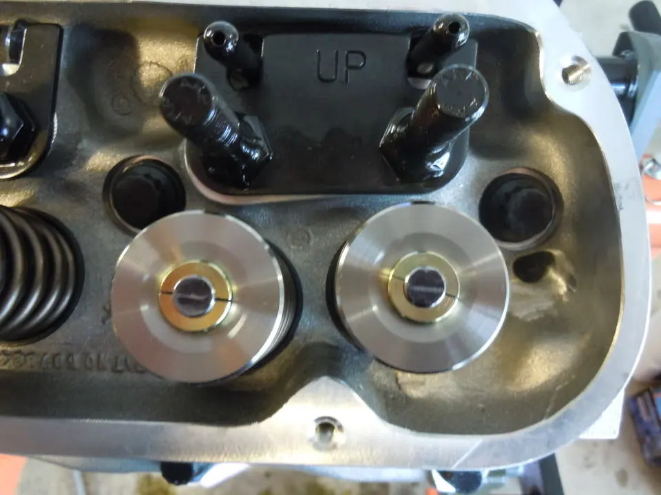

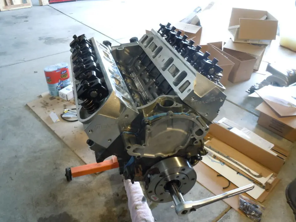

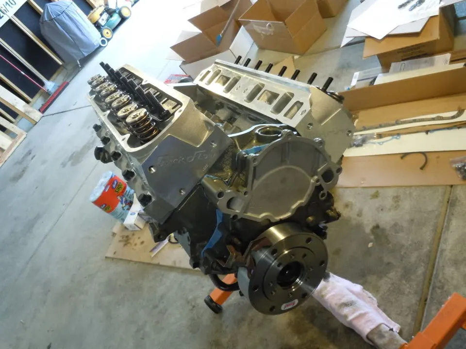

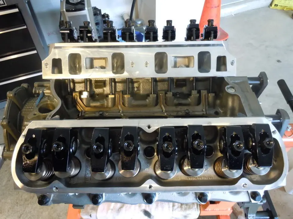

Heads on, pushrod length checked and valvetrain installed! As you can see, the valve stem contact is nice and centered and the line is nice and narrow.
From here on out, it should be relatively smooth sailing, because the rest of the parts just mindlessly bolt on... I'm finally done with checking clearances and what-not. What I need to do before the engine goes in:
Install water pump.
Install intake.
Stab distributor.
Bolt on oil pan.
Bolt up headers.
Install flywheel/clutch.
Bolt on bellhousing.
I also have to figure out how to get the valve covers to fit. They look like they are going to be more trouble than I anticipated... I'll take pictures of that and how I get them to work, if at all!

no head studs ay? are those stretch bolts? FWIW, i noticed those heads have much better attention to detail then myne do. The chamfer on the valve cover bolts and the exhaust ports will make installing things much smoother. My heads have zero chamfer on all of the threads and it makes getting the bolts in a chore sometimes. Especially on the exhaust.
Nah, I didn't go studs, because I figure I'm eventually going to go with a 351 or an aftermarket block, and then I'll use 1/2" studs. These are ARP bolts, though, so they aren't torque-to-yield. They're pretty nice fasteners, but less expensive than studs.
Interesting, thanks for letting me know. I wouldn't have realized otherwise, since I don't know what an OOTB TW head looks like. It's nice to know that T.E.A. went the extra mile on stuff, even if they were really slow to deliver. I do wish they would have provided more specifics on the heads, all I got was an invoice sheet with a very vague itemized list of what was done.

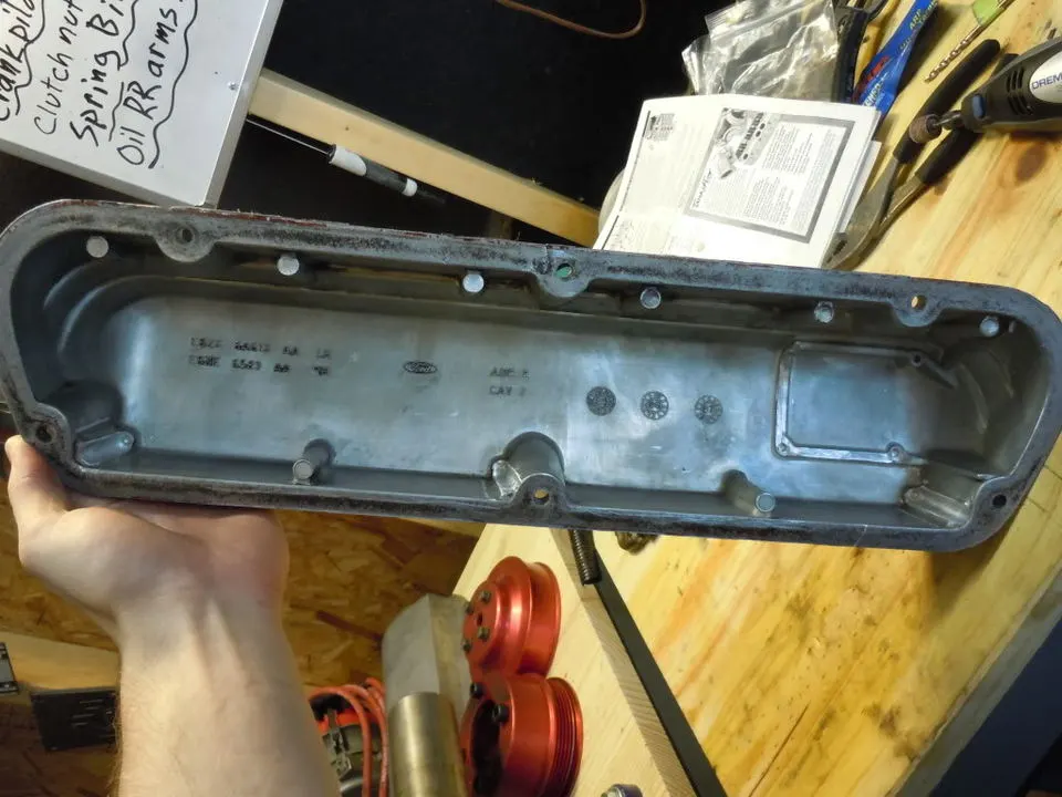

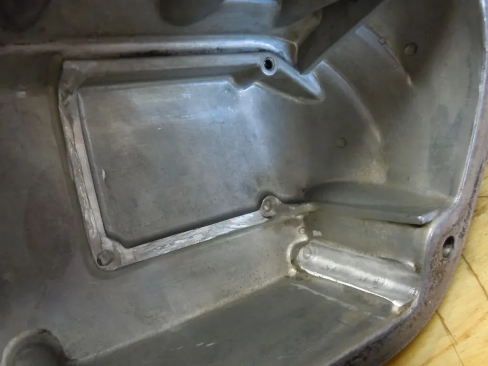

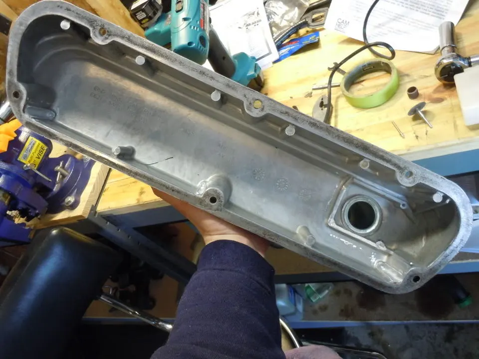

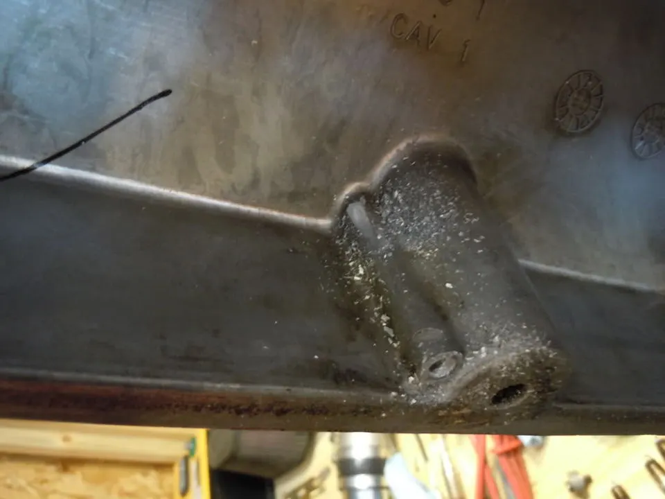

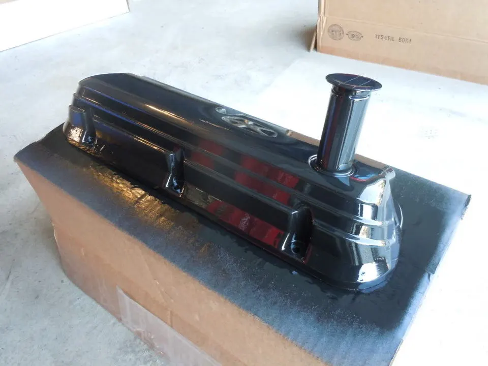

Got a little work done today. Clearanced the valve covers to make them fit over the rocker arms, also cleaned and painted them black. I also painted the "Trick Flow" logo on the intake black. So far, I really like how it all turned out, the completed valve covers actually seem to have plenty of clearance.
I had to remove three of these cylindrical bosses cast into the underside of the valve covers and then grind down the rib that the oil fill baffle sits on, and scrap the baffle completely. I'm going to have to figure out something else for an oil baffle now, but I have a few ideas brewing.
Pics-
Up close of the baffle rib here. I used a cut off wheel on my Dremel tool and just went to town. Obviously, both the passenger side and the driver's side valve covers have the same baffle ribbing, but just the driver's side actually gets the oil fill tube and the stamped steel baffle itself. So, I had to cut the same amount of material off both valve covers.
What I did to get rid of the bosses was to first drill a pilot hole, then use a drill larger than the boss and basically mill it down, using the small hole as a guide for the large drill. I got a little too cautious drilling the pilot hole on this one, and broke through the inside of the casting, which made running the big drill down difficult. The rest of the bosses went pretty easy though.
Painted.

looking good but why stock valve covers?
ya gotta paint that balancer, she's gonna rust
I don't really care for any of the aftermarket valve covers out there. Some of the FRPP ones look OK, but you have to clearance those, too, so why spend the money if you still have to do the work? Besides, I think the stock ones can look really good when they're cleaned up. They have a unique shape to them, and if it aint broke, why fix it?
Styk mentioned that a few pages back. It's the SFI unit, and it has a baked on enamel clear coat. It only looks bare.

I had to do the exact same thing to some stockers to for my rocker arms. Most aftermmarket ones wouldn't clear without being the tall version...which would have hit. Looking good man!
