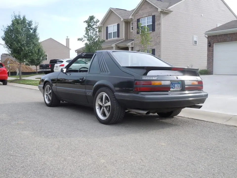

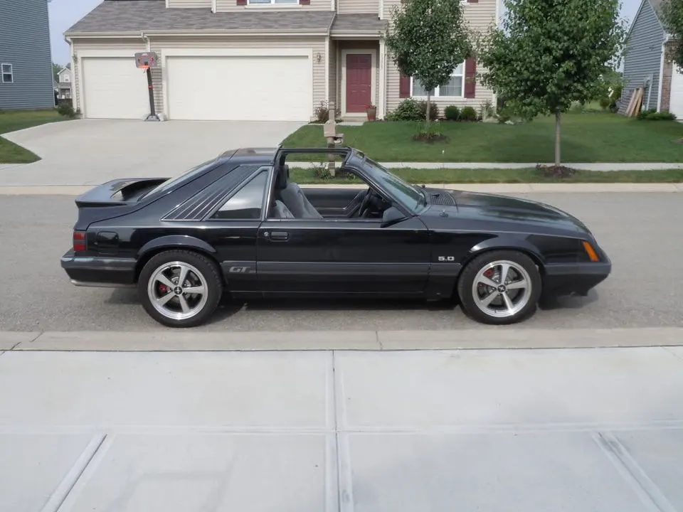

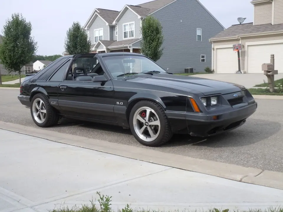

On a lighter note, I do have some new pics of the car. Nothing special, I just took a couple shots at the end of my driveway. Please forgive the 25 year old paint.
