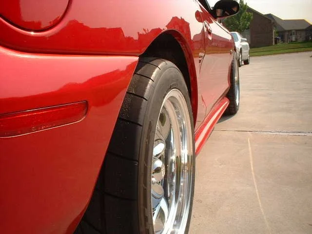

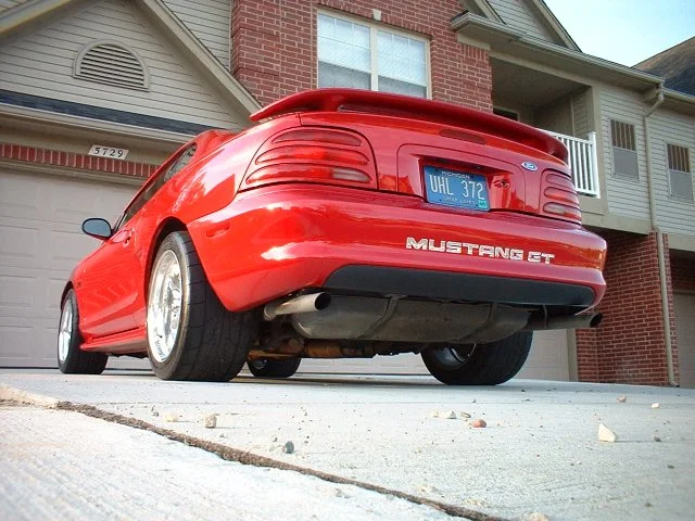

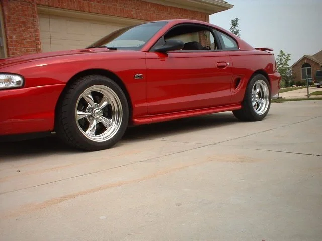

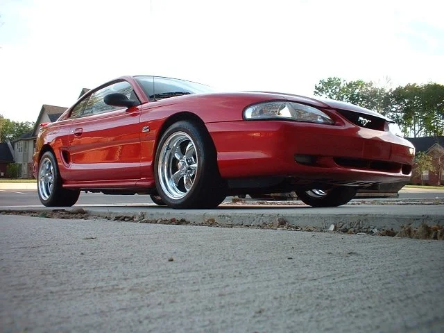

I've got 315/35/17 Nitto 555R's on a 11" wheels and they fit just about perfectly. Putting them on 10.5's will protect the lip a little better than my setup.
And if you want some well-lit pics of 315's here ya go, although I've posted these a bunch of times already. I have 275/40/17's up front, and they rub at full lock, but no biggie. They definitely kill your turning radius though, but at the auto-x & road course they kick major arse!! :nice:

I didn't have to modify ANYTHING in the rear to run 315's other than slightly bending the e-brake cable down a little. Also, the reason I didn't go with 255's up front is because Nitto makes two sizes in the 255 and one is a smaller diameter than the 315, the other is larger. I didn't know how much of a change I could go with in diameter without screwing up the ABS. I know someone had issues when running different diameter tires on their car.
