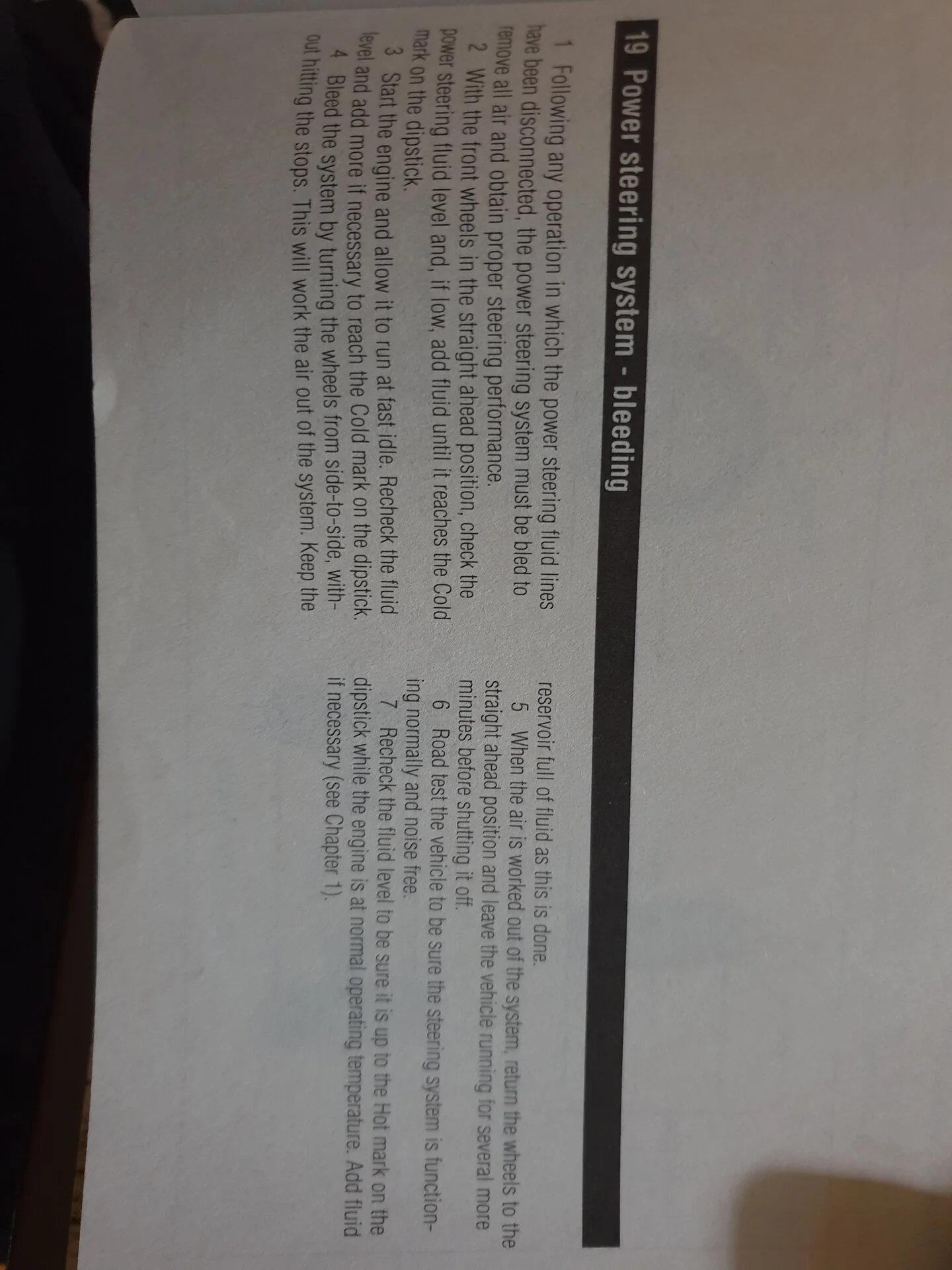

Seems like you blead the power steering correct. I got this from the manual. Sorry, it's sideways.

I don't know how you will bleed your ps system with the car not running except by using a vacuum pump (you may be able to rent or borrow one at the auto parts store) OR remove the belt and spin the pump by hand in the correct direction (this will take some time). The situation you have, unfortunately, is if the new pump is starved for fluid very long, it will burn up. Question: did you put on a new ps reservoir with the pump or use the old? If you used the old, did you ensure all the orifices were open AND all the hoses look in good condition and are not kinked or crushed? The reason I ask is, you may be seeing the reason for the old pump going away---it may have been starved for fluid.
After you are certain the ps fluid has a clear flow path, either bleed the system with a vacuum pump, remove the belt and do it by hand, or go back and bleed the power steering system again with the engine running...note the ^^^^photo in willingham's post^^^^. Sometimes it takes more than once. NOTE: if you are doing it with the engine running, have a friend help you by adding fluid to the ps pump once it starts really moving fluid---it should initially suck the level down pretty quickly--do not let it go dry.
