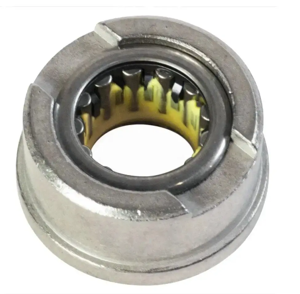

It's out, and I was dumb. Using the puller requires, 1. remove the center & bearing material, and 2. findinging these designed insert slots and ensuring the jaws open firmly into them.

I noticed those slots on the last couple pilot bearing I installed, now I don't have to wonder anymore.

I always wondered wtf they were for. I tried the jaws and a slide hammer once and have used bread ever since which has been less than a dozen times.

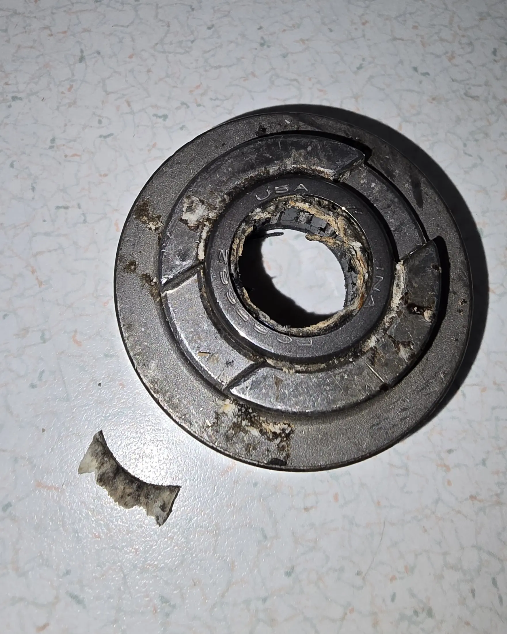

I used white bread on this one last Friday on a 1996 F350 7.5
It's way easier than using grease which I learned on
I put a bunch of crust, and the inside white, it took 3 pieces to get the thing to start coming out, then popped right the hell out with the next wad
You can see the remnants of some bread in the photo
