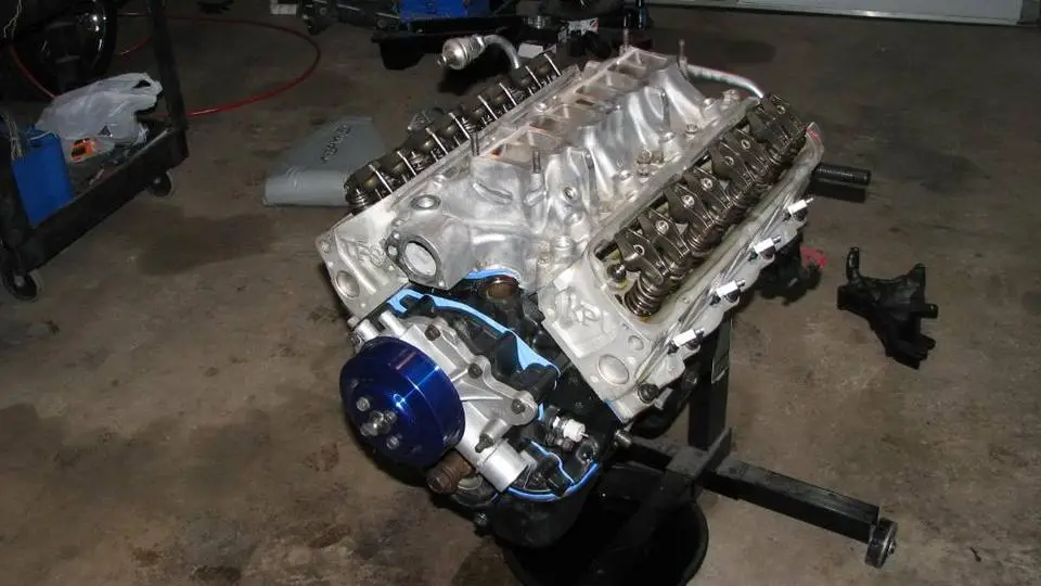

Well... Moved on to welding yesterday... alll those useless little holes.... chris was welding away all day and i was grinding the welds down... we painted over a few and you could see where it was welded and grinded... any advice on covering the bay with body filler will it hold up???
List of the Build:
306 block
keith black flat top pistons(hyper)
wolverine 1190 cam shaft.
10 cut crank.
Stock rods.
Arp rod bolts
TFS KPI street heads (old twisted wedge with inline valves)
3/8 intake spacer
65mm BBK TB
TFS TB elbow
24lb injectors
24lb pro m maf.
FRPP pulley set
comp magnium 1.6 rail type roller rockers
TFS Track heat manifold.
low milage stock t5
low milage ford racing clutch kit.
walbro 190 fuel pump.
all new gaskets
new starter
new rad
new rack
Exhaust:
BBK catted H
BBK shortie headers
Flowmaster 40's
Suspension:
HP blues
Sportlines
other:
New vert top.(yet to be ordered)
New heater core
MM 6 point cage.(yet to be ordered)
Clean up bay:
hide wires
Sand blast
Paint.
how much did the engine work run you, and what kind of numbers are expected?...
Was all done by me and chris except for getting the valves cut and new seals put in which was done by lorenzo's fast flowing cylinder heads in PA which was $300... I asked him what to expect from this combo because he talked these old school heads up quite a bit. he said i should hit 300rwhp easy and anywhere up to about 350 with a good tune. but i dont know if i believe that
I'm pretty sure it'll hold up. But, are you considering using body filler to fill the holes instead of welding? I know welding holes takes forever, but it's the right way to do it..
No just so when we paint the engine bay you cant see a little bump or dimple where the welds are. still are rattle canning it. just making it look as good as possible on a budget.
