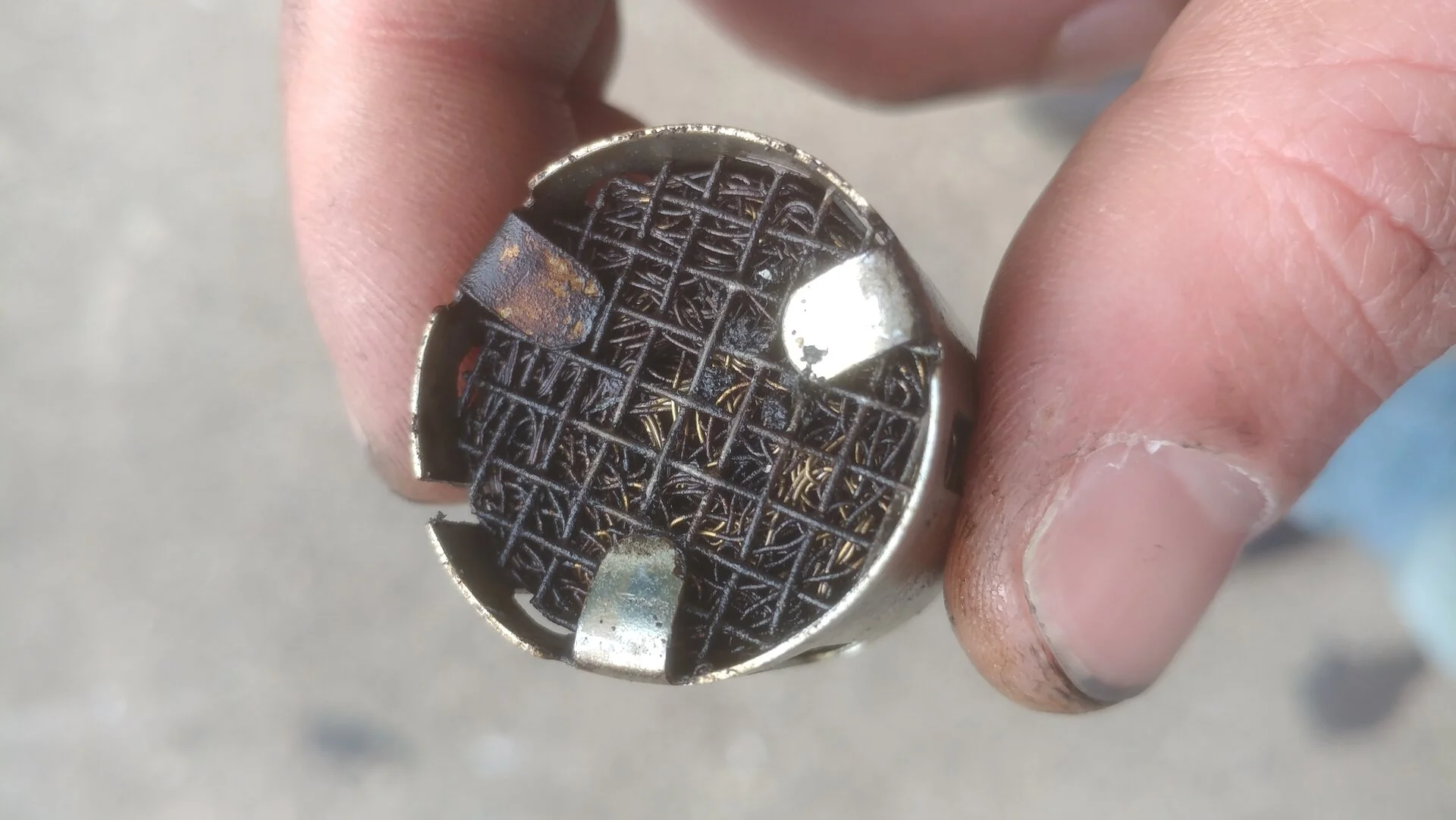

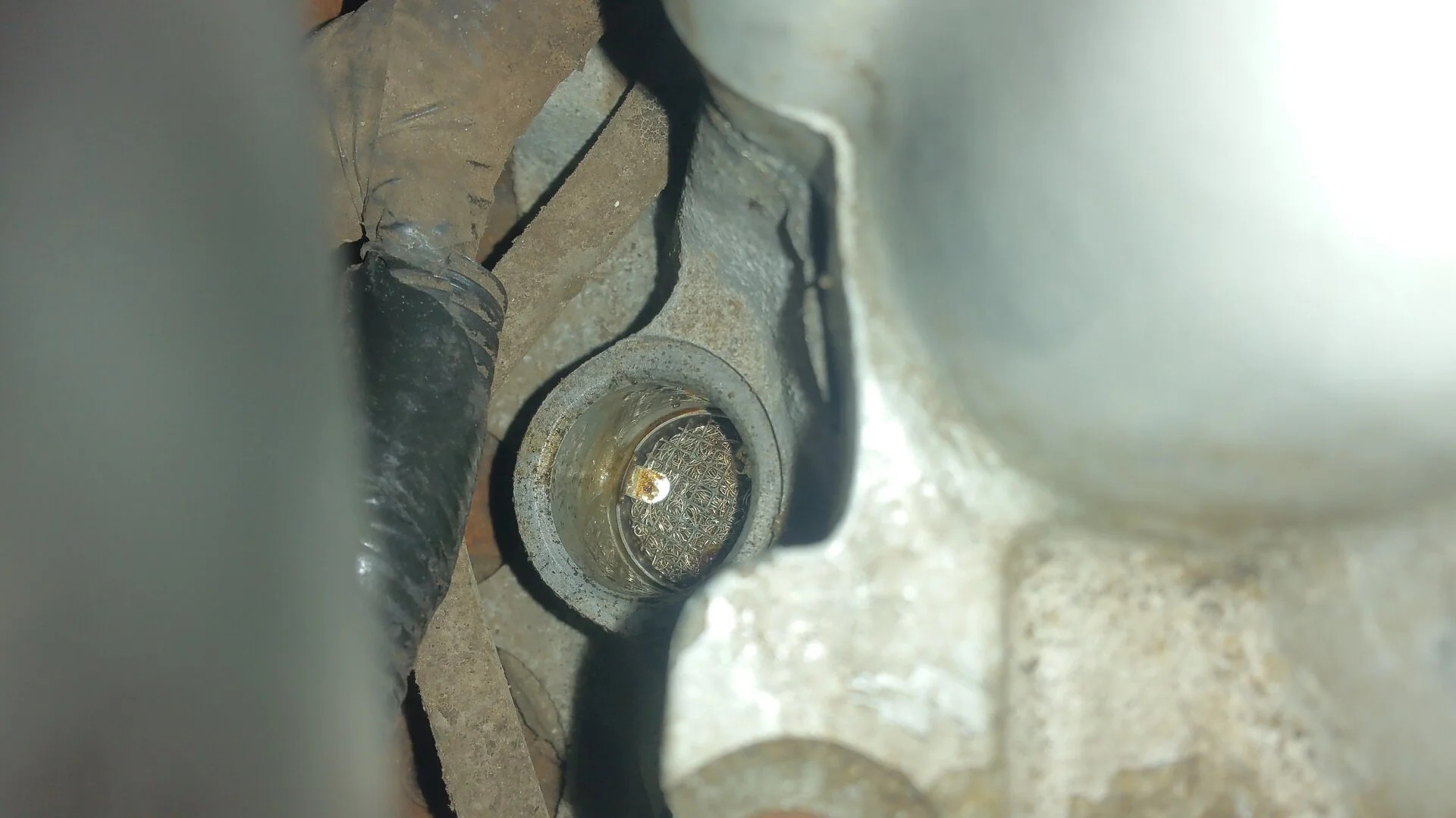

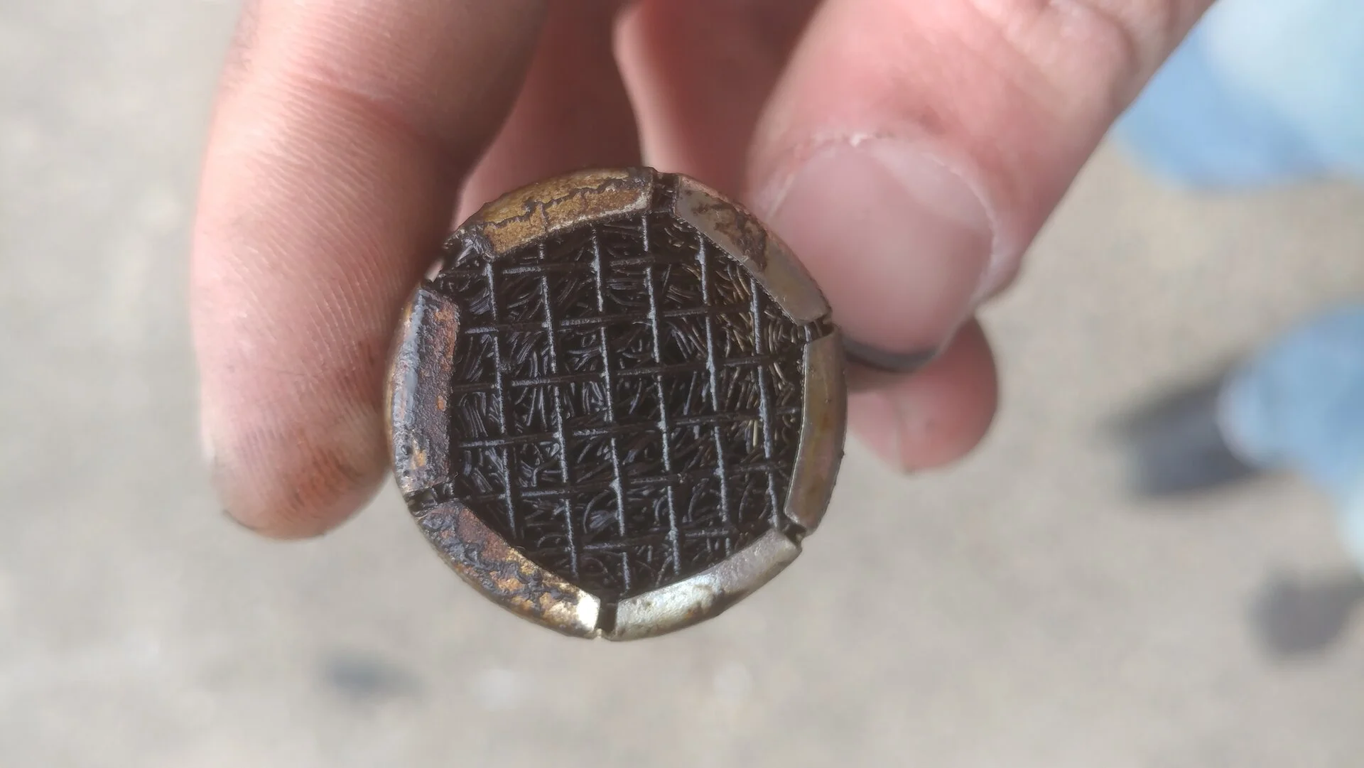

thanks. reading it now. it says removing the grommet can be a real pain. lol, mine comes out really easy. like if I flipped the intake over it would fall out on its own. seems like that's bad.
Edit: I'm pretty sure I don't have a breather filter either. yikes. on a side note, it reminded me I need to replace the filter on my bike...
Edit 2: hmm, i just went out and checked and sure enough, there's a filter in there. Pic attached. just curious, can i tell from the pic if it is installed upside down? is it even possible to install incorrectly?
thanks
