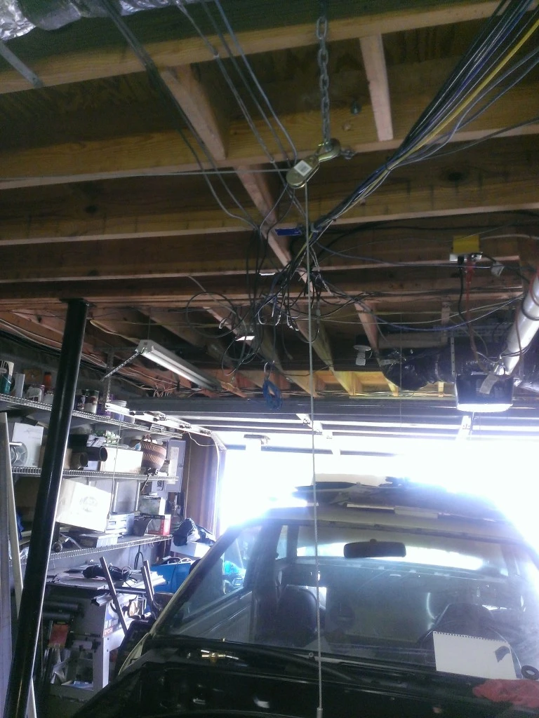

I think I can rig up on my upper core support with some chokers i have laying around. Looks like i need the rocker at the front of the door abot 30" off the ground to clear. Are you of the opinion that this method should not be pursued?

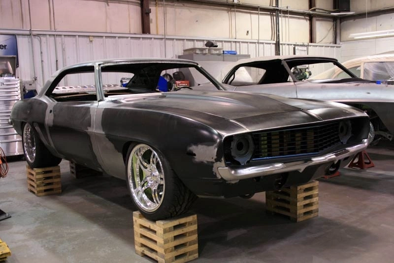

Could you set the rear on a more permanent style wheel crib,same with supporting the front of the body. I know you couldn't place the wheel cribs under the front wheels,but maybe the jacking rails with the cherry picker for support. Then lower the k member out on a trans jack or dolly etc?

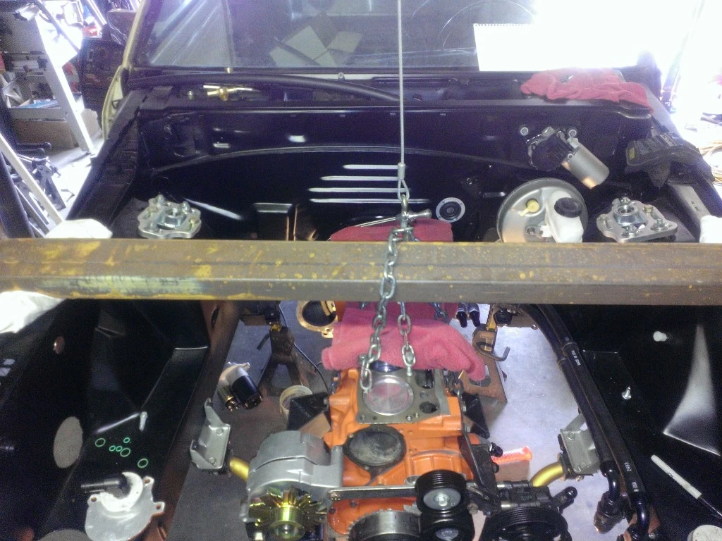

Our cars are super soft in the core support area. I bolted a chain to the bumper shock bolts in the frame then put another chain running straight up to the hoist.
