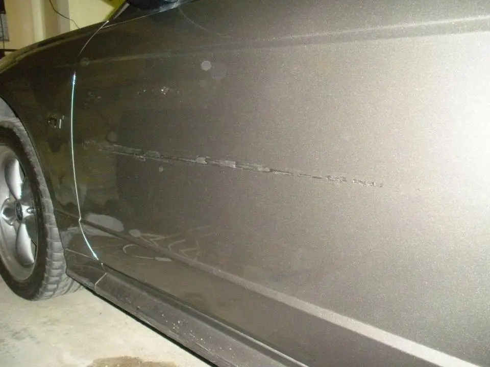

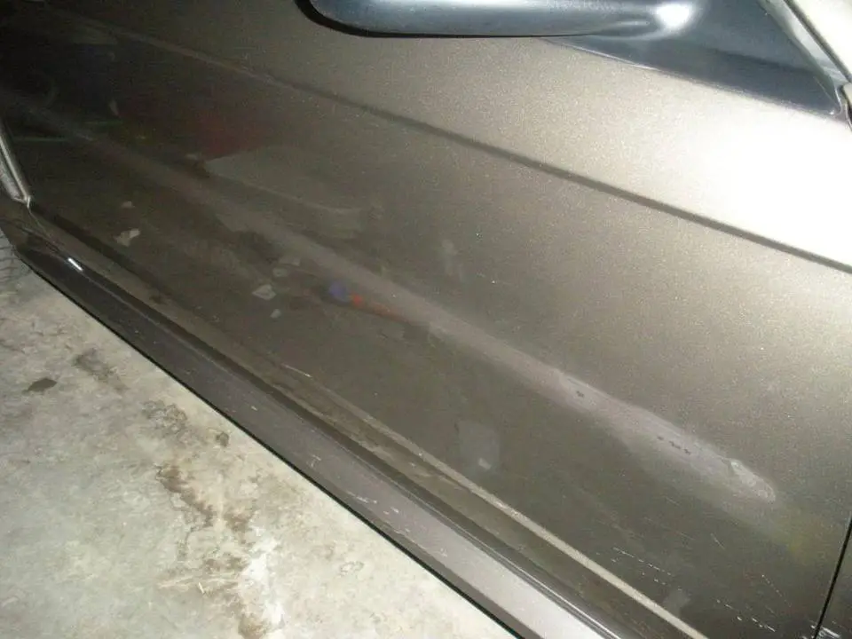

Well I couldn't stand the strip of trim/molding down the middle of my bumper anymore. So I decided to take the heat gun and remove it....BOTH F'in sides got the paint peeled off! It was full of tiny little bubbles in wha looks like the factory paint underneath and it just pulled strips of paint off! The car only has 52k on it! Would this be something covered under a corrosion warranty?! It's like the paint was not even adhered to the surface properly! Now what do I do? It looks horrible!

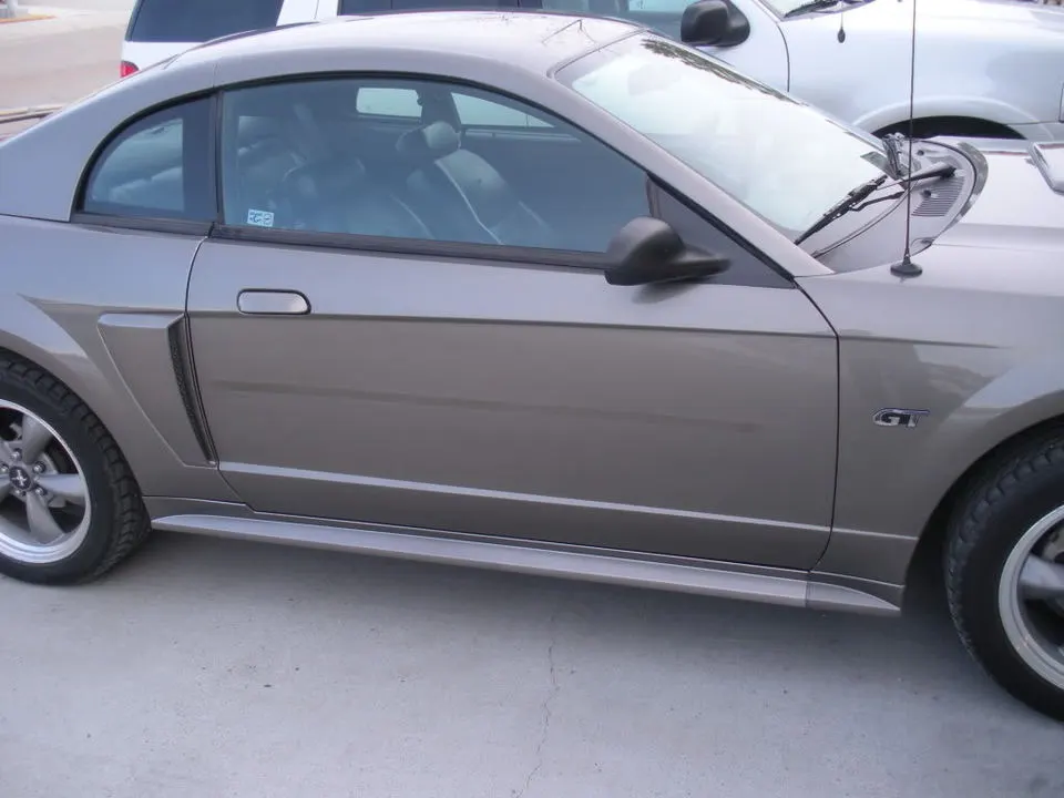

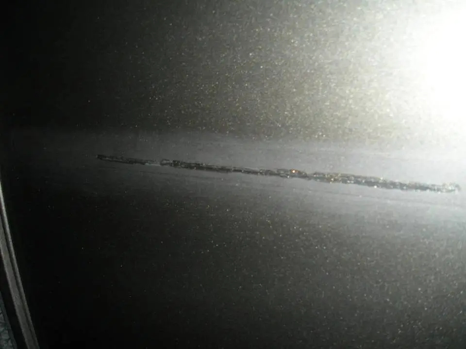

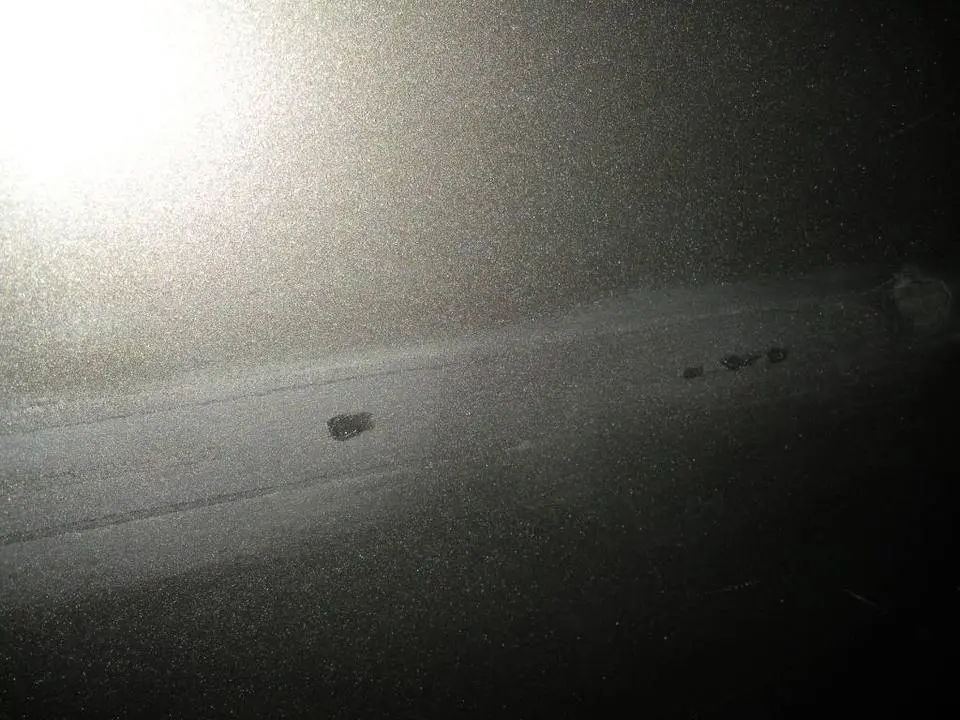

Ok I am in the process of repainting it now. Not sure how it's going to turn out. The paint matches color wise it seems. I am having to repaint the entire patch where the trim was because of the color matching issues. But here are some before pics....

Ok I finished one side and it doesn't look to bad actually. But I do have a fine line where the old paint meets the new. Can someone give me the details on blending it? Should I simply tape a small amount above and below the line leaving some old paint showing and respray the clear to blend it or what? You can for sure tell a tape line was there.

these things happen, no biggie. However you WILL be having it blended and paint matched at a body shop. There is just no way to match that right now. Did you wet sand the whole door with 1500 grit? if not, try that. Wet sand the door so that it is completely dulled, making sure to only sand off clear coat(it should be milky looking as your sanding) also be carefull as Ford did not use alot of clear coat on these cars. Once done with that buff it out with rubbing compound using an orbital buffer. That will get you the best results. Based on your pictures you will still have a visible blemish though. For a shop to blend that correctly they will add color to the door and blend clear into the fender and rear quarter. Because the molding stretched the lenghth of the door it will be tough to color match and blend just on the door without going into the fender and quarter. You can save money by prepping the car yourself before bringing it to the shop, remove door handles, locks, moldings etc and that will save them labor time and you money. You dont need any body work so you should only be looking at 3-400 bucks. Hows Alaska? I lived in Kodiak from 05-08, loved it!
