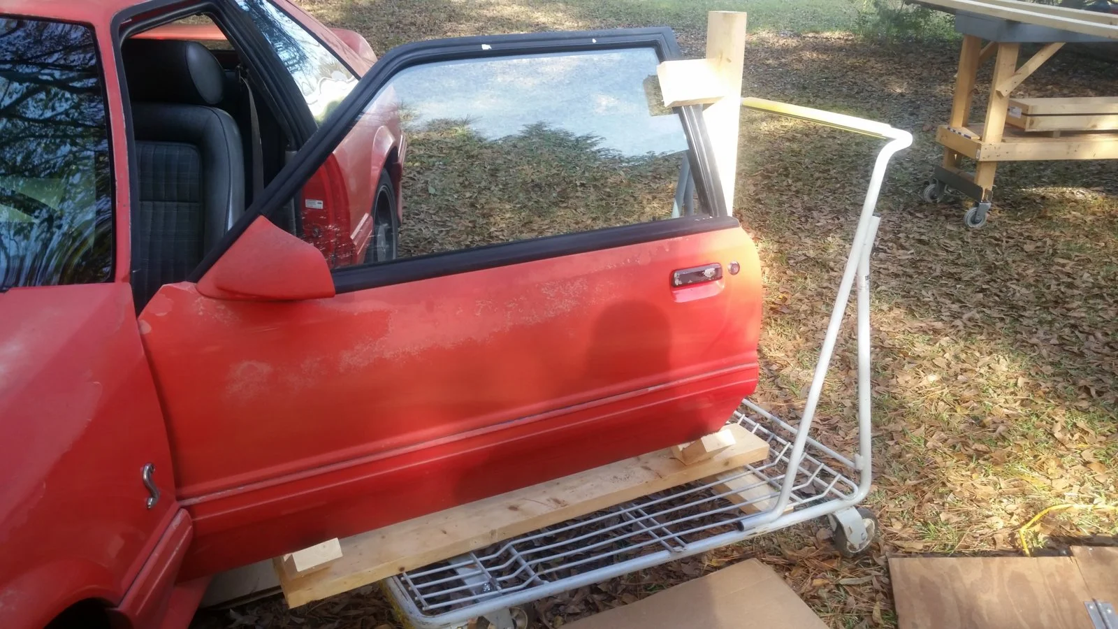

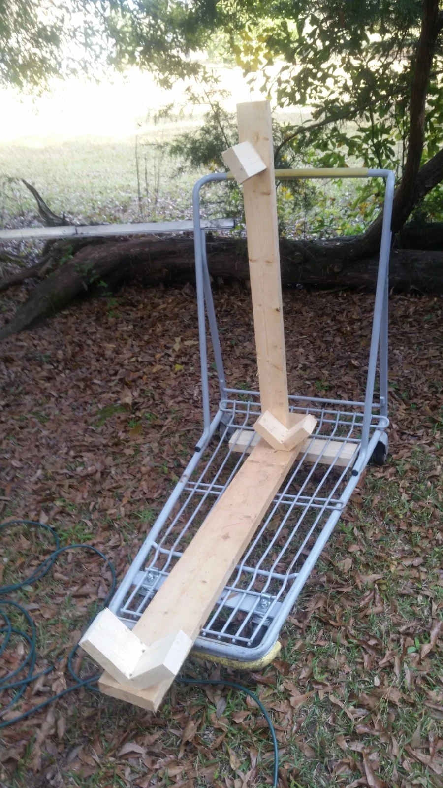

For bonus credit here are some pictures of a jig I made a while back for replacing door pins/bushings etc when working alone. I don't ever seem to be able to find anyone to help when I need it. My bushings were fine but I needed to replace the roller and spring that holds the door open. While I was there I went ahead and replaced all the bushings just to be sure they were all perfect for the upcoming test. And now for the jig construction. I took a single 2x6 and laid it flat. Then cut a 2x4 into 4 short pieces and made a V out of them to sit the bottom edge of the door in. After that I stood one 2x4 up vertically and screwed it in. I put a block on this piece once in place and barely rested it on the upper door frame. Once in line, it got screwed in as well. This piece had a soft cord wrapped around it and the upper door frame and that held the door straight up once it was not attached to the car. In the pic, the window is up but it was rolled down when I used it. I also placed shop towels under the door where they touched just to cushion it against the wood. I place all of this on a flat cart and secured it with a bottom "sandwich" block attached with screws. It worked perfectly. Here are a couple pics.

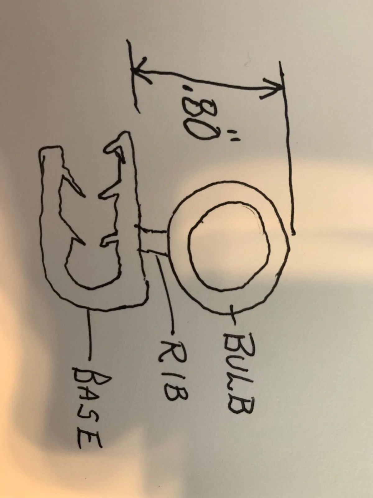

I'm following your thread waiting on results. My Mustang is sitting in the shop with trim and door seals removed. The seals I just purchased from 1A Auto aren't good. Door won't close properly. Compressed thickness is too great for the available door gaps. Mostly due to a rib connecting the bulb to the base.
That rib really shouldn't be there. The bulb should be fused directly to the flange channel. I'm on my last product test.
Do you have pictures of the seal end view or profile showing bulb thickness and height and if there is a rib between the bulb and clamp. I'm about to the point of ordering the expensive Ford seals but wanted to look at the shape of the lower cost seals first.
