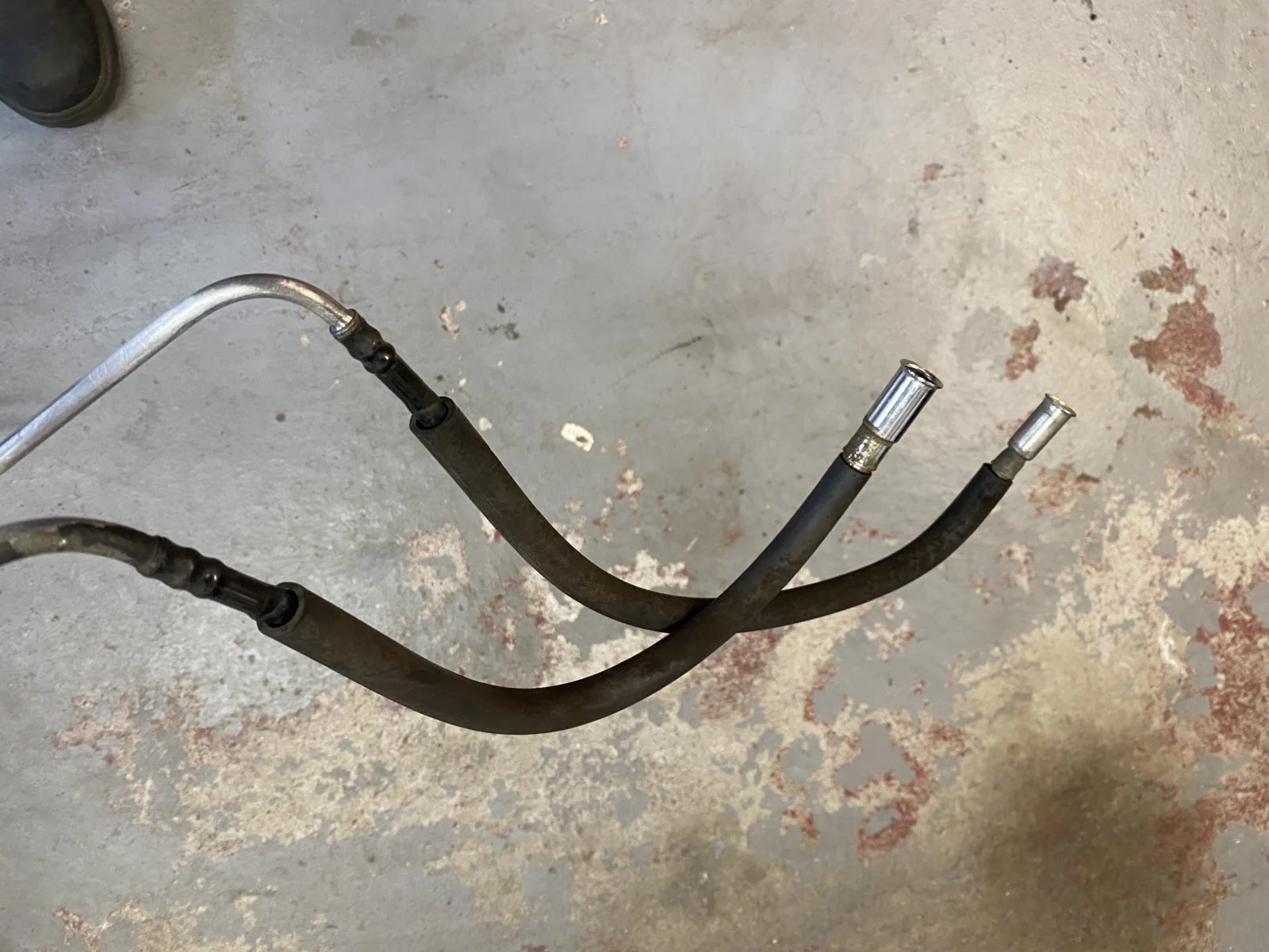

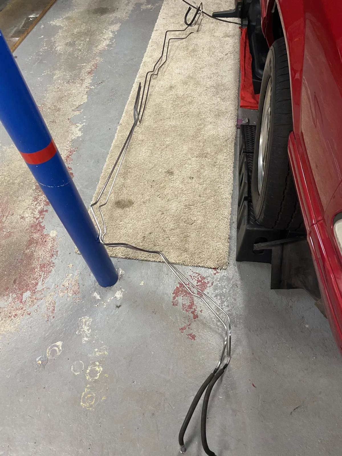

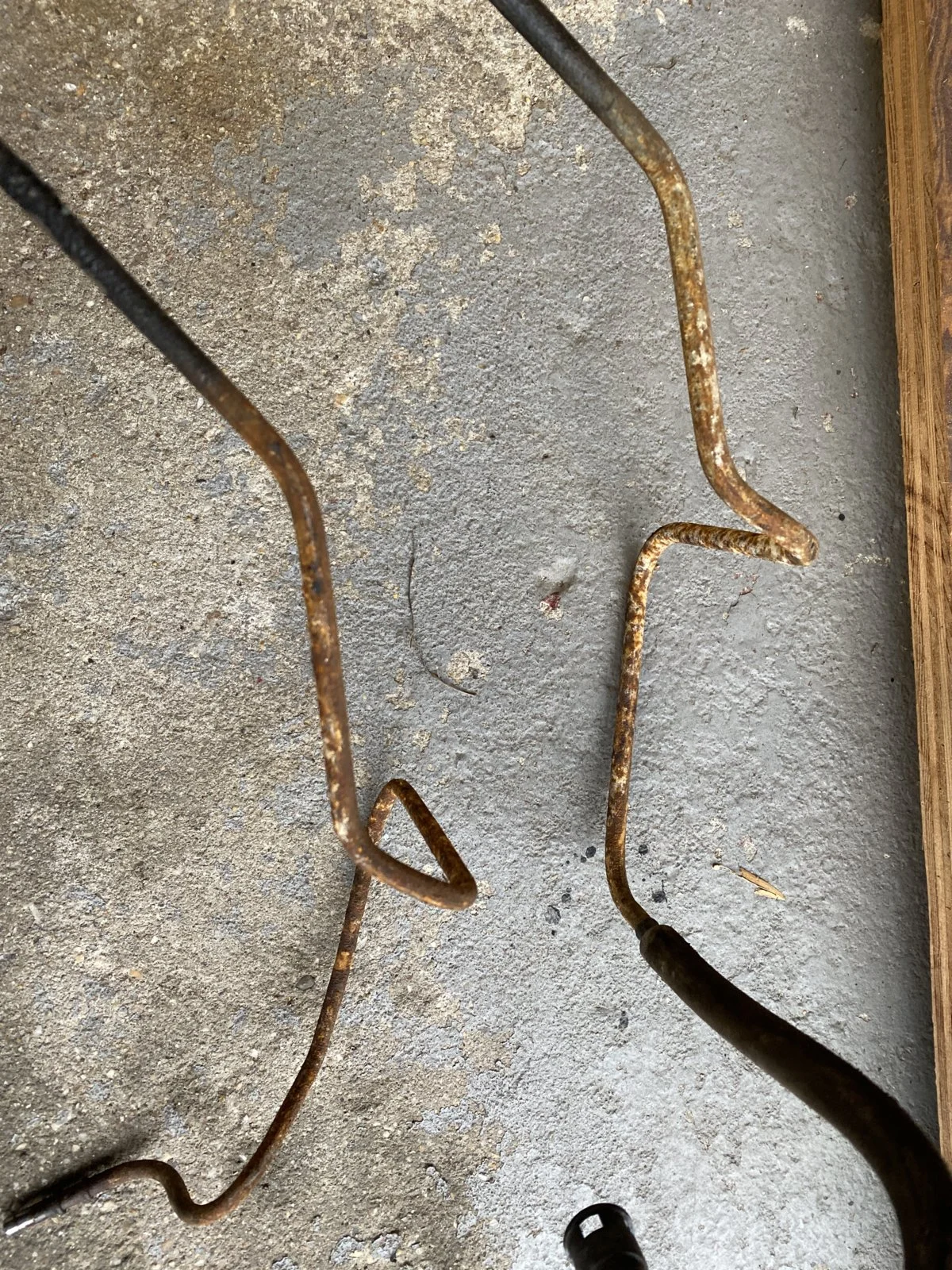

In my attempt to save me some money, I started working on the rusted part of these fuel lines. Here is a pic of the before, and where I’ve gotten it so far. I guess my question is whether they’re still safe to run? They still feel real strong where the rust was, with no signs of weakness anywhere.
If they’re good, I’d rather spend the few hours cleaning them up, than the $400 plus for a new set.

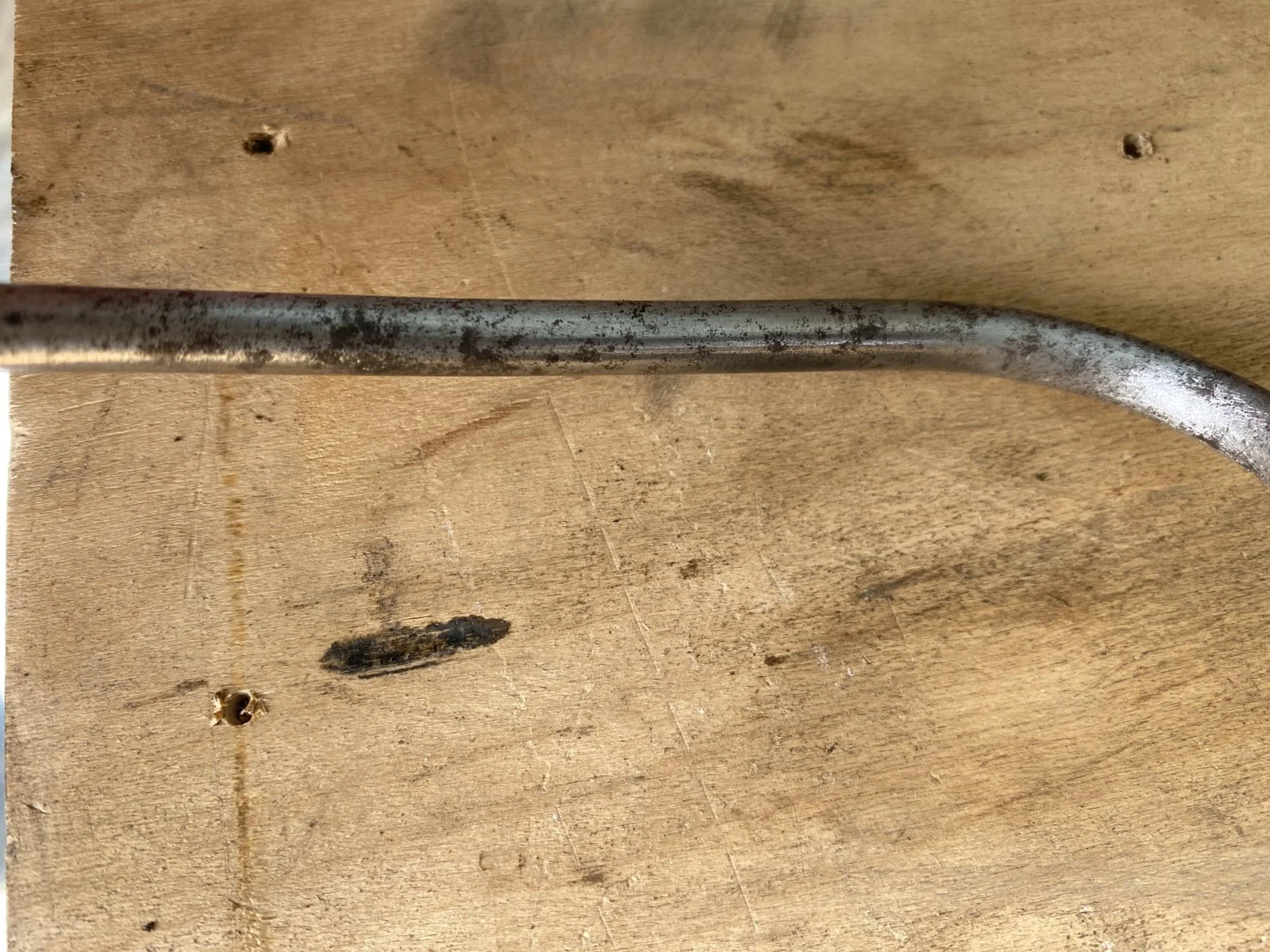

Try cleaning up a small section (one of the worst areas) and see what you are left with. If it's smooth and defect free, send it. If you see pits, I would get new ones. Hard to say how thin the metal is in the area of the pit and if that leads to a failure later on in that spot.
Here is where the worst of it was. Very smooth, maybe a few little “indents”

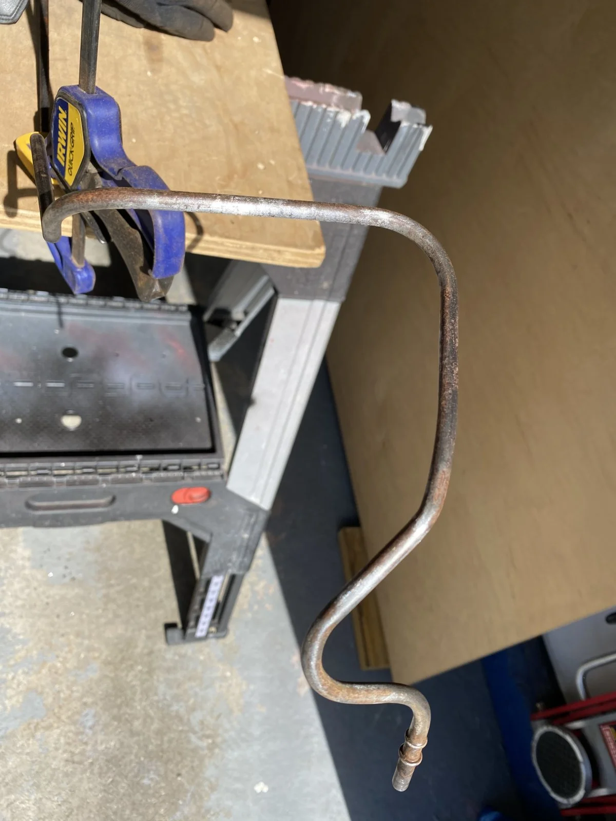

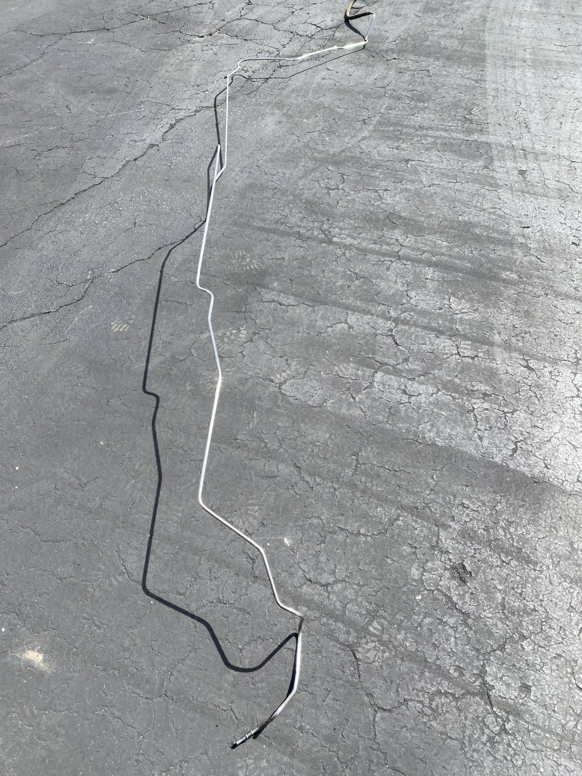

The rest cleaned up very easy, and shining like new.
I think I’ll do the supply line next and then make my decision.
And next question is.... are just these plastic/ rubber ends of the hard lines available? All I see the ones for the other end that connect to fuel tank.

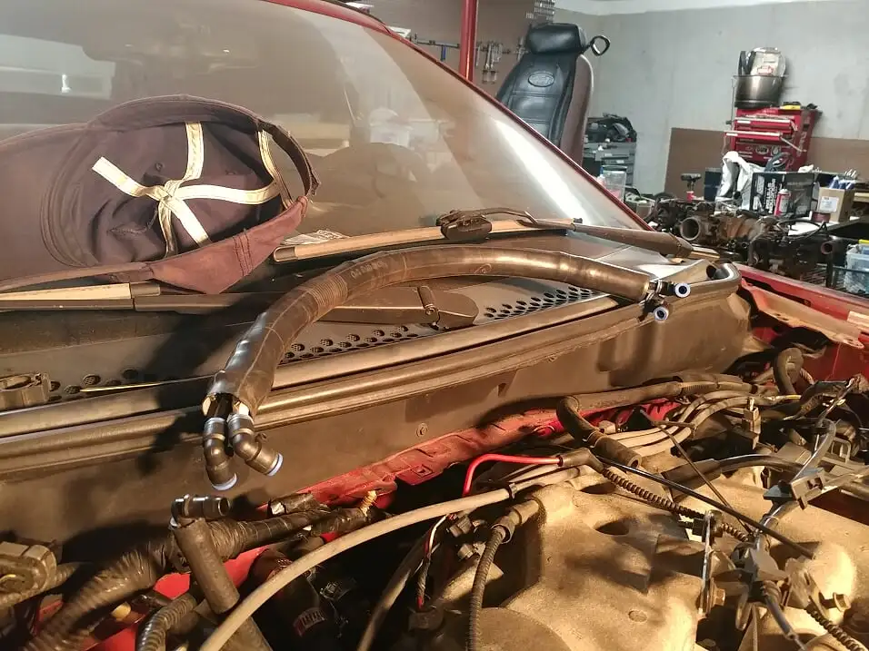

Since those are not the ones that connect to the fuel tank. I am assuming that they are the ones that will go to the fuel rail. I just swapped engines and had to make my own and was going to use the doorman connectors that would allow me to use the Nylon and slide a rubber hose over them, but in the end I used standard rubber fuel line and the quick connectors.

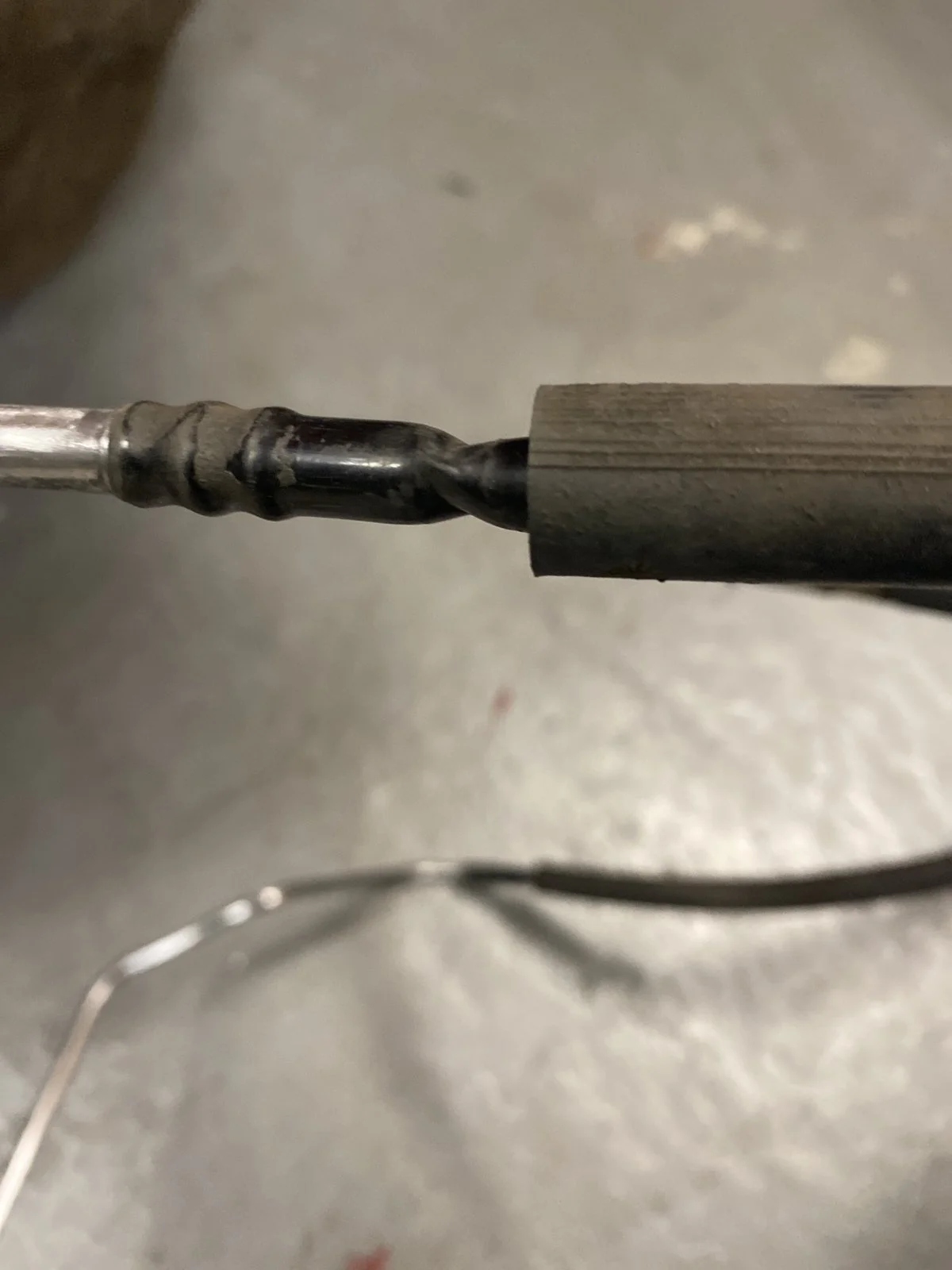

I need the hose, which I have found is not an issue. My issue will be getting the hose back onto the barbs of the line and the fitting. As you can see in the pic, it was kinked pretty good. I had no intention of reusing, so I wasn’t exactly careful getting them out.
I’m open to suggestions on other solutions.
Cut the steel, compression to braid up to the rail?
I would agree with the AN fittings if possible over my next suggestion.
  1. Cut the end where it is crimped and make sure that the opening is flared out to at least the original diameter.
  2. Get some PB blaster for lube and shove the rubber hose back and over the barb then clamp with a hose clamp
    1. or you can heat the hose so it is more pliable and push it over if you don't like to use lubricants with fuel lines.
I even have a friend who went as far to put heat shrink around his connections to ensure they were not going to leak, obviously he did this before he put them back on the car though.
I’ve seen some people put new nylon line on by placing it in boiling water, then over the barb. I may try that. If it doesn’t work, I’ll be back where I started, bite the bullet, and buy new lines.

DO NOT use the Doorman push in quick connect, it is black and has blue ends, they will leak on you every time.
This was my first attempt to make the lines, here I was using the 90 degree and every time I turned the key the pressure line spewed. I took this all apart and then tried to make it with the barbs instead of the doorman quick connect. The damn nylon is difficult to work with and it will hurt you hands. For now I am using regular rubber fuel line but will make the lines with nylon when I can get the chance. I needed to car to run now over sitting so the rubber was a quick fix

I am trying to make sure that the nylon is protected under the hood from heat and general dings and debris. That is why I was trying to make sure I can get a rubber hose over the top of the nylon line. To me just having the bare nylon is not enough for a safety or longevity reason. I also know that just running the rubber line like I have now is also not the long term solution. Luckily, you are just going back to the factory location on yours. I am running my across the rear of the firewall because the fuel rail that I am now using is on the opposite side of the engine bay. So, I need to not only add distance but need to safely make a U bend in the line so that it wont crimp and cause me delivery issues.
