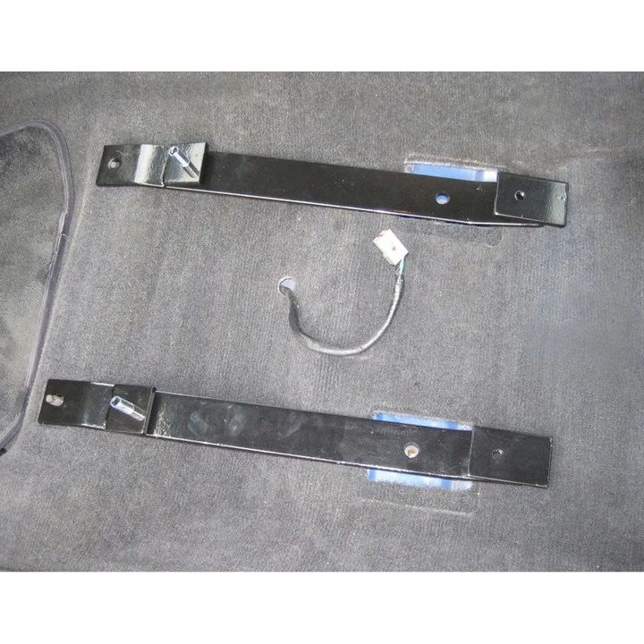

What did you do to modify the bracket? I assume you cut a section of the "legs" out and welded them back together? How much can be removed?
Yeah, that's pretty much what I did. It was a year or so ago, but I think I cut about 1-1/4" out up front and tapered it down to about 1/2" by the time I got to the rear. Helped straighten the seat up a fair bit....as well as keep my knees out of the steering wheel.
The plan this year is to get rid of the CJ seat extensions altogether and make up my own lower profile design.
If I'm still not happy, I'll cut a little more out of the seat brackets until they're dragging on the floor if I have to. Barring that, I'll cut a section out of the front section of cross frame that the front of the seat mounts to and drop it an inch.
