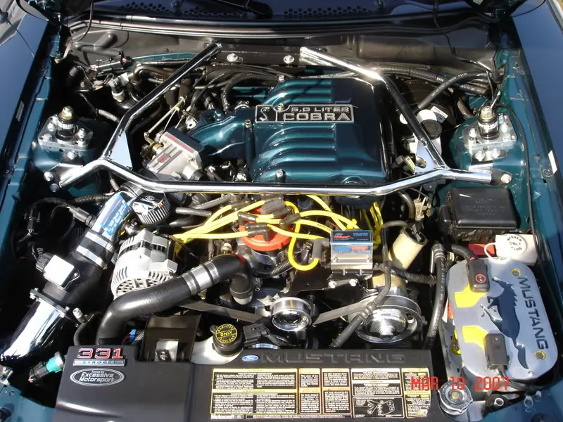

I have the yellow top, unfortunatly I don't have the part number with me. I did take out the factory battery tray and installed a Optima specific billet one I got off EBay to hold it down. I could check my receipts when I get home if you needed...

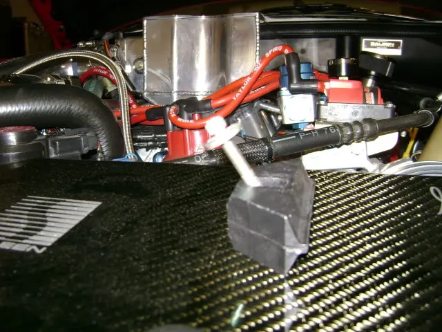

I will look tonight and tell you what red top I use. It is a little narrow so you need
one of these, they are off a 90's Corvette. I will find out for sure what year. Get them for under $10 from the chevy dealer and they hold a Optima down perfect in the stock tray.
My buddy has a shop that does only Mustangs and Corvette's. He found that these work perfect for the mustangs!!
