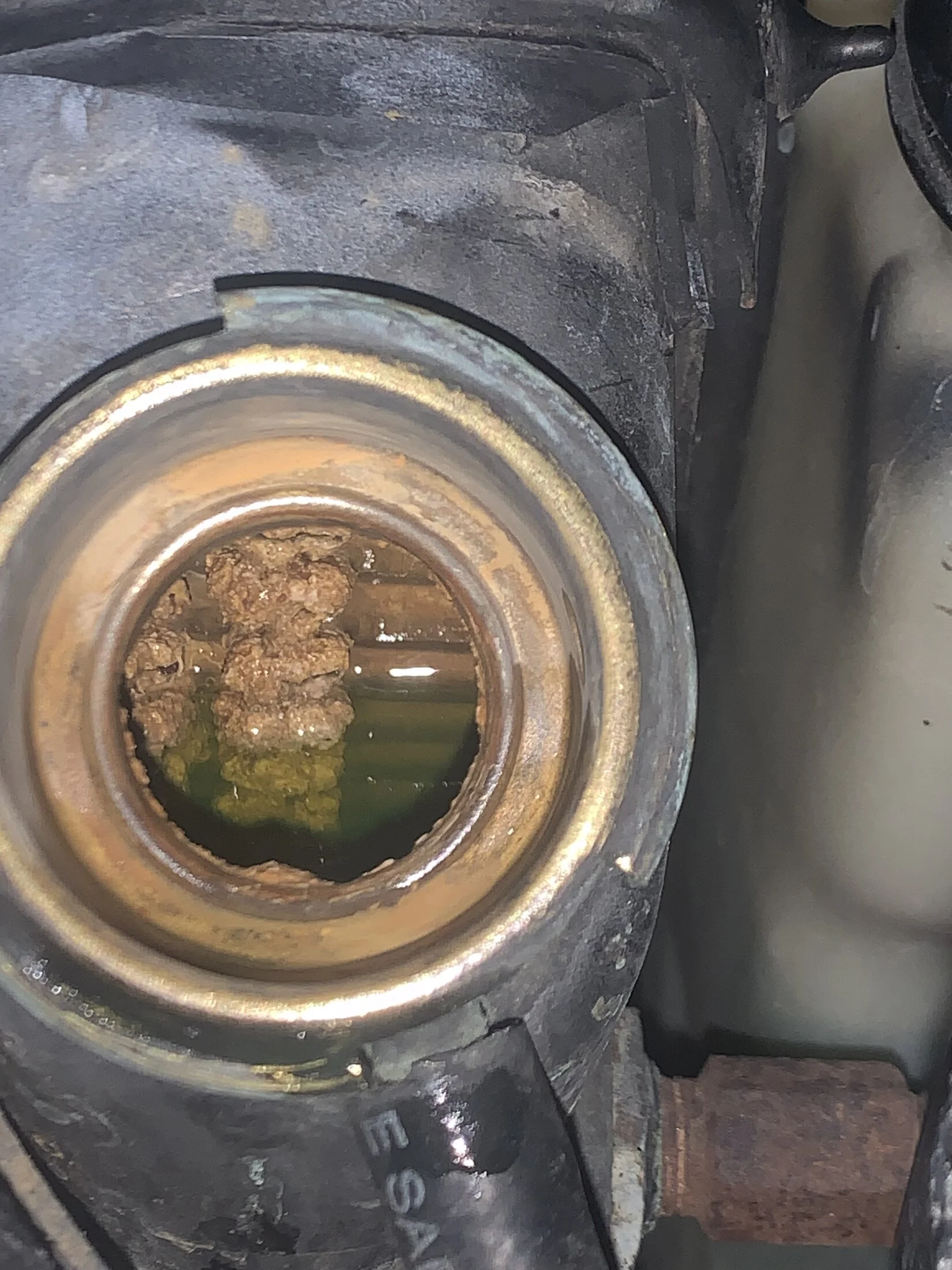

my 1993 Mustang these last days after 10-15 minutes the temperature begin to rise, normally stay below half
The fan clutch was changed when buy it because was overheating
And the I think the thermostat is opening
I took this picture inside the rad that’s don’t look normal

The tubes are probably clogging with calcium deposits.
I'd be tempted to pull the radiator out, fill it with vinegar and let it sit and see if it can clear some of that up. But if it doesn't, you might want to consider a new radiator. Flow and heat transfer can be affected by that.
It would be worth a try, but it looks like faucet water was used in the cooling system.. Take it to an old school radiator shop and get it rodded out...

I'd expect a good radiator shop isnt cheap these days. Even though the core tubes could possibly be cleared, with an old core there are likely other weak points. I'd be going directly to a new replacement in this case,
Personally I would rather try the "rod out' or even a new core ( if its a quality shop) than some of the new garbage being sold that doesnt fit right...

I drove 30 miles to the only good " old school" one I could find... Charged me $210 to pressure check my radiator and condenser.. They cleaned and painted them too...
Yeah old school shops like that aren't common around here. Major metro area...everyone is just buying new cars and throwing new parts at them. Nobody repairs and it's rare to see a vehicle beyond 15 years old on the road because the salt eats them out. Not enough business for those old school shops here.
