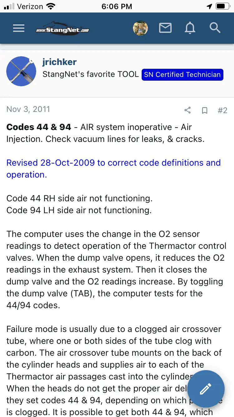

Major Edit. I checked the wrong tread for verification! Fixed to delete poor info on codes 94 and 44.
@Mustang5L5
Code 80/81 are the codes for the TAD/TAB if you unplug them. A 75ohm resistor will “fool” the ECU into thinking they are working and you won’t get these codes during the KOEO test.
Code 91/41 are KOER codes that are detected when the engine is running. The smog pump diverts air to the heads and the o2 sensors will detect the change.
You can have the code 91/41 or only one without getting the corresponding 80/81. In other words one tests the solenoids, and the other is a passive test by detecting a subtle change in sensor performance.
I’m currently using resistors to get rid of my 80/81, but I’ll forever have the 91/41. Considering most states aren’t doing a code check, or sniffer test. It’s strictly a visual and you shouldn’t have an issue. As for killing the cats, like I said this only functions during warmup. You probably spend 99% of your time driving with the system disabled anyway. Just ensure a good state of tune and keep the smog pump flowing to the primary cats. get your car nice and hot on your drives and it shouldn’t be an issue.
