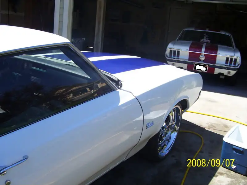

i've used there paints before. They are pretty easy to spary. Dont know how it will hold up though. for pics..http://www.stangnet.com/mustang-forums/827698-finally-finished-paint.html
this is a base coat clear system
this was a single stage paint job:
all cars were done in the garage.
