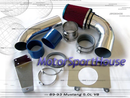

J jstang209 20+ Year Stangneter Jun 3, 2004 640 2 18 Stockton 209 Oct 16, 2005 #11 Oct 16, 2005 #11 i help u out! maf View attachment 500374 cai Attachments CAI8993MustangV8.webp 49.5 KB · Views: 179
T tx2000gt New Member May 27, 2005 222 0 0 Oct 16, 2005 #12 Oct 16, 2005 #12 Alright, cool, I get it now.
